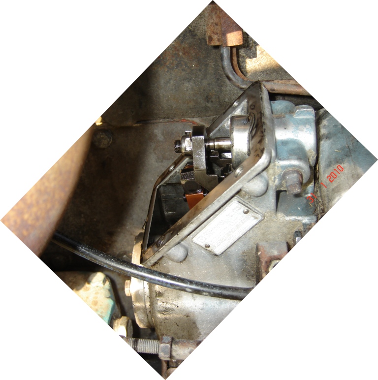

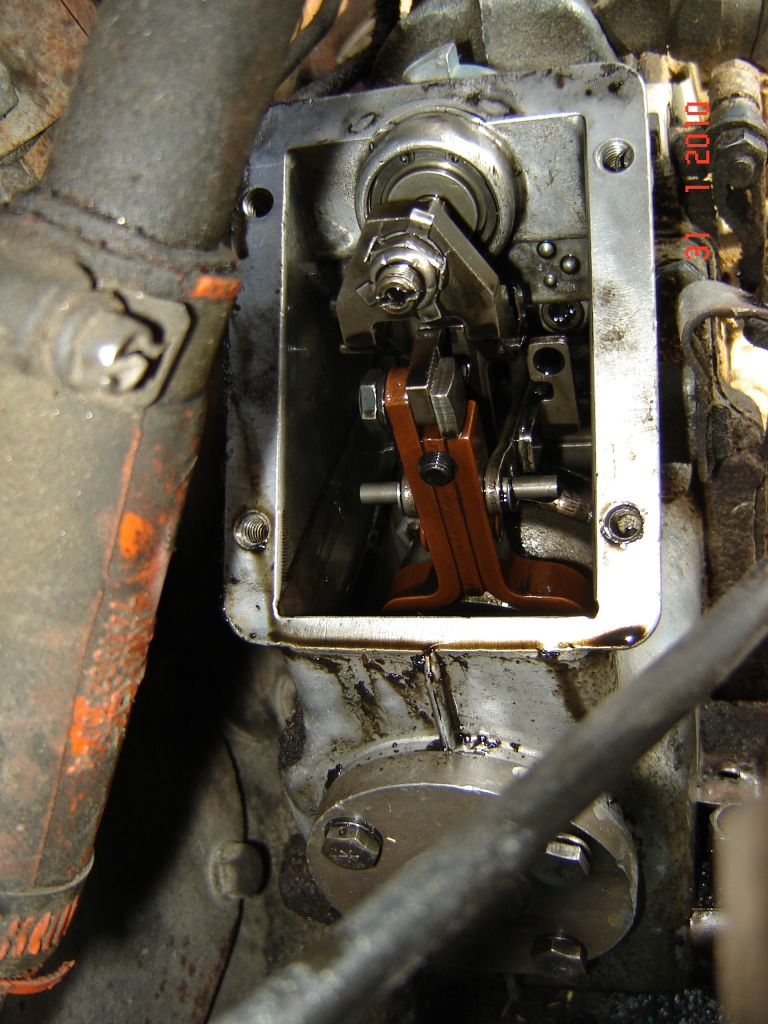

pics please lid off! Make sure were on the same page!
there should be a 9/16 sized nut under the cover loosen it and turn the allen screw counter clock wise one turn put the lid on and try it! Its been years since I messed with these so bare with me!If that makes the problem worst go the other way on the allen screw 2 turns!

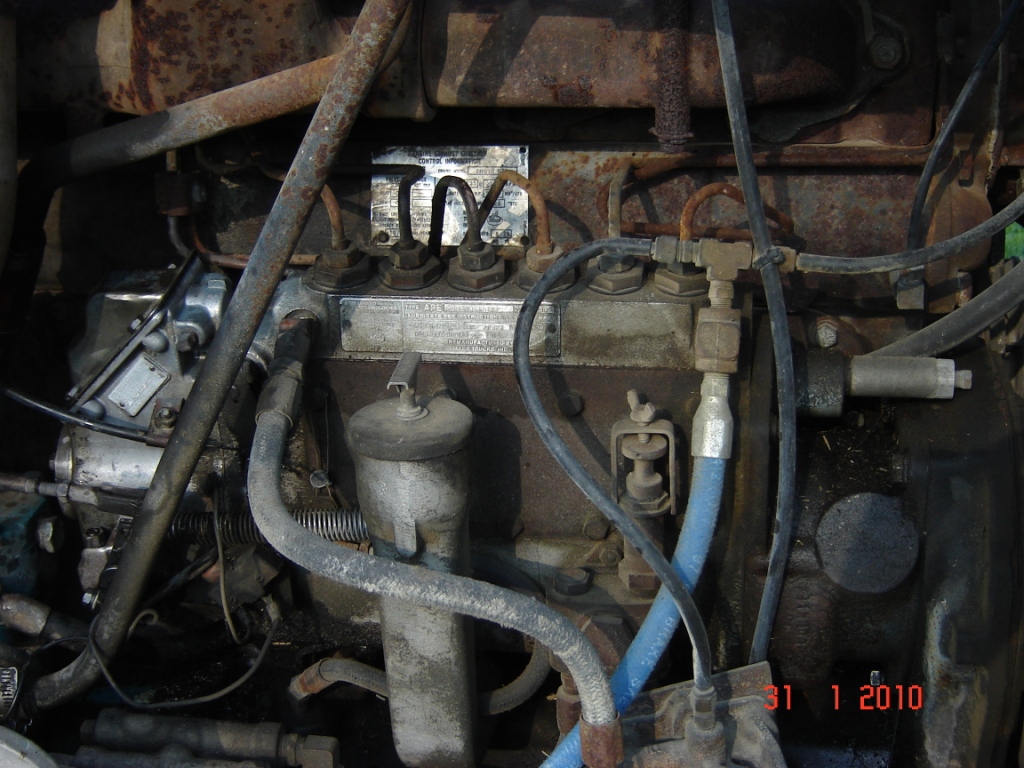

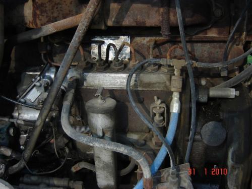

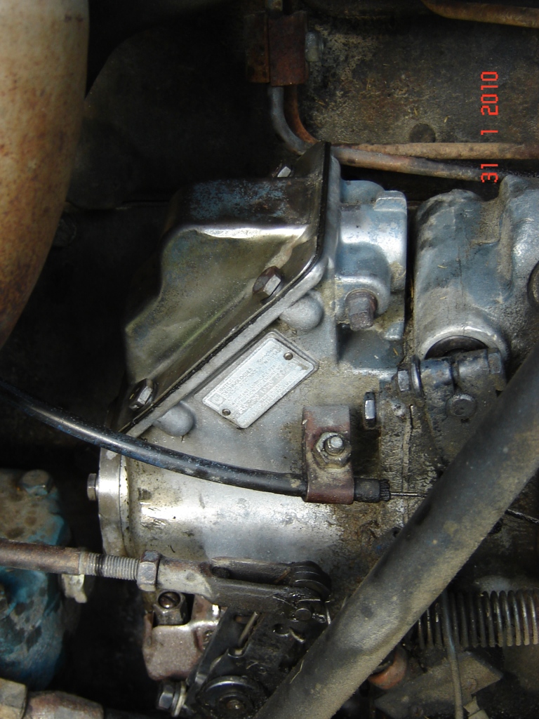

Ok, here are the promised pictures of the injection pump. And thanks Ron for the suggestion about the short fuel lines. I was kinda thinking that could be a problem spot, so your advice will make me get it done.post-6533-081783900 1280421344_thumb.jpgpost-6533-070747600 1280421391_thumb.jpgpost-6533-033103600 1280421438_thumb.jpgpost-6533-091749200 1280421476_thumb.jpg

[/quote
]The nut is a jam nut!You want the steel block behind the jam nut to move to the front of the truck loosen the jam nut and turn the screw so the block moves forward! count the turns do it one turn at a time to acheive the desired set! I'm doing this from vague memory so if itgeets less power you need to go back the other way!:pat: Let us know how it goes!
