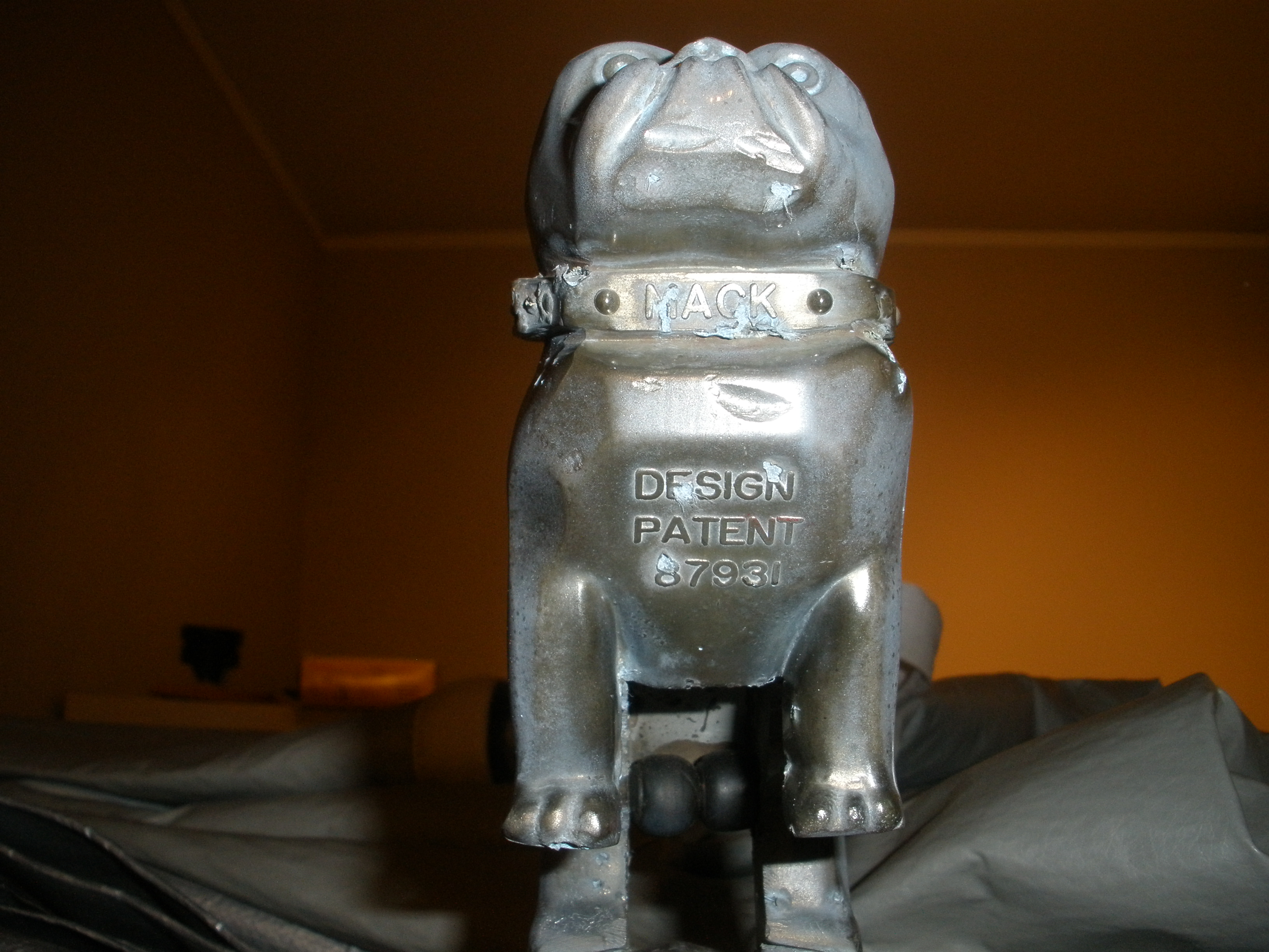

Hey Jocko.....is yor dawg Man or Female? Why I ask is I found mine by accident by looking at the dawg getting ready to take the radiator out of the truck. Here's a photo of it if it will download. Some of my photo's are too big for the site.

We used to have a Bulldog painted on the wall at work. We had a couple of trucks that had been in a fire, so one of the guys took the old black shift knob balls off of the sticks, they were all wrinkled up from the heat and kind of shrunken and off size, and hung them on the wall-that didn't last too long

Somebody didn't like walnuts?

And nobody issued a challenge.
Not very much resistance in this case as it was deemed ill advised to argue the point. She was the bosses wife. The dog got neutered in short order. Probably not the best joke for a public place of business anyway.
