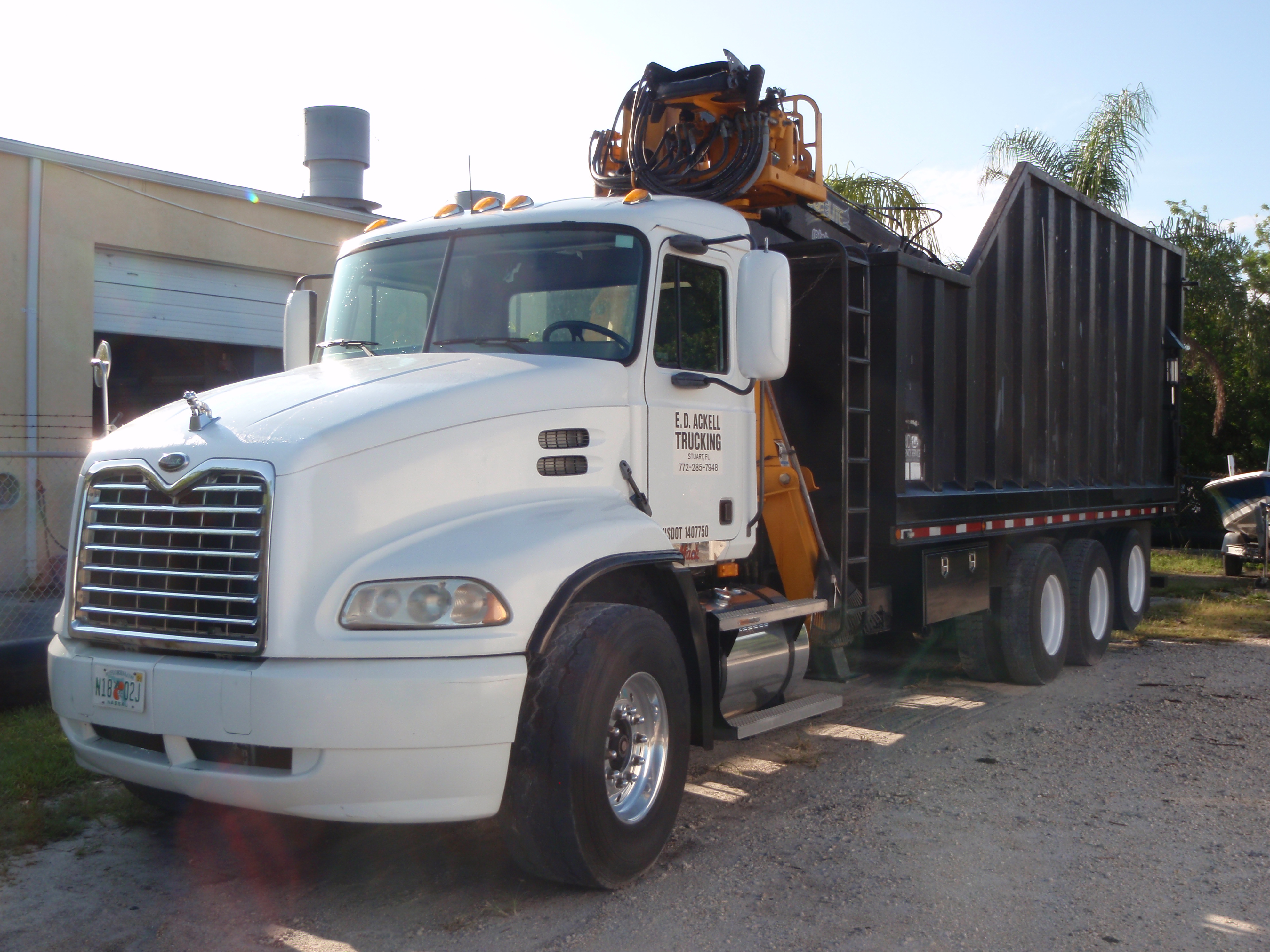

Yup, manual trans. w/ cruise. Works great on mine. Turn cruise on (one button) at speed, hit set, ride along. Can hit button to increase or decrease speed. Touck brake or clutch pedal and cruise kicks out.
Ran a dump truck with it. Sloppy muddy area, 1st gear, 1800 RPM, hit cruise and walked right thru. Other trucks trying to keep steady with the pedal would hit a rut or bump and truck would jump and bounce and die. Driver has to get out and hook chain from dozer.
