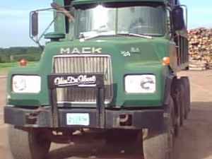

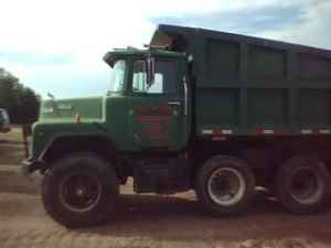

Hi I'm a novice here on MACK. What can you guys tell me about this truck Engine Trans rears lockers etc. All the seller could tell me was its a 1974. I think its A DM? Can Any body tell me what common problems (king pins leaks etc) with this MACK model. I wanted something nice to restore and do some PT site work. LOL.
Thanks

Yes it's a DM, probably a 685S. most common engine would be a 237 2 valve and the most common trans would be the six speed with two sticks.
From the pictures you can tell it has the 20k front axle. Can't tell what the rears are, ask him if they are either 5 or 6 spoke. 5 would be 38k and six 44k.
Pretty much a bullet proof truck, great as a site truck. If it has the Mack front axle( which it probably does) the king pins are adjustable.
As far as leaks, the most common are the valve covers.

the 237 had a run from 1966 to the early 80's. great motor lots of torque. the six speed can be swapped out for any other mack trans or any eaton but you have to also get a mack bell housing and do some drive shaft adjusting with either swap.

The truck pictured definitely has Dayton/spoke hubs. The hubs would have to be changed to accept any kind of aluminum disc or "Budd" wheel. Not worth the trouble IMHO. Why buy the truck only to change all the components?!? These DMs were bulletproof as built, very well engineered. If the components don't suit you, it would be more practical to find another truck.

That looks like a very nice, straight DM. These trucks are rock solid, and pretty good looking just the way that they came from the factory.
I second the idea that changing the components is probably just wasted time.
Shine it up and put it to work!!
It appears to be very well set-up with the two air lift axles and the heavy duty dump box.
Good Luck!!
