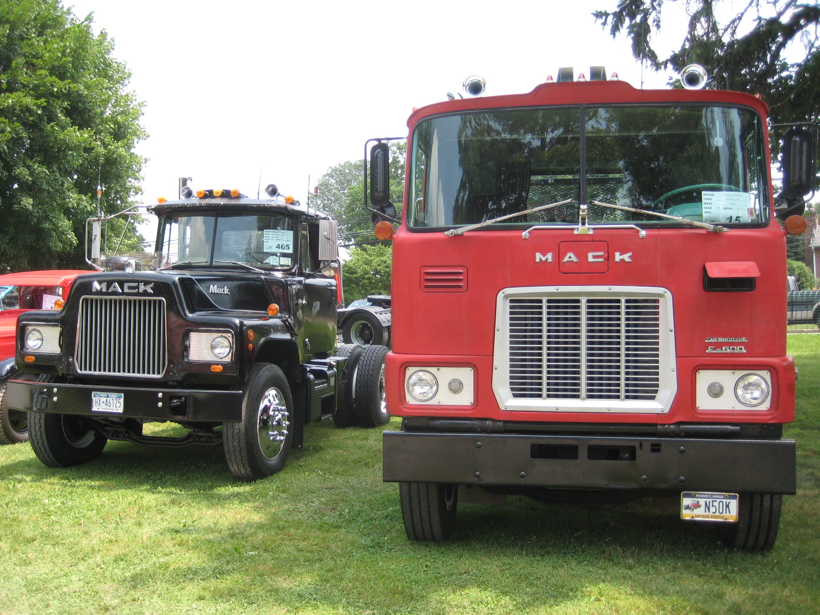

Now that you all have this figured out, I will insert the proverbial monkey wrench. At the ATCA Northeast PA chapter meet in Harford Sunday, we came across a 1979 U-model tractor with the plastic dashboard but the SHORT CAB. My friends and I had this same debate over when the cabs were updated, and if the U-model was an exception to the rule, perhaps in keeping the BBC short as was the purpose of the U-model.
Underdog,
I have never seem a U with the 3+ cab ! but yet the DM600's built in the 70's & 80' do have the newer cab ! Go Figure??
That's why I figure the U-model retained the short cab. Same reason for the B-67 concave cab. Shorter BBC.

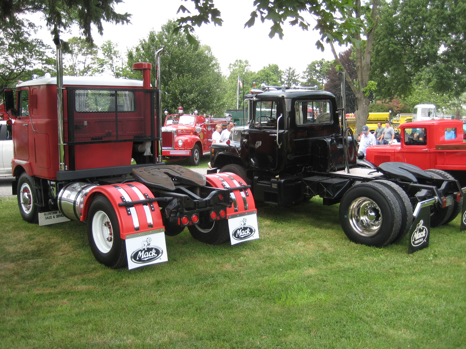

Are you talking about the green 1979 U model with the airfoil?? My Mack R was there, it was the white and red 1979 crammed between the two yellow bombers, my freinds trucks. Did you see the 1980 DM600 shortened up to a "U" model. I had to do a double take on that one.
That single axle DM belongs to a buddy of mine, he got that truck as is from FLA. Whoever did the conversion did a good job. We think engine and trans have been changed- it has an overdrive 2-stick. Originally built as a tandem roll-off chassis.
I had my F-model there, red single axle. It was a good show with perfect weather.
