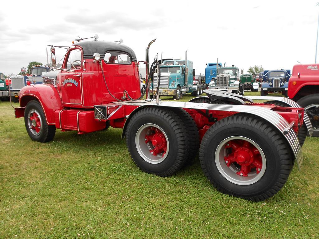

Here's mine:
Does yours have the clips out by the stacks?
I've seen some of the B's with a stainless bar across the top of the window with a long spring to support the air lines. Mine already had a pogo stick, though it was beat, so I got a new one.

Here's mine:
Hi Larry,
My gladhands are now mounted as yours. I was reluctant to scare the paint on the brackets, but I did alittle in order to twist them on the bracket but, not noticable until you dismount the hands. I cannot remember when the pogo stick was first introduced way back when. I want to go with that set-up if it is authentic for the 60's.
They were mounted laying on the deck plate wrapped up in a bungee cord fastened to the plate. Didn't care for that method totally. I do like your light set-up for rear trailer hookup etc. Hey I bet I would get clostrophobic in your garage :lol: cause most of the 1980's I was doing most of my work in a single garage, 100 sq.ft. I know a guy has to do what he has to do. How's the new rear suspension project going?

I like pogo sticks instead of the roof mount. Less chance the lines will rub on the cab. I also like the rear of tractor/under the trailer air line conections as it leaves the deck plate clean.
I agree, It has a good look to that set-up. I'll probably use that type of mount. I wish that I could remember when the pogo stick was first used on trucks.
mike :pat:
