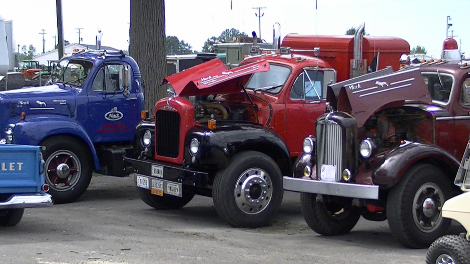

Saw Larry's truck today at the local car show. He did an excellent job extending the frame and installing the air ride and sleeper. The cab/sleeper pass-thru looks great. He should be very proud of his work! Lookin' good!!! :twothumbsup: You can work on my truck anytime. :rolleyes:
Ken
Bring it over Ken! I still got gas in the torches.........LOL!!!
Glad you stopped by the show today. It was quite the success as in the last three years. It finally rained about 3:30pm or so.
Larry
