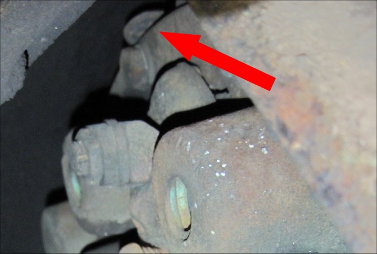

I know the motor is a later model, and the transmission is not the original, can you tell from this photo if it is a puch type for sure?
Thanks
Thanks
Yes it's a push type. The release shaft is below the centerline of the trans, and the rod pulls on the arm, which causes the fork to push on the throwout bearing.
It's definitely a double disc because the mounting bosses where the bolts attach the trans bellhousing to the flywheel housing are about an inch long. On a single disc bellhousing those bosses would be nearly flat.
Also in that pic is the adjusting bolt with jam nut that I was referring to earlier, but yours must have been replaced with a conventional 3/4 hex head bolt at some point..
"If You Can't Shift It Smoothly, You Shouldn't Be Driving It"
