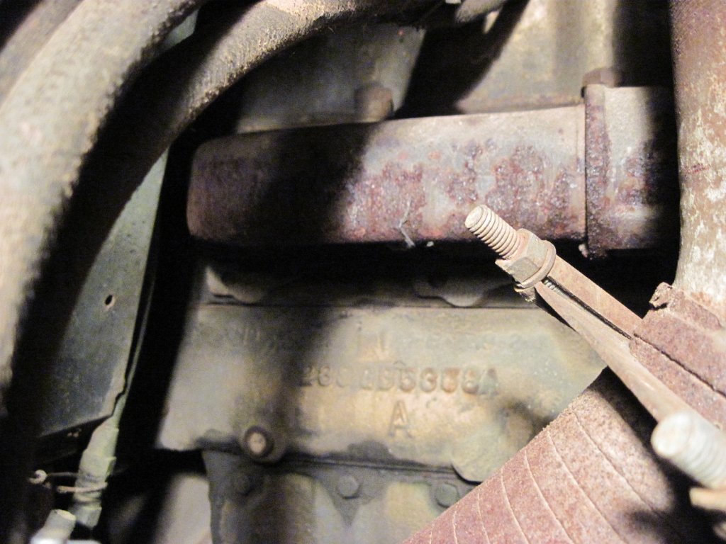

The #'s in your pis are cast into the parts, every casting will have those same #'s. what you are looking for is #'s that have been stamped in with a stamp and hammer or similar. Look where fjh suggested, ahead of the fuel pump on the top flat deck of the timing case.
Jeff.

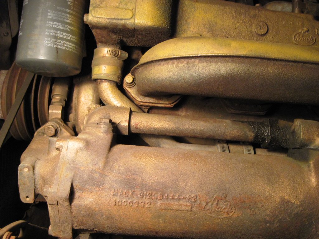

Is this the engine model number (first pic) and serial number? Any engine details jump out?
If your engine is an inline 6 cylinder 673 c.i. fuel injected then, the engine numbers are on the front gear cover,passenger side,on top, just under the secondary fuel filter. By the looks of your clean engine, it should be no problem finding it.
The first photo is your oil cooler with it's numbers raised or embossed,which most parts are that way. The engine numbers will be etched down inside the housing, same as your frame number and rear carrier housing.

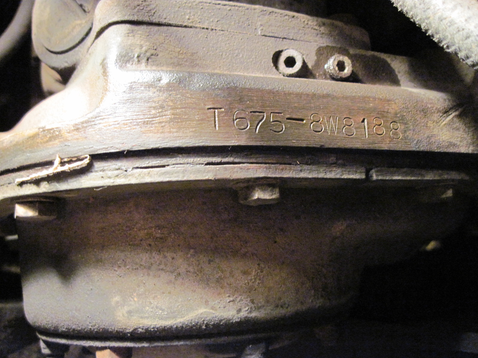

Right where it is supposed to be! Not an ENDT number though, anybody know what I have exactly?
237 Maxidyne series engine.

Top of the timing gear housing in front of the injection pump.  Check out the picture in the seventh post above dated Nov. 1.

Top front of accy drive should be the engine model.
Larry
