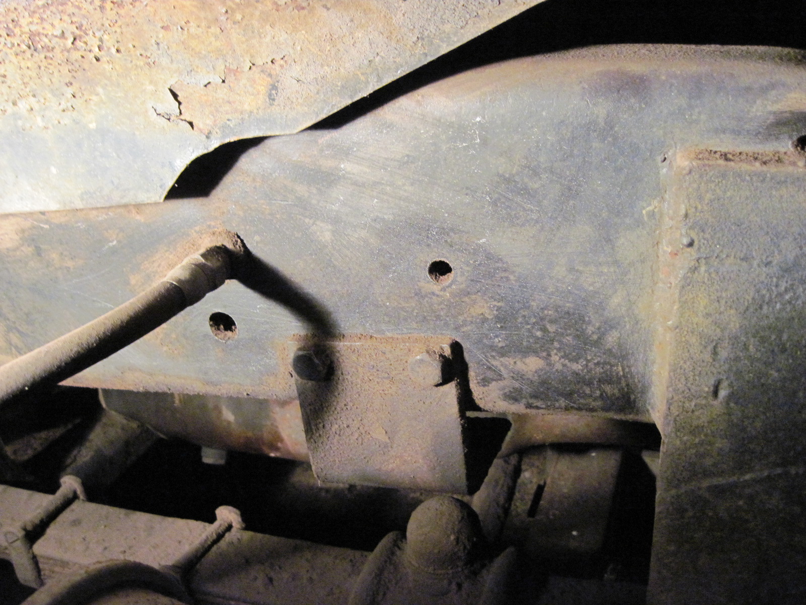

What is the welded plate for?
Some kind of heavy duty bumper mount...there is some structure with pivot point around the front axle...It looks like the truck may have had a snow plow at one time...

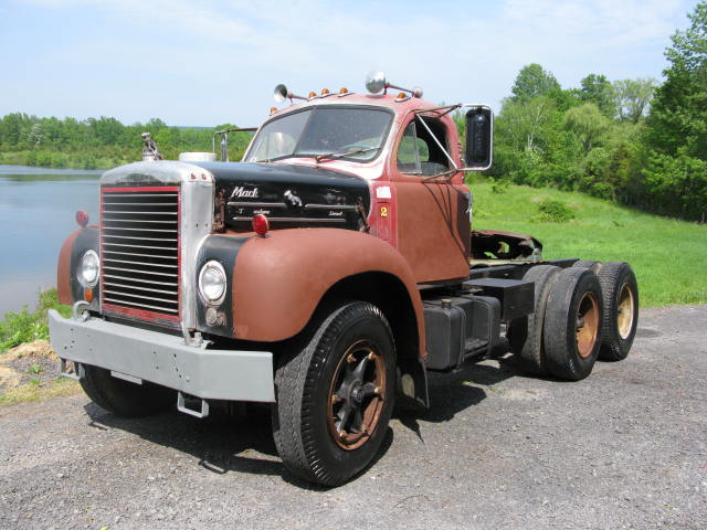

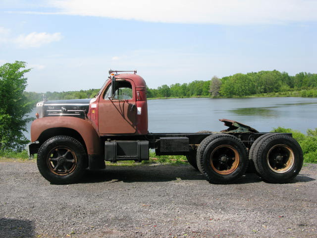

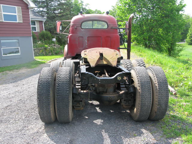

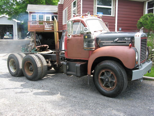

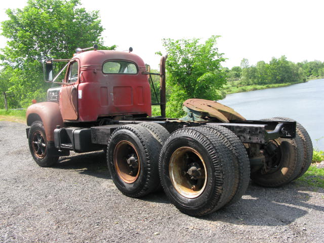

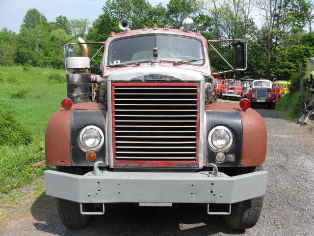

Hey leversole we have seen pictures of all inner workings of your 615. Where are the pictures of the outside in daylight?
That pesky job (read as monetary support for my new Mack project) of mine keeps me away till almost dark every night...here are a couple though...more to come.
The rear suspension under that truck are 40,000# plus rated with the acorn caps and two piece axle shafts.
Rob

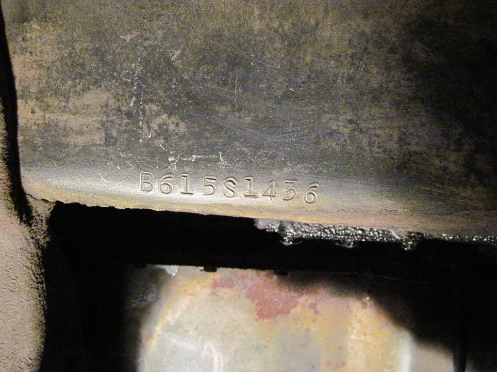

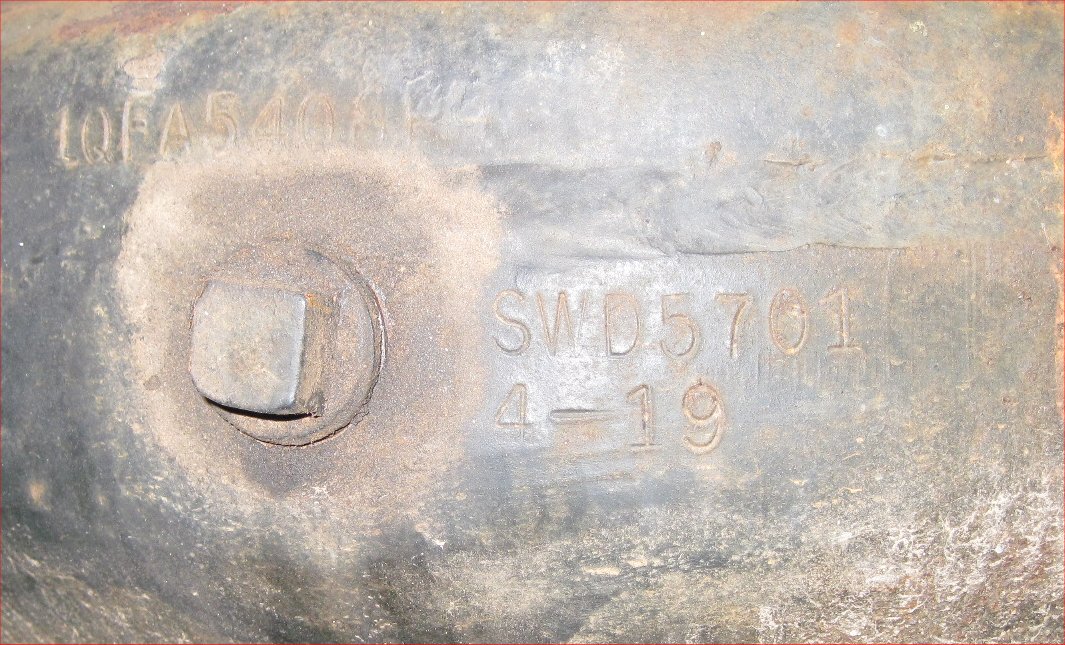

Found 'em...Do they give anyone a cluse as to what the weight rating or ratio might be?
Thanks
https://www.bigmacktrucks.com/topic/16351-frame-serial-number/#findComment-66320
Thanks
38,000# suspension. I suspect someone has changed something as the drive axles appear to be two piece using the acorn style cap on the driven ends.
The axel ratio will be stamped into the flat pad area just to the left side of the driveshaft yoke usually at the top rt. side of this pad.
Rob
