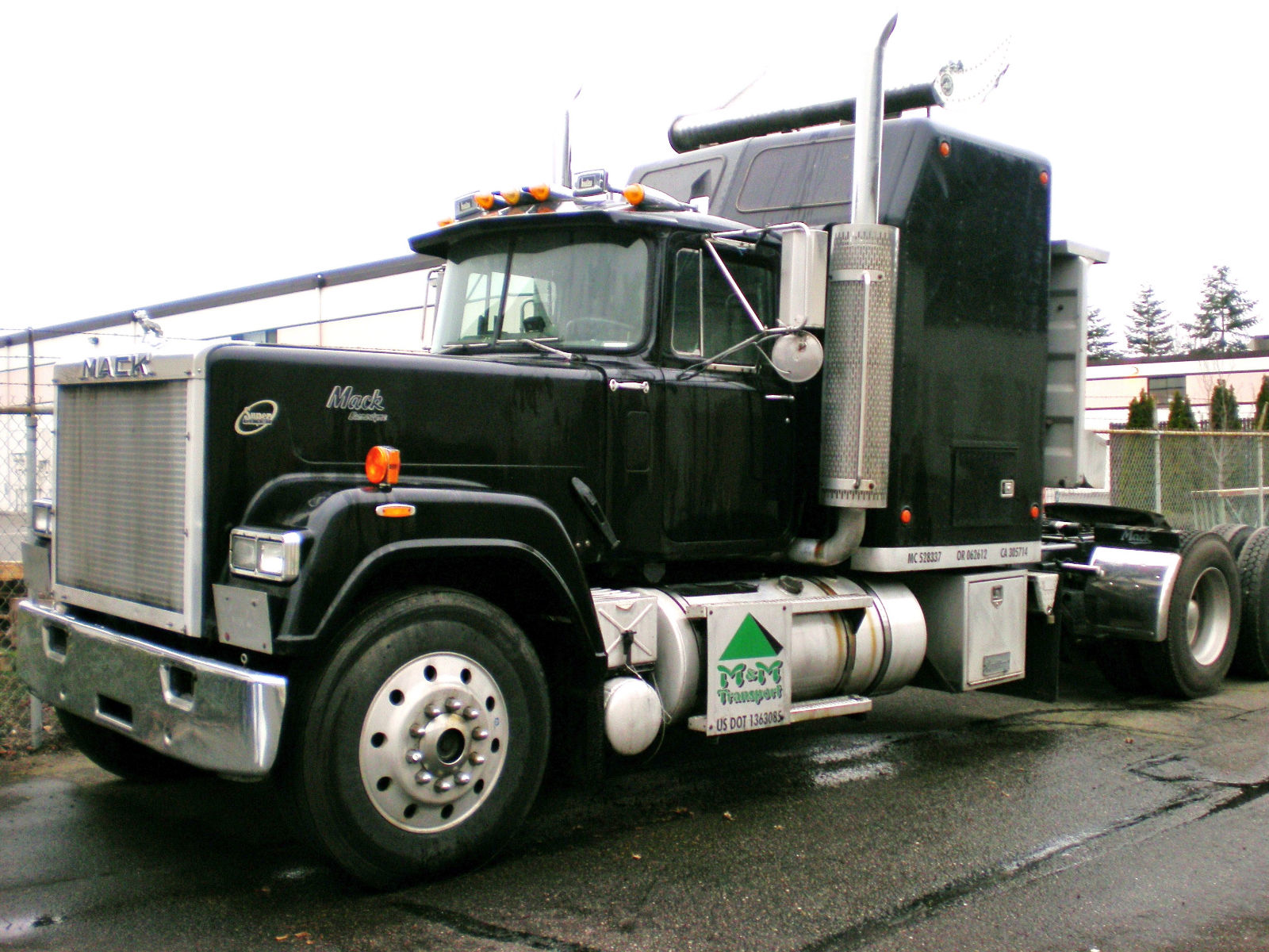

There's a Beautiful Black 1988 Superliner in Washington State E-9 400 T-2090 Standup/Walkin all aluminum, Turbo wing, Merrit headache rack/boxes all decked out for grabs. It has been sitting for 2 years and only started once in the last year and the sleeper boot and roof have been leaking. I got her down to $9000 on it, I just don't have the time or patience to take thing apart and go through it all. if any of you might be interested I can forward you about 50 pictures of it. She's wanting to sell it real bad because they're tired of paying storage on it. I got them down from $13,000 I don't think they'll go any lower but you never know.

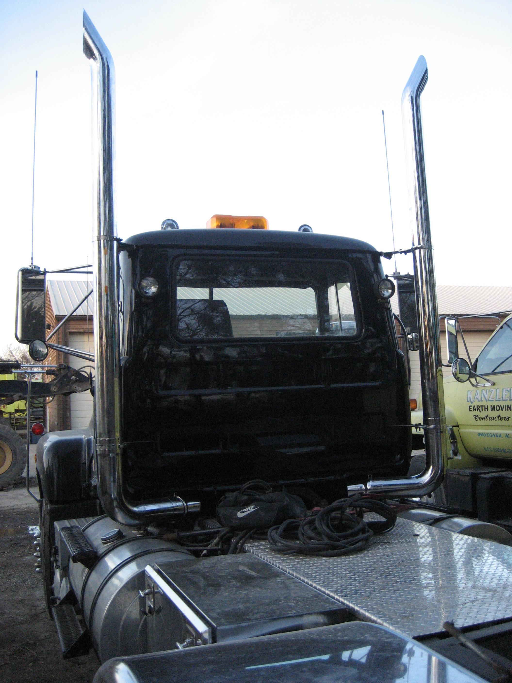

thanks, sal's truck is sweet id like to do my exhaust like his, did he make new brackets or is there a kit to bolt up tp the factory brackets, thanks
dont know if it helps But I just made some new Exhaust mounts for My RS700post-17-031013900 1291872565_thumb.jpg. the factory cab mount brackets were made for 9" mufflers. just a simple band but they were a problem all the time, crooked and sagging etc... What I did was used the factory inner cab stiffner plates but made my own out side brackets. Once they were bolted to the cab I used a Pete style clamp to hold the straight stack closer to the cab bracket.. I could have made them about 2" closer but I think they look fine. I can still fit a muffler on if I want but that was not the look I wanted. the top mount is factory it uses the rain rail to hold a steel bracket/clamp a quick fab and I also used the same pete style clamp up top. the hard part was adding the bottom under cab bracket. I used a angle iron welded to the inder side that has holes for a saddle clamp to hold the bottom of the elbow. the lower clamps support all the weight and the rain rail bracket just holds the pipe straight and level.
