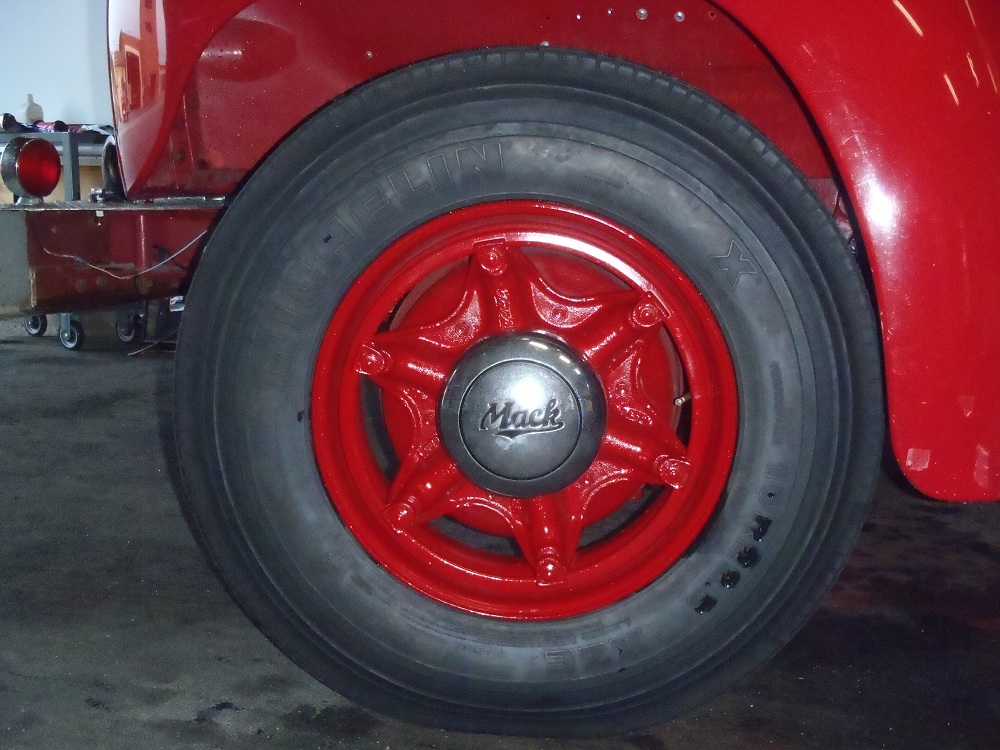

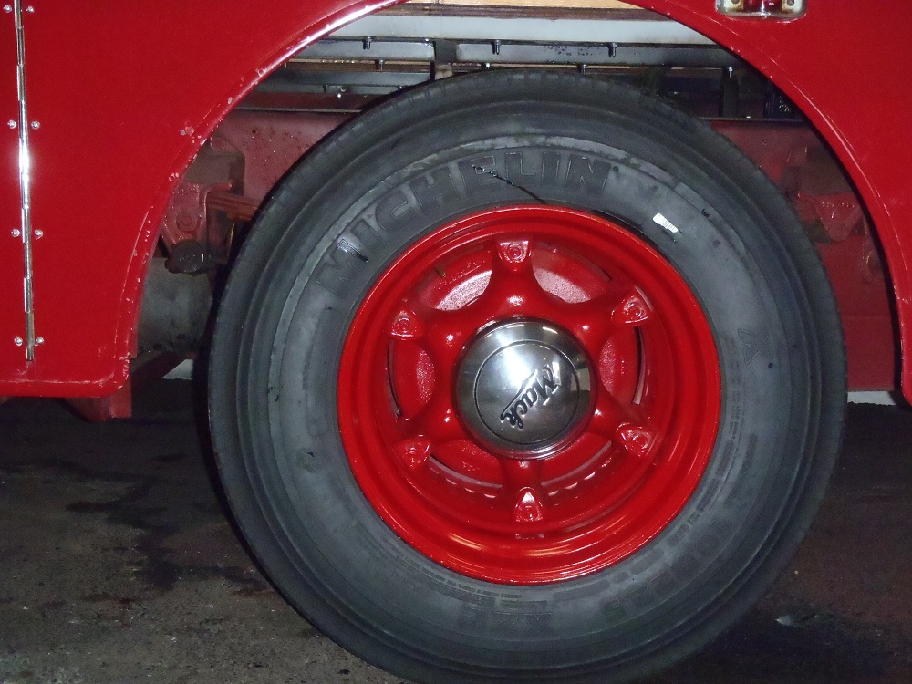

I recently converted split rims to one piece tubeless rims, without using a bud or aluminium wheel. The one piece rims allow you to use tubeless tires and they fit right over your spoke hubs. Once installed, the untrained eye won't be able to tell the difference. Also, you won't have to worry about the hassle and danger of the split rims. The one piece rims are made by Accuride. They have a pretty good website, with a comprehensive product catalog. I will write back with more specific info in the next couple of days. In the meantime, I posted a few pictures of the installed one piece rims. engine3

thanks for adding the pics,
As i am a new member, i was bit confused, but got clarified after looking at pics.
keep it up.

where did you purchase the new rims for your fire truck? it looks like a B model,what year?
We purchased the conversion rims from Century Wheel and Tire in Montebello, CA. They are the only Accuride dealer I could find in the L.A. area. The Fire engine is a 1957 B-125.
