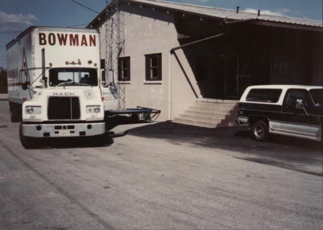

ANOTHER TRUCK??? You keep it up and you are gonna be livin' in one of them. I am checking on a engine for you to. I cannot remember if our U Model's had 2 or 4 valve engines in them, but one of them was still running as a yard truck a few years ago but I think it is only a 300hp. I'll let you know what I find out, might just add it to the collection of stuff you have over here in your "east annex"!!!
Terry how many U models do they have,are they parting out any or selling them together.thanks Ron
They only have the one left. It runs well but the cab and hood are shot. I don't know yet if it is for sale. The semi-retired owner of the business will make the call if it is for sale or not. It has not been for sale to a few others who have inquired about it, but we have been friends since I was a toddler and I have bought 2 other trucks from him that were not for sale.
