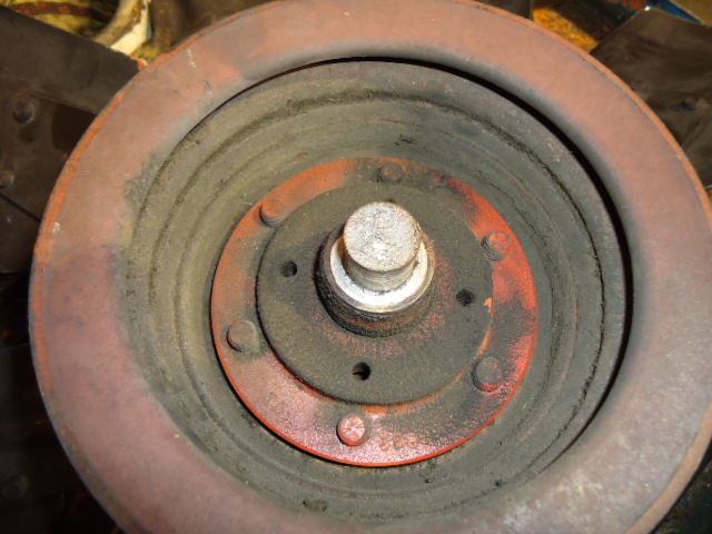

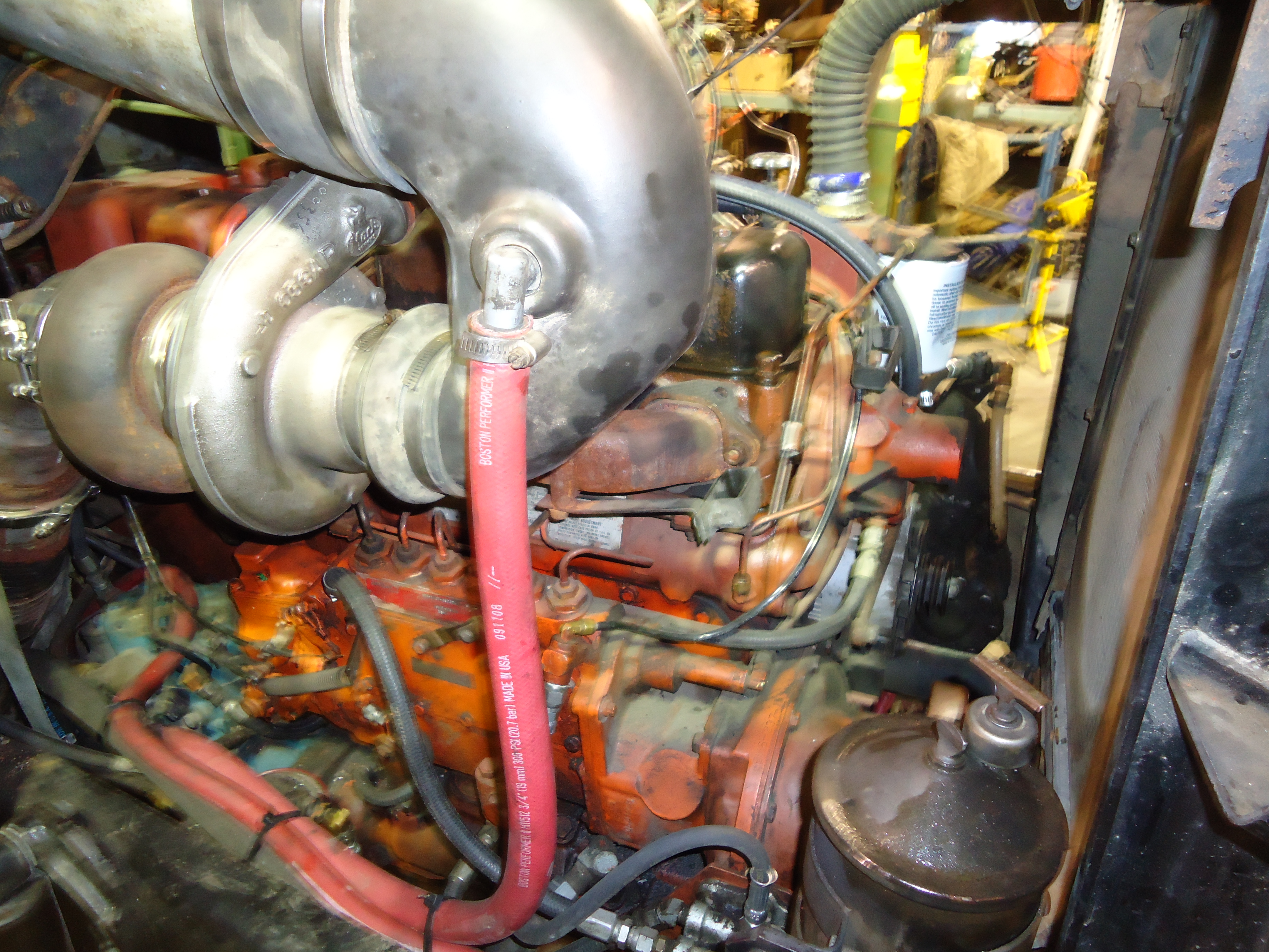

I finally finished installing a 1986 EM6 engine into my 1971 DM600 log truck to replace a ENDT673 that had given up the ghost. It cranked over maybe twice and it fired right up! It runs great and thanks to David in North Carolina, it was not too hard to convert.
But guess what is missing from the front of the engine???????

I don't see a water pump shaft or fan.
My thoughts exactly. Did the shaft walk out of the housing due to bearing failure?

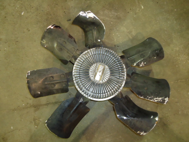

The fan and water pump shaft are missing in the photo, but a few minutes before, when the engine was first fired up, they were in place.
Right when we were in the "High Five" position after it started up so well, we heard a loud bang and the fan went flying off the engine and embedded itself in the space between the frame holding the front motor mount and the bottom of the radiator. It is hard to tell from the second photo, but the water pump shaft had an old crack in it that you could tell from the rust and it just broke off - I am just glad it went down and not out the side! Now I need a new fan and water pump. I have an old R model out back that may have what I need.
I DID NOT FORGET TO INSTALL THE FAN - it just looked that way. My middle son accused me of not tightening something down. I am going to tighten him down.

All it did to the radiator is kind of shave the bug goo and black paint off - didn't hurt a thing. It put a nasty gash in the side of the power steering tank, but neither leak so as soon as I get a new fan and pump on, we should be ready to drive it out of the shop. I thought the belts would be bad, but they still look new.
Should I go back with a clutch fan or do I use one that spins all the time off a older R model I have? The one off the original engine won't fit.

I like a thermostatic clutch fan as it's quiet some of the time. A mechanical fan is always loud. An air clutch setup is very nice but expensive if you need to purchase everything new.

I would go with the clutch fan out of the old R model, it should fit...does your radiator have shutters in the front? Depending on the thermostat in that engine it might run cool in the winter. I have an 89 glider kit DM600 and with the older engine and no shutters its like pulling teeth to get heat in the winter unless you cover up the radiator...I miss my older trucks, shtters work so nice in the cold :(

I have too different fans that will bolt up to the used water pump I am installing. One is a five blade and one is a six. Which should I use and why?
My old truck has a good working set of shutters. I went ahead when I replaced the engine and replaced all the air lines including the shutter ones. They seem to work fine, but we only haul logs with this truck a load or two a week and if it gets down around zero, I tend to stay in the shop and keep warm!
If it were me I'd use the six blade fan. Nothing wrong with the five blade but the six will move a little more air through the core, but the main reason is efficiency. A six blade moves the same amount of air with less parasitic drag on the engine.
