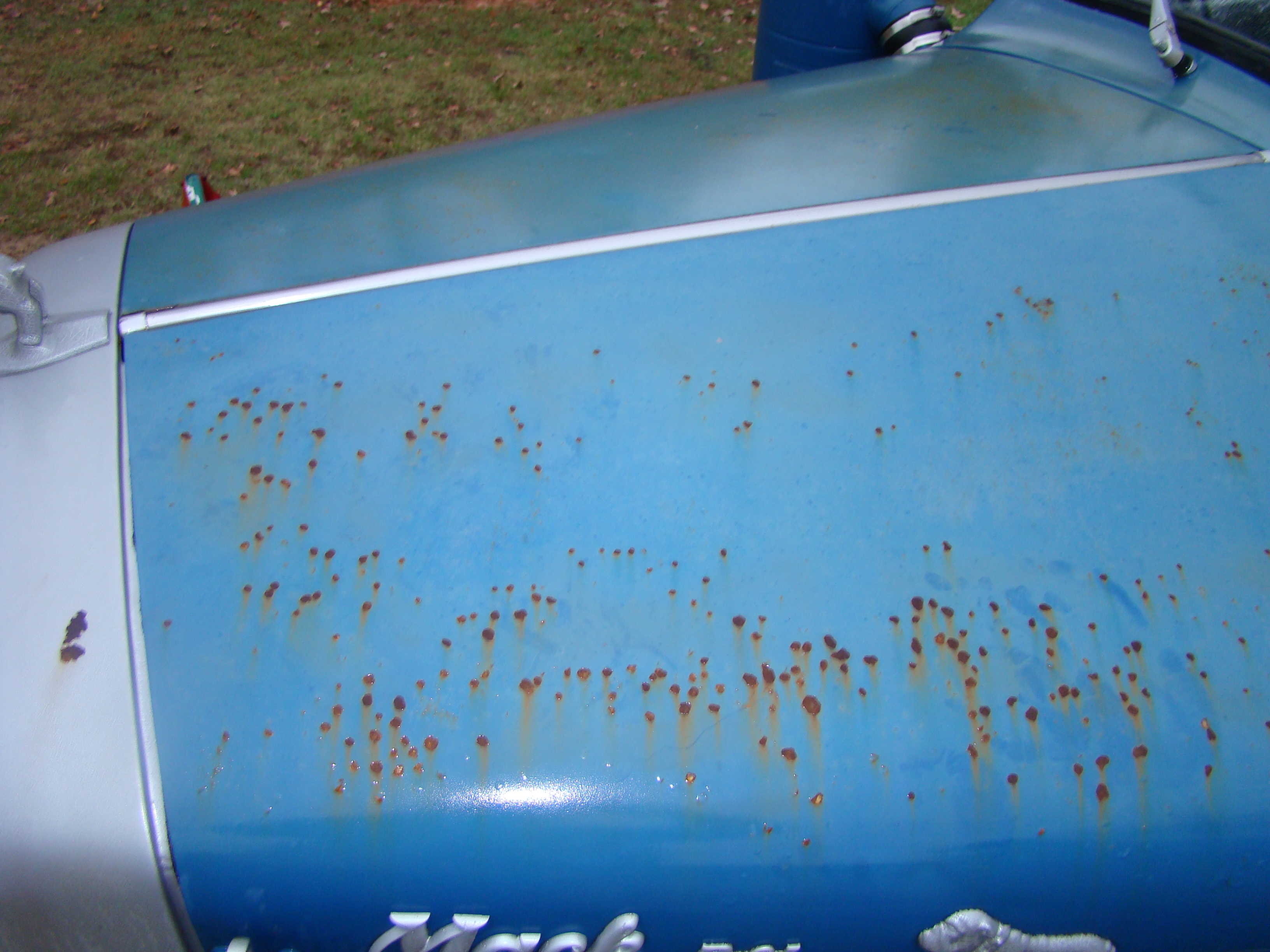

Rob, looks bad, I may not be a good parent. Killer gets to sit out and enjoy our lovely texas summers, never gets to go indoors. This summer, he got melanomas all over drivers side of hood and some on drivers door and a lil on roof. There is absolutely none on other side of hood, other door or not even a trace on fenders. Paint started bubbling up, popping off, now got ugly looking rust. Dont turn me in to any official agencies or anything, am gonna try to fix him. Whatcha think i orta do , lotta sanding, cleaning, and painting? Sorry,,,,Randyp :pat:

Hi Randy, first thing I'd do is remove the hood and D/A the paint off of it complete using 60-80 grit "D" weight sandpaper on a 6" sander. This will leave you with dark spots where the rust is showing. Youi can take a small sandblaster and spot blast the dark areas till they are lightened up a bit, then put on nitrile rubber gloves and soak a clean cloth in phosphoric acid. Wipe the complete hood panel that is now devoid of paint letting the acid "dwell" on the surface but do not let it dry. Dry the panel with another clean cloth. You do not need to rinse with water. This will effectively kill the rust in the pores of the steel panel and etch the surface allowing for better primer or undercoat adhesion. Then paint as usual.
After acidizing the surface I usually use an epoxy based primer/sealer to the bare steel followed by two coats of surfacer primer. This is then blocked down flat either by hand or with a power sander, then topcoated with color and/or clear.

Awright then, thanks Rob. Do you think that was just a piss poor paint job to begin with on that side of the hood? I will fix him and try to do better,,,,randy :)

It could be a multitude of factors. One quite simply, age. For years Mack used a sythetic, or alkyd oil based paint on their trucks. These did not retain their "luster" nearly as long as the later acrylic based products. There is also the possibility of improper preparation of the substrate, or inadequate dry time between under, and topcoats.
Basically what happens in reality is the sun breaks down the ultraviolet screeners in the topcoat allowing penetration to the primer below. The primer has no sunscreeners within it's chemical composition and "kicks" the topcoat off of it. Now exposed and porous, water and humidity can penetrate and you have rusting. I'm sure you've seen or heard the phrase "Non photochemically reactive". This means there are no suscreeners in the product. All topcoat paint is photochemically reactive to resist this breakdown to the sun. This, along with the cost of pigments to make up the final color are what drive the cost of paint so high. Hardeners, accelerators, and most other additives tend to make the product more "user friendly" or faster/slower for shop throughput.
Clearcoats have little to no pigmentation in them. They are very photochemically reactive to resist breakdown. A gallon of clear that costs say $300.00, has much more UV screeners included than say a $100.00 per gallon product.
It's damned crazy what it costs to paint a car or truck these days using quality products that yield long term good results.
