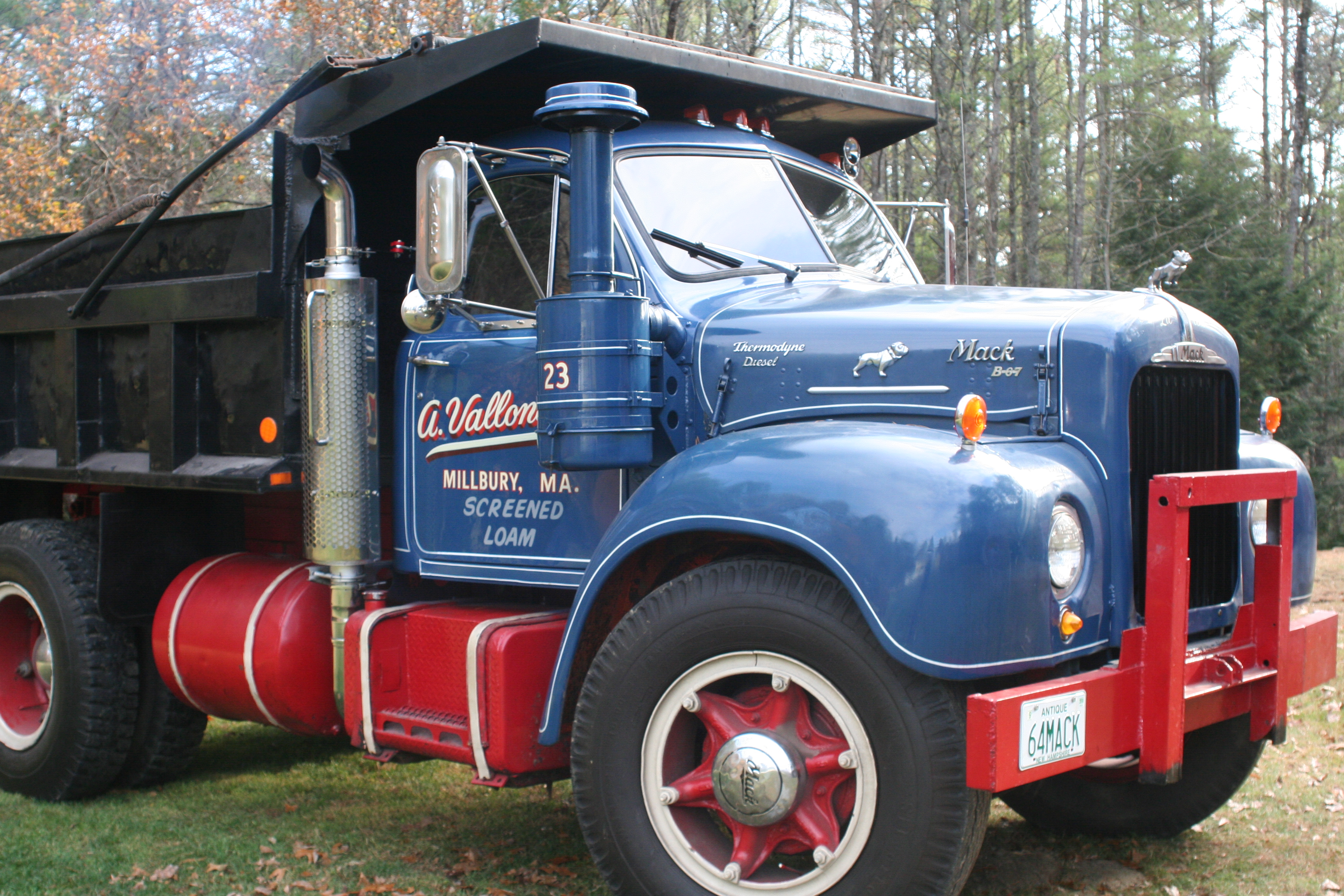

post-3032-092907600 1291730809_thumb.jpgWe're doing a front brake job on our 1964 B Model. Front axle FA505 with 10.00/22 tires. We need brake drum part numbers. Any help would beappreciated. We did find what looks like the following on the drum (17OJ3186) then what appears to be a casting number (66205). Thanks so much

Measure the drum dimensions and check with Gunite: http://www.gunite.com/partscatalog/partscatalog.asp

Thanks for the link. I did research and find the Mack part number is 17QJ3186. I tried finding a cross reference chart but the one I found Web Wheel had every Mack number but mine. Any cross reference charts out there?

Mack superseeded the part to a 17QJ3186A, but show none in their parts system.
