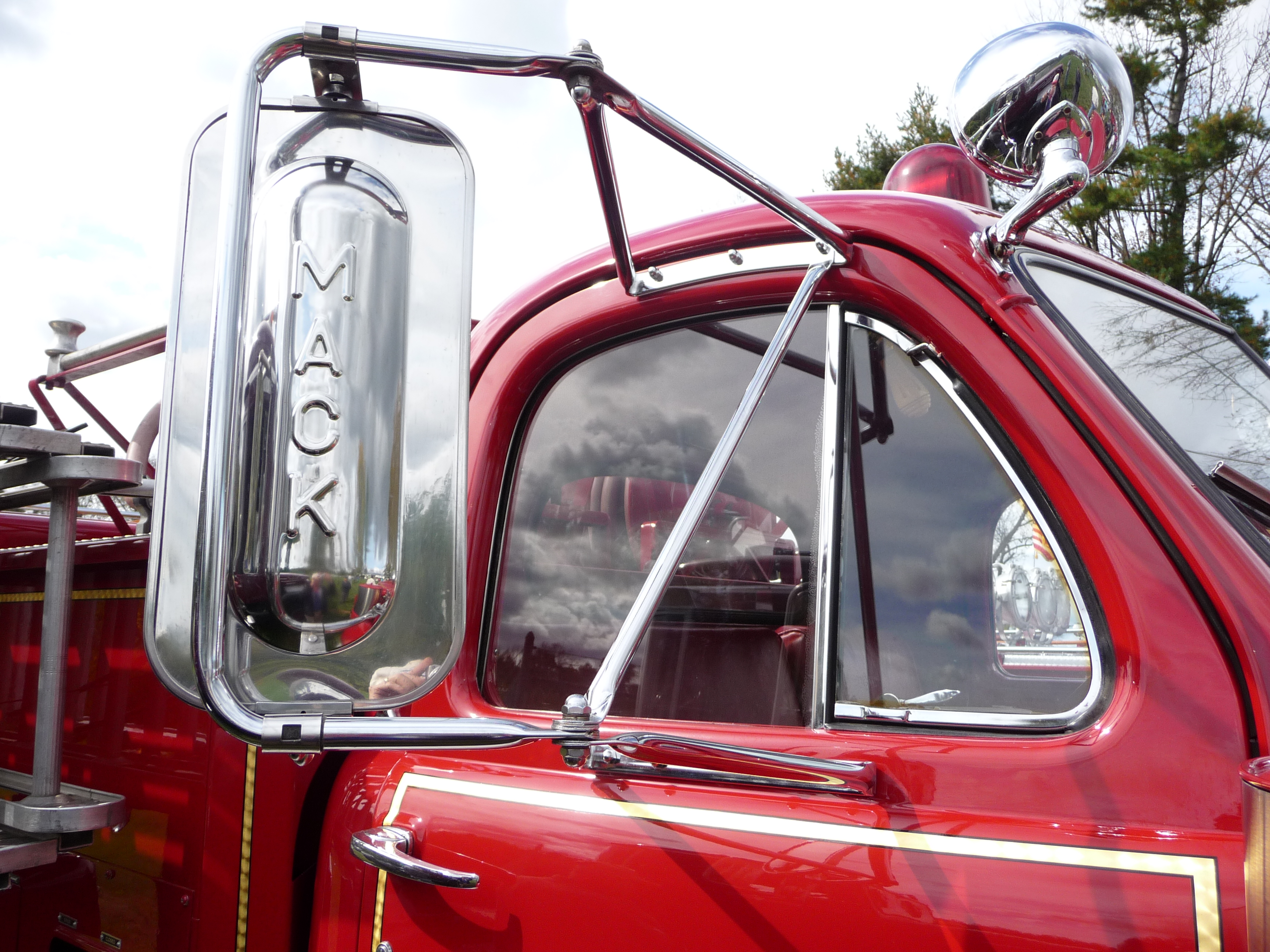

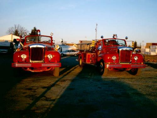

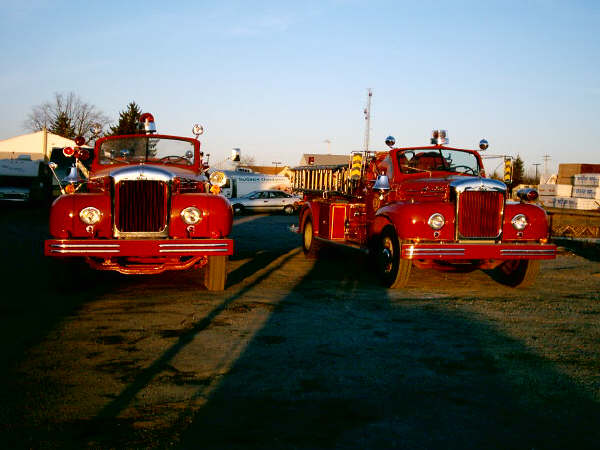

Malvern's B75 Open cab has West Coast Mirrors and they did a nice job mounting them. (see the 2 B75's together- Radnor's with original mirrors on the left and Malvern's with West Coast mirrors). When mounting the West Coast mirrors- The bottom bracket is standard, the top bracket is modified with a curved/angled bracket to mount at the top of the vent window with 3 bolt holes into the door, to make a sturdy mirror attachment. I have a picture of the mirror details for Malvern's B75 , but have similar picture of the closed cab version on a B85, the only difference is the curved bracket is mounted on on the vent window side. I will scan it if you need it. I personally like the Mack mirrors on this B85 better than the standard generic mirrors on Malvern's B75. The L model door is slightly more vertical, but has the same curved section at the top.
