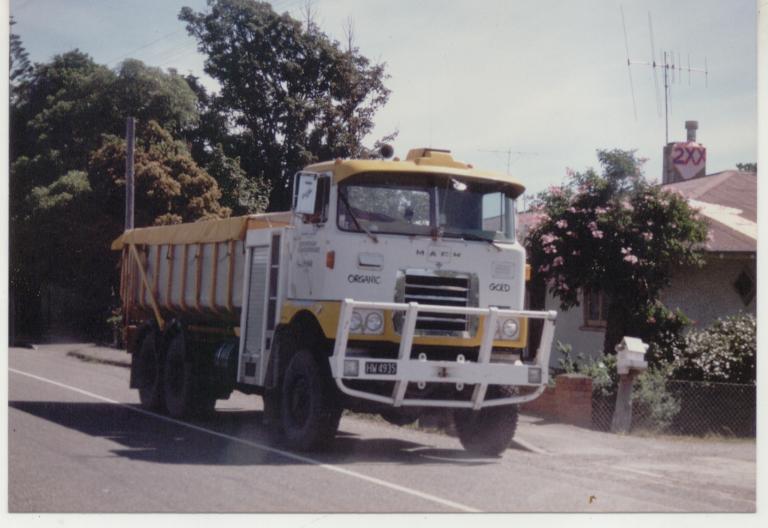

I found this picture in my Science encyclopedia (had them since I was a kid) under the truck article. It has a grille that I have only seen on heavy duty F models in New Zealand with all wheel drive. The different front hubs indicate to me the second steer axle is driven. The rears are tandem drive with a lift axle in front. What model numbers/letters of the F mode were all wheel drive? Were these all wheel models available in North America?

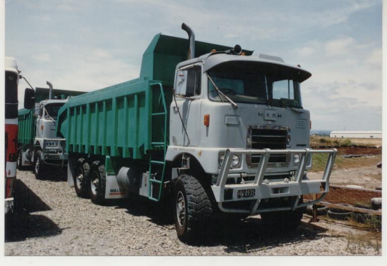

This has to be the most awesome looking F model I have ever seen!

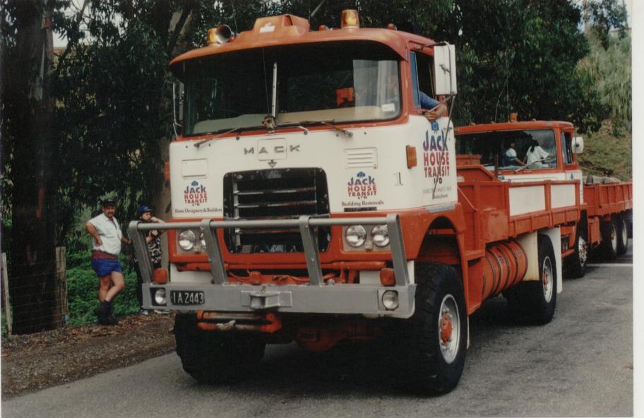

More of the same type of F model:
Man they look damn good.

Now I'm not 100% sure but :idunno: ..........that grill here in Aus was used on the V8 's
And i believe the second axle is not driven but simply an outer bearing cap with a circlular step as used on some old Atkinson truck's of that era

I think You are right that the second axle isnt driven. I thought that it could have been a step but the hub looks different unless its just the picture. I have never seen that grille on anything but those all wheel drive trucks so far and they are either down under or in Kiwi.
