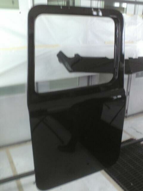

Looks really good going so far!! You seem to be willing to do the job right which always grabs my interest in a project.

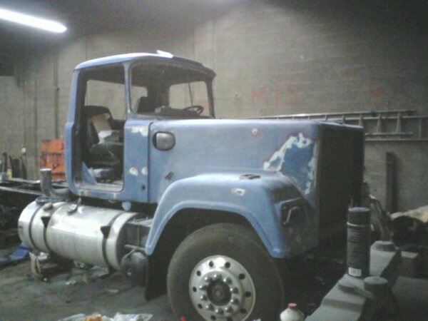

How'd the frame repair go? Never heard anything other than you were going to split the outer to eliminate the rust spread. I'm assuming you got it welded back together alright?

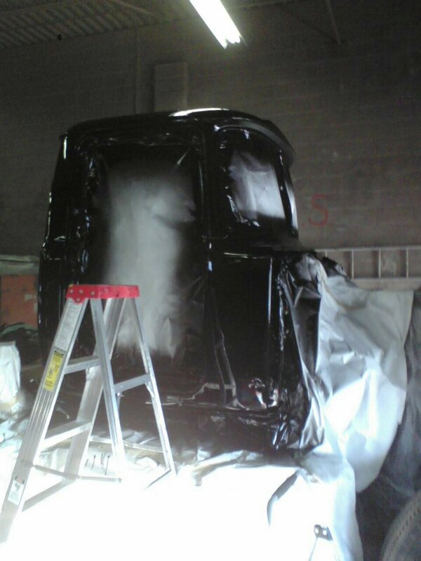

Thanks Rob It gets frustrating at times, but its worth the effort!
The frame turned out great, I cut it inline with the x-member, that way i took advantage of the x-member bolts to help alg. and stiffner it up. I used por15 on the mating frame rails and apox. on the outer surfraces.
I am painting the cab sat morn @ 6am, think you can be here by then? I buy you breakfast!! mmm..Canadian back bacon eh! Bob0

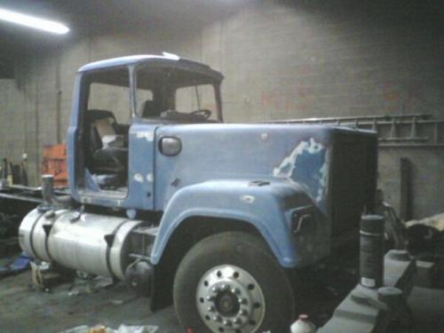

Is that V8 engine original to the truck? I thought an RW713 would have an inline Mack engine?

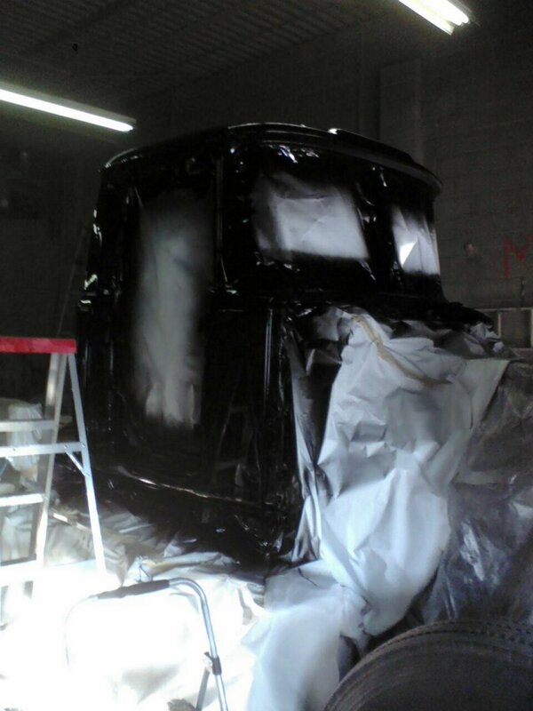

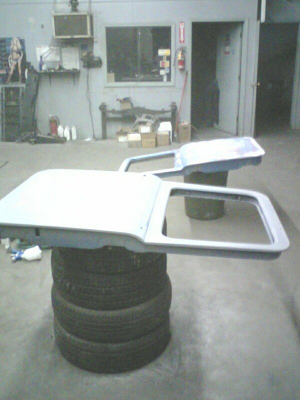

Looks great! i too am a big fan of seeing a job done properly! sure gotta' admire someone going with black paint! bodywork/prep must be just right,as i have always found black the most un-forgiving,one little ripple and you can see it a mile away (or kilometer LOL!) what brand paint/supplies are you using? i have always had good luck with dupont products,just a personal preference i guess. Best of luck,hope it turns out as well as it looks,be sure to keep us posted with further progress!.....................Mark

Rob the rw713 could have any1 of the 3 mack power... E6,E7 and E9. The v8 is original. Im glad Im almost done Im sick of sanding!! bob0
Im using Pro-spray, base/clear. Not to fussy about the primer, but base is nice to use. b0Bo
I'm not familiar with that brand of material. Is it a knock off of some other major producer of automotive refinish product? Or is it like "Transtar" products?
Rob

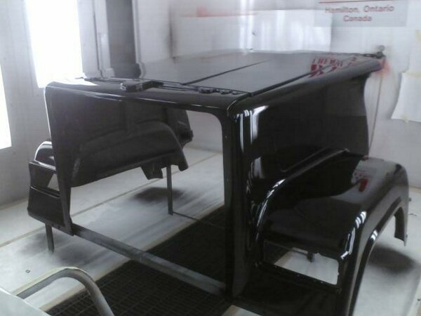

My local body supplier carries it. Its made in England, they got bought out by US Chemical & plastics. Its a great paint for the price! why pay for a name?! now that the cabs done the fun begins!

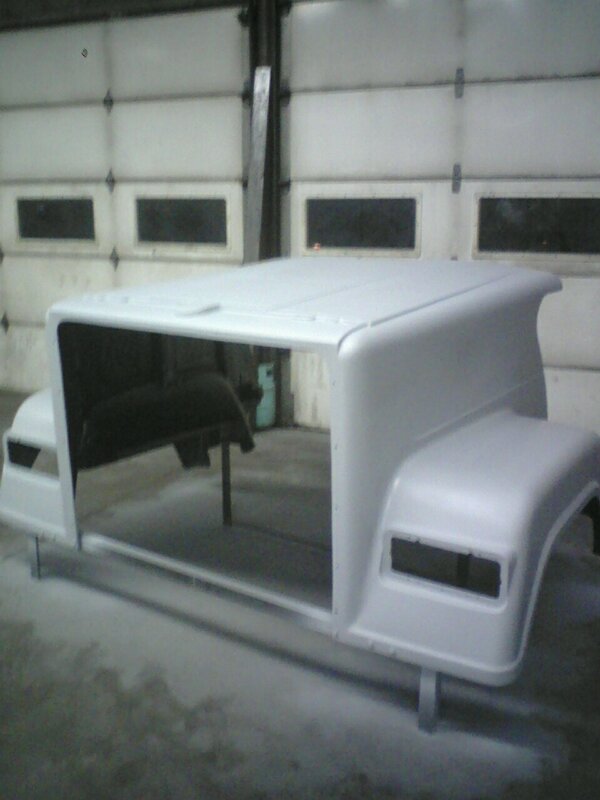

looking good Bobo. My cab was looking like that early this year after I Removed and Replaced the stock rotting out roof.Rob was a great help with all my bodywork questions so he deserves credit for the help!
I know what you are going thru. every time you remove this, you might as well remove that. next thing you know the whole truck is stripped. I am curently working on a RW713 with a E9450. Former boss ownes it and I always wanted to restore it. I like working on the long hood macks. just something about them....keep the pics coming!
