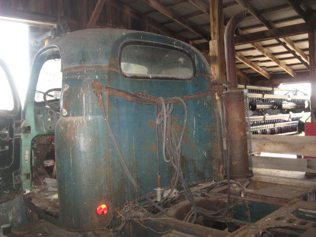

some cabs will differ depending on the model here are a few common diffrences
concave rear wall.
Diffrent floor hight
Dog house in cab firewall
also the cowl aera on the passenger side may have some diffrences due to air cleaner mounting and ducting of the air.

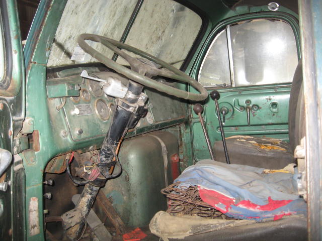

In looking at the B model cabs. I see mine as a flat back B-613? and is the concave cab for trailer turn radius clearance? I don't completely understand "Dog house in cab firewall" though. There is a box on the floor between the driver and passenger seat.

the concave rear wall was for the nose of a trailer. It gave a tighter Bumper to back of cab (BBC) and thus a longer trailer could be pulled. it was all about length laws back then.
the dog house is what is used to cover the rear part of the engine if it protrudes into the cab. Chevy/ford vans have the center consol or "Dog house" that can be removed to access the rear of the engine for maintance. that little box on the floor under the seat was for the series/parallel switch. used for the 12volt run/24 volt starting electrical system
the B613 should have a "standard" B model cab.
for got to add that some B models also used the L model cab. more commonly found out west.

Doghouse, (under dash) and concave rear cab on my B67ST.
