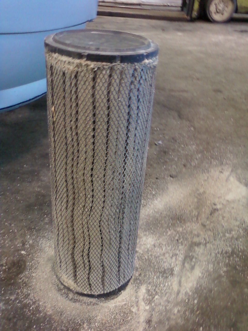

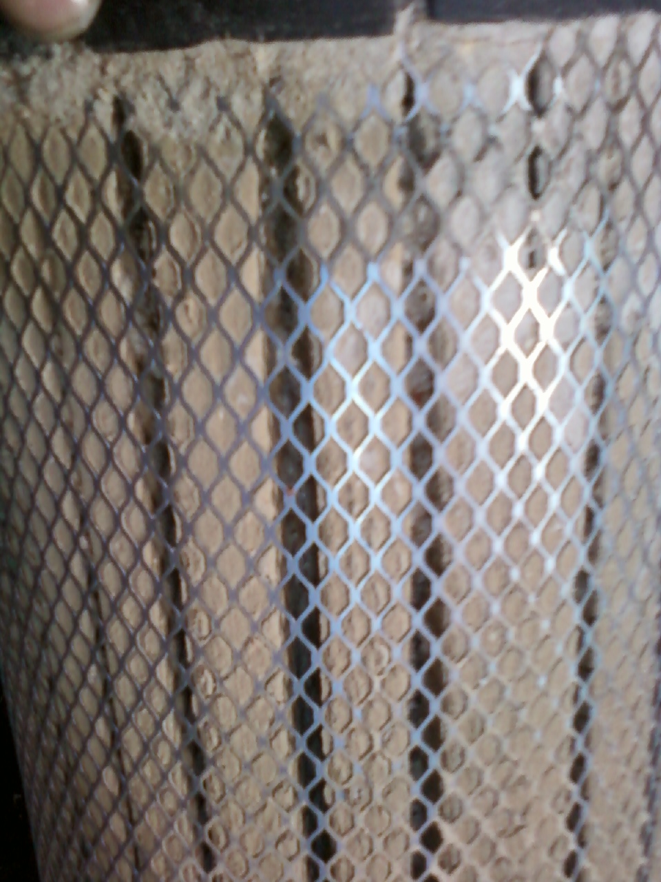

And these are usually the people who bitch loudest when their truck blows up! "i take good care of MY truck!" we just changed that filter 3-4 years ago,whata we made outta money?? LOL!.......Mark
My truck gets a new air filter every time I change the oil and give it new oil & fuel filters. Sometimes I feel like THAT is even too long...and it's only a couple months.
The filters in my pickup trucks generally last several years...but they don't play in the dust near as much, and probably see less miles in 3 years than the Mack does in 1 month. B)
That one was pretty bad. :blink:
I know a lot of guys that change there air filter every year whether it needs it or not,the filter in my cl is going on three years,I'm going by what mack says and watching the restrition gauge,is this wrong should I just change it anyway.This subject has come up from time to time with some of my friends and they say I'm nuts for not changing it once a year,I tell them to read the label on the filter housing,what do guys think?
I change mine usually once a year,though i do keep an eye on it,i look it over at PM time,usually wipe out the filter housing,blow it out with an air gun etc. If it looks like it needs replacing i do,but you gotta remember i do NO off-road work,so mine lasts considerably longer than usual. I think if i did what you do,i would replace it more frequently,just my 2 cents!..........Mark
I always vaccum (or vacuum?) the housing out on mine if there's any crap left in it when I take out the filter. Figgerd if I took the air hose to it it'd blow crap down towards the turbo. When I had the Mack I'd usually change it twice a year...'new' truck has 2 filters on it-shit ain't cheap!

Every oil change-10,000 miles. But I have a spare and blow it out. Swap them and haven't had any issues.

I know alot of guys blow out the air cleaner element but that is a good way of blowinbg a hole in the paper.I do shake them against the floor.I was in a donaldson sales meeting years ago and they declared that a stopped up air cleaner or one loaded with dirt was still as efective as new a filter only thing it cant get enough air thru it.

Don't think I'd trust the "filter minder" type indicators either. I do have one truck, (winch truck) that has this type all the others with dry element filter use a manometer gauge in the dash calibrated in inches of water column. I think these are a Donaldson branded product and use an 1/4 inch plastic line to the filter housing to indicate filter restriction.
Glenn is correct that a filter is good until it cannot pass enough air through it. A partially plugged air filter is actually more efficient at filtration than a new one. We've been told over 20 years to not "blow" a paper element filter clean with shop air as it breakes down the cellose composition paper used in these things.

No, dont trust filter minder indicators, they are your enemy. Quickie story, several years ago was in strip mine on bulldozer, dozer was very low powered and smothering down. I called maintenance on radio, they showed up, looked at filter indicator, it was okay so they put fuel filters on it and left saying they couldnt break seal on air filter housing open unless indicator in red. Dozer still smothered down, I killed it and removed air filter, it was really, really bad. I removed filter indicator, hate to admit this, put it to my lips, gave a quick draw,{aint saying suck}, and put it in red. I screwed it back in, put dirty filter back in, called maintenance again, they showed up, looked at filter indicator in red and stated it must have been stuck earlier. I didnt let on that I knew anything bout it, they pulled air filter, said "Well damn, heres the problem, you need an air filter!" Heh, I just said no shit, magine that. They put me an air filter in and all was well, dozer pushed good. Durn stupid company maintenance policies,,,heh heh,,,randyp
