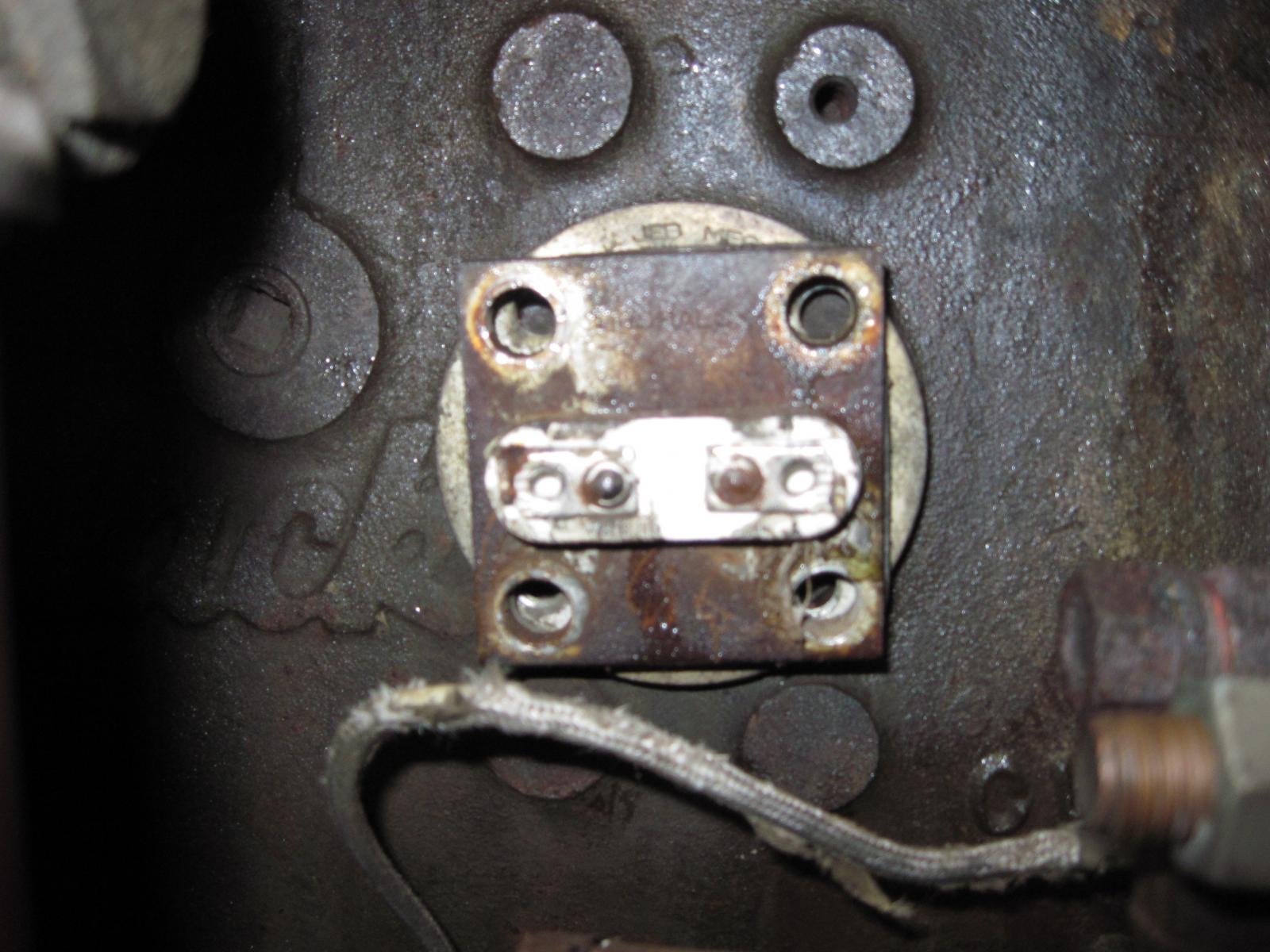

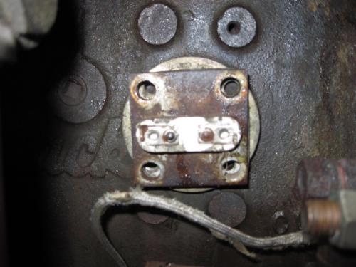

Just grab that square plate and slip the element out of the block. It does down, so you will have to wiggle it around.
There is an insert screwed into the block with a shoulder on it. There is a ring behind the shoulder that the element plate bolts to(with a rubber gasket). I had to remove mine completely when I installed the screw on filter housing.
To remove the screw in bushing, I had to heat and chisel it out.

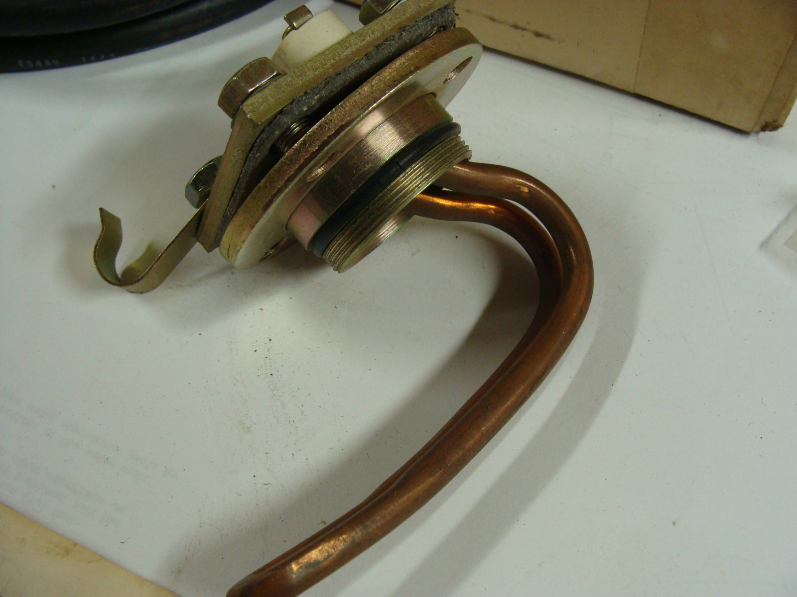

Yup. That threaded part, with the o-ring screws into the block. But I see you already have this fixed and truck running. Thought I would reply just in case someone searches this.

Yeah, I gave it a little pry to break the gasket loose and she came right out...tested good on the bench at 10 ohms (I thought I tested it in the truck?!?!?!?) Anyway, my cord may have a SLIGHT leak to ground, enough to trip the GFCI, or my GFCI is weak, any way it works great on another house circuit!
At the end of the day I learned something, and it didnt cost anything...
Thanks for the help

I am wanting to replace a not working square, bolt on heater adapter with a conventional style heater element.  Like the 81 and newer trucks have, mostly for ease of future replacement and parts availability down the road.
Can this be made to happen with the existing water jacket plug/bushing that is currently housing the bolt on heater, OR should I use one of the other water jacket plugs?
Im thinking something like this might work.
https://www.ebay.com/itm/173017045115
