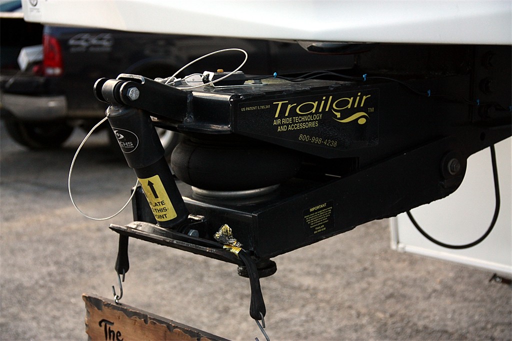

If you have to use a regular HD 5th wheel, you can get an air ride pin box for the trailer, but they
are not cheep.

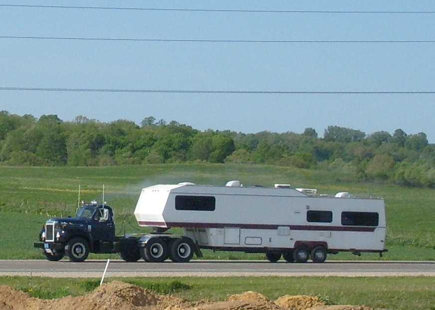

leversole, I have had no trouble with my rig and have pulled it with my B Model for three years. It is an older trailer and is very well built. The guy we bought it from used to pull it all over with a newer Peterbilt. I put an electric brake controler in the B Model, changed the trailer socket to match the tractor, and I run 80 PSI in the steer tires and 60 PSI in the drive tires.It creates a lot of intrest wherever I go.We pulled it down to Huntsville, Al. in '09 and have been all over Minnesota and Wisconsin with it. Jake

I believe this is what Peter J is refering to.

Air pin boxes are not expensive. I put one on my rig for around $700.00. IMO an air box pin will not smooth out the ride from a class 8 enough, you will need an air ride fifth wheel, or some other way to make the truck's suspension less harsh like air ride suspension. There are some after market suspension kits such as More-Ryde for fivers which might help as well.
