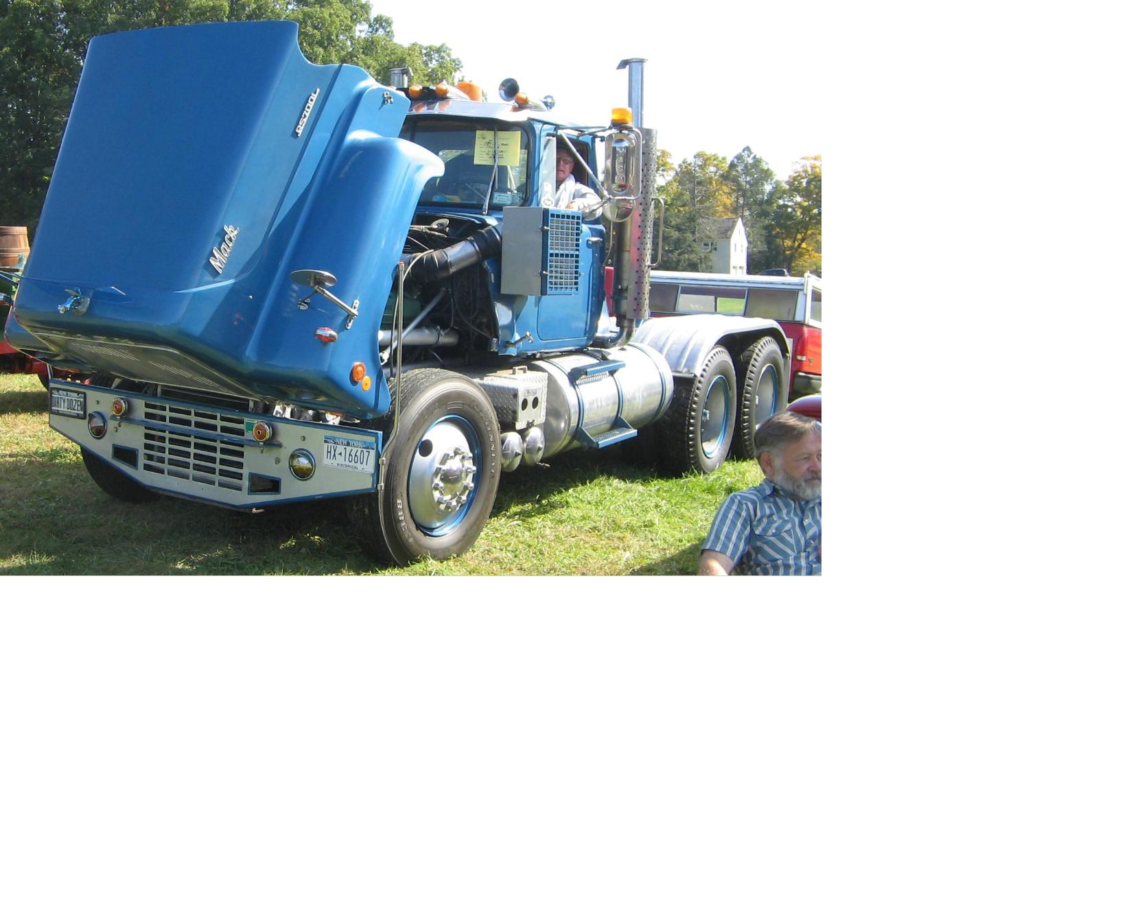

He pointed out a few things that I have never noticed. First was the side filler panels behind the air cleaners the other was the lack of the cowl vent. Anyone have pics of these thigns up close? hood open to see how they got them in. He is a model builder and is looking for some specific details to reproduce.

Most likely the filler panels are modified from normal to use the dual "Farr" air cleaners. Those things really free flow air but do not silence at all. A Detroit with them is quite loud during operation. I surmise the cowl vent was eliminated to allow clearance for the rear blower on the engine as they sit quite high in the valley. This coupled with the air intake adapter to feed both blowers I'd think the vent would be in the way.
I've never seen a 12V-71 powered R model before so these are just s.w.a.g.

Trent,have you checked out the 1971 RL-700L in the classifieds? it is reported to be one of 3 with a factory installed 12-V-71 Detroit,has a good picture attached,i too have never seen one in person (not from the factory anyway)...........Mark

I spoke to the owner on Saturday,that truck is one of 3 with an aluminum frame. The hood on the tractor looks a little longer, an where the vent goes, it almost looks like they narrowed that area for the hood maybe?? also the extensions on the sides under the air cleaner?? now i just got to figure how to get it to Jersey!!!

Ernie.looks to be in pretty nice shape!(i like the 72 myself) i think Rob is right about the cowl extensions,and i would imagine the hood is longer than stock,the engine itself seems too long to fit the standard hood,maybe some sort of small doghouse in the cab? i relly cant say for sure,cause i've never seen a factory V-12 in a Mack (in person)only Brockways,GMCs,Autocars etc. would sure go nice with your huskypup! LOL!........Mark

To my ratio and proportion eye I'd say the hood is the standard length for an R700. This is judging by the wheel opening radius and placement, the length of the hood extension from the back of the fender rearward, and the length of the flat portion of the hood panel itself. I don't see any difference in any of these measurements from mine. This is of course, just a guess.
A Detroit "V" series engine in a straight frame rail truck would be a tight fit. I'm certain it could be done but with the splayed frame of an eastern R model, the engine could sit lower in the frame and probably not have some of the clearance issues of the straight rail truck such as an RS, or RL700 series. This is why I'm going with the R795 for my project.
