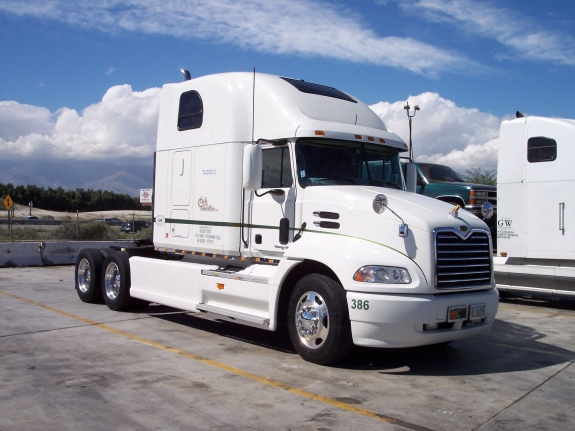

I own and operate a 2001 CX-613,E-7 460,13 speed road-ranger,with currently 1.5 million miles on the clock,which i bought new,and other than a few minor things,my truck has been nothing but dependable! i do however mantain it to standards others may not,as i make my living with it,and have no plans to sell or up-grade anytime soon. I'm not a big fan of all the new EPA/emissions BS thats coming either! so thats one more reason to keep what i have.I am of course ,a big proponent of Mack trucks,and have bought them exclusively throughout my career,but this one has been a damn good truck! and find no reason not to recommend another one to someone in the market,with the exception of understanding some of the inherant problems with them ,previously mentioned in this post,so do your homework,get all pertinant info/records you can,then you can make an informed desision based on that information..........Mark
post-5836-0-95619600-1299555406_thumb.jp
