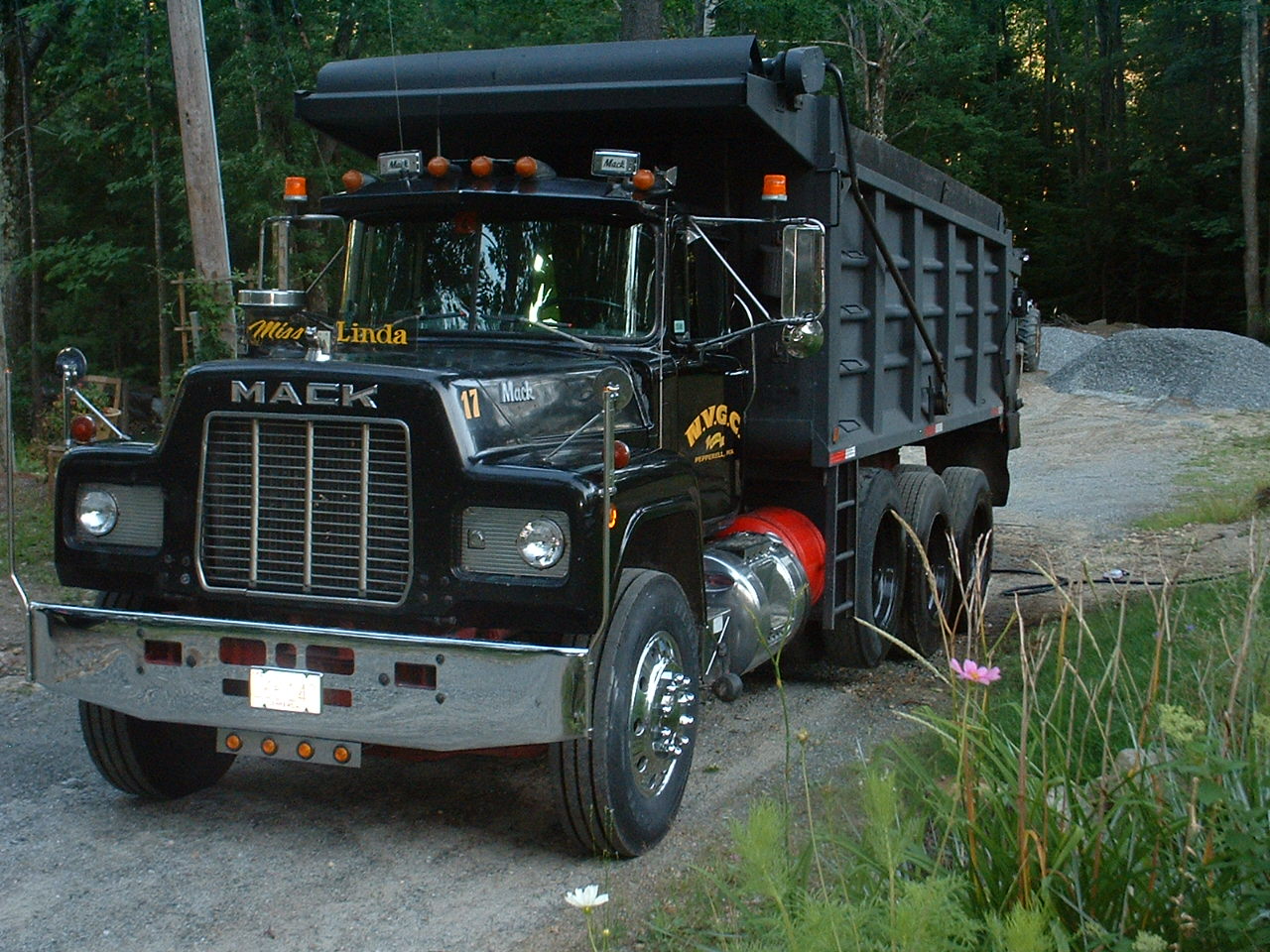

Hey all, I run a '89 R688S, 350/12 tri-axle dump hauling mix here in the northeast. I spend a LOT of time back and forth on the highways and my right leg is constantly jammed up against the heat/ac box - and I've had about enough of that. I just recieved the King Cruise unit and it appears to be a stout and well made, will install it after the injector pump is rebuilt next week. Curious if anyone has any experience with these units in general or in applications similar to mine. Thanks, Rick

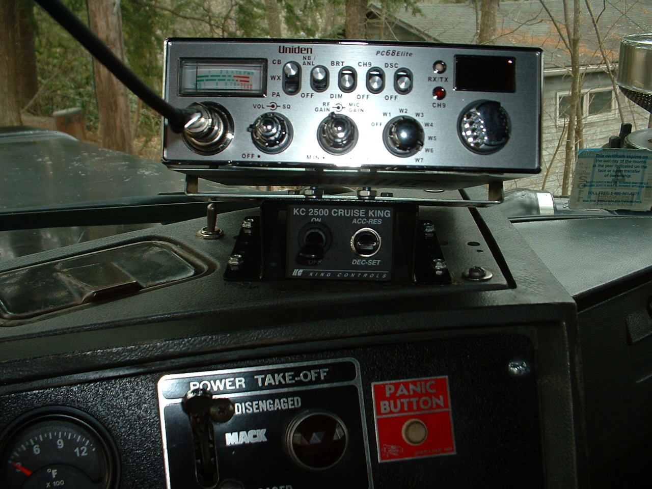

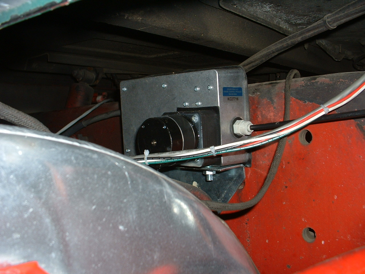

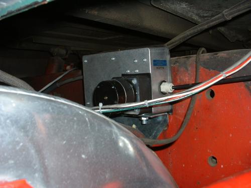

Well all, after a few delays, I finished installing the King Cruise unit today and after a few minor adjustments, worked exactly as it should have during a quick test run up the road this afternoon. Installation was straightforward, I like the way its set up,and its a solid, well-built unit. Wiring is the most time consuming part of the install but overall not too bad of a job. Steve at King Cruise answered the phone on 4 seperate occasions and helped me with all of my questions - very helpful. Wont have a chance to really test it out until later this week (rain tomorrow and the next day da#$@%it) but from what Ive seen so far Im very pleased.. Rick
I have install sevral in the past years and one thing i will tell you to do is water pruff the unit more than it is now. You have it mounted were the road salt can get on it and that is the killer. I would spry it with the clear plastic spray or some selicone arould all joints. I see thay have a better looking cable now. The cable was something that would get salt in and frezz up.I run a dump also but dont need a cruze that much but today i ran 540 miles and most of it was on the big road.So i to whished i had one.

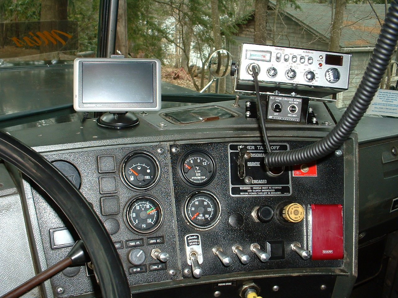

Rick, what is that "Panic Button" for? Does it Automatically roll up the windows and lock the doors so stranded Peterbilt drivers can't get you?
Lol Looks like an Old AA&E truck. But being a rock bucket. unless it was converted who knows
Rick, what is that "Panic Button" for? Does it Automatically roll up the windows and lock the doors so stranded Peterbilt drivers can't get to you and steal your truck to finish the job they never should have attempted in a lesser truck?
Thought that's what you meant.
Tonight's edition of "Fix That Post"!!
Thanks Herb.
Rob
Hi Guys, I hit the Panic Button every time some idiot almost kills me while they are on the phone or texting or doing anything other than drive - its a miracle that poor thing hasnt worn completely out. Rick

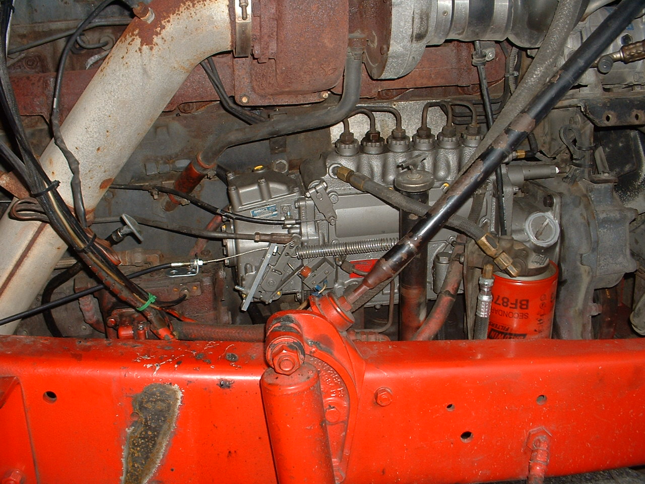

I've run the King unit for about a week now and have found that I need to increase the travel of the cable to reach full throttle and still let it return to idle. I called Steve again at King and he gave me step by step instruction on how to reprogram the unit for the extra travel so I will do this tomorrow. I'll let you all know how it goes after this is complete, have a happy Easter, Rick
