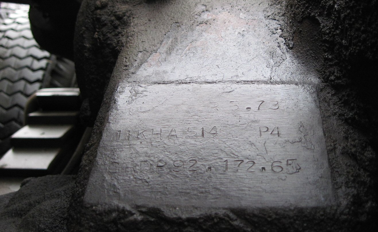

Hi all,
I have the numbers "354" imprinted on my rear diff housing. What does this mean? Does it mean what centres are in it?

Hi all,
The diffs I have seen have the ratio stamped on the machined plate on the front side as shown below, also, it should read #.##, the ratio with the decimal point, such as 4.42, or 5.73 (like mine!)
