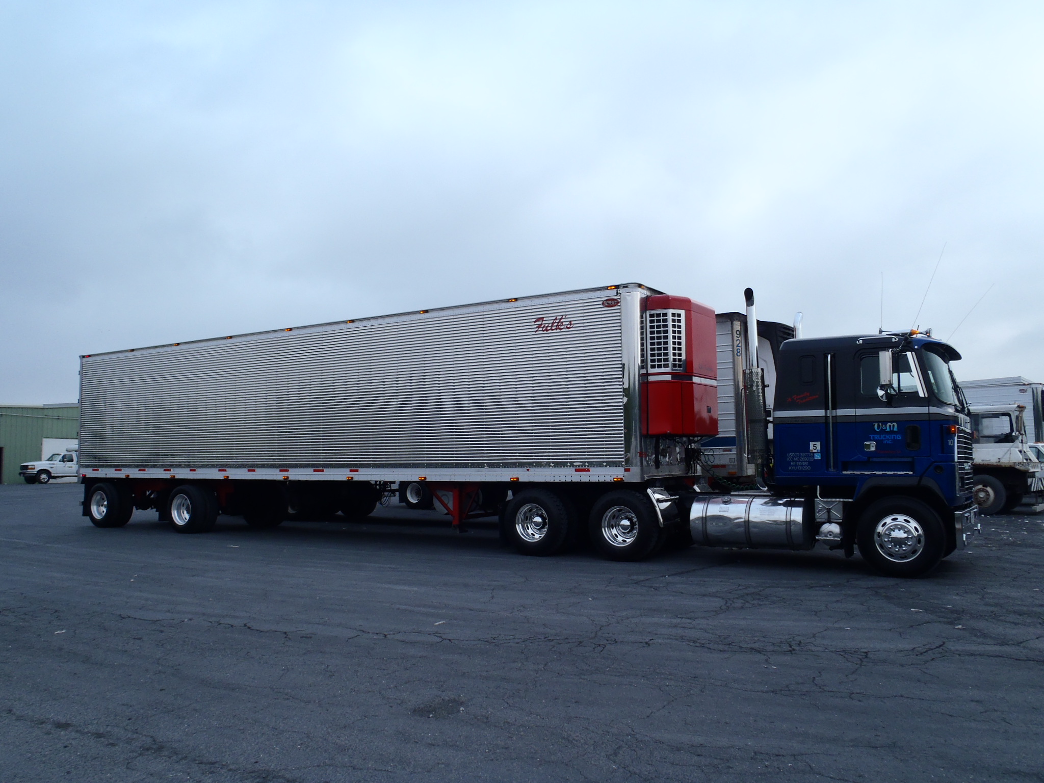

Grounding issues with those cabs was always a problem. There are several metal strips that run through the cab and serve as both reinforcement and grounding points. There may be other problems but the I think getting the grounding issues solved would be a good place to start. We are parting out some stuff on the MH pictured. Let us know if and what you need.
John
post-1471-0-41167200-1306096522_thumb.jp
Do you still have your blue truck? I thought you were selling it. Good to hear from you.
Hi Greg! Sold it but bought another one (just like the other one only 7 VINs newer). I am a glutton for punishment! :blink:
Ken
