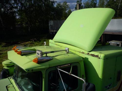

Hi Pawel,
I noted, yes, and I was surprized to see that special bogie carriers on the Superliner chassis.
So if anybody has a mind of their use after the 60's I'm in the interest to learn about.

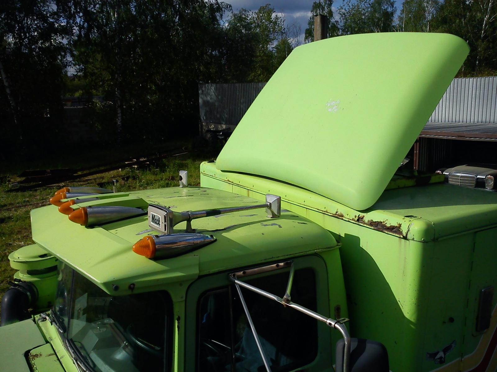

One more over-roof wiev I made on days.
You can also see the bullet-type top lights on Watt's truck sales online shop, just look the forum list.
I'm going to get a set of although the price is a bit off a model-building range :blush:
Vlad

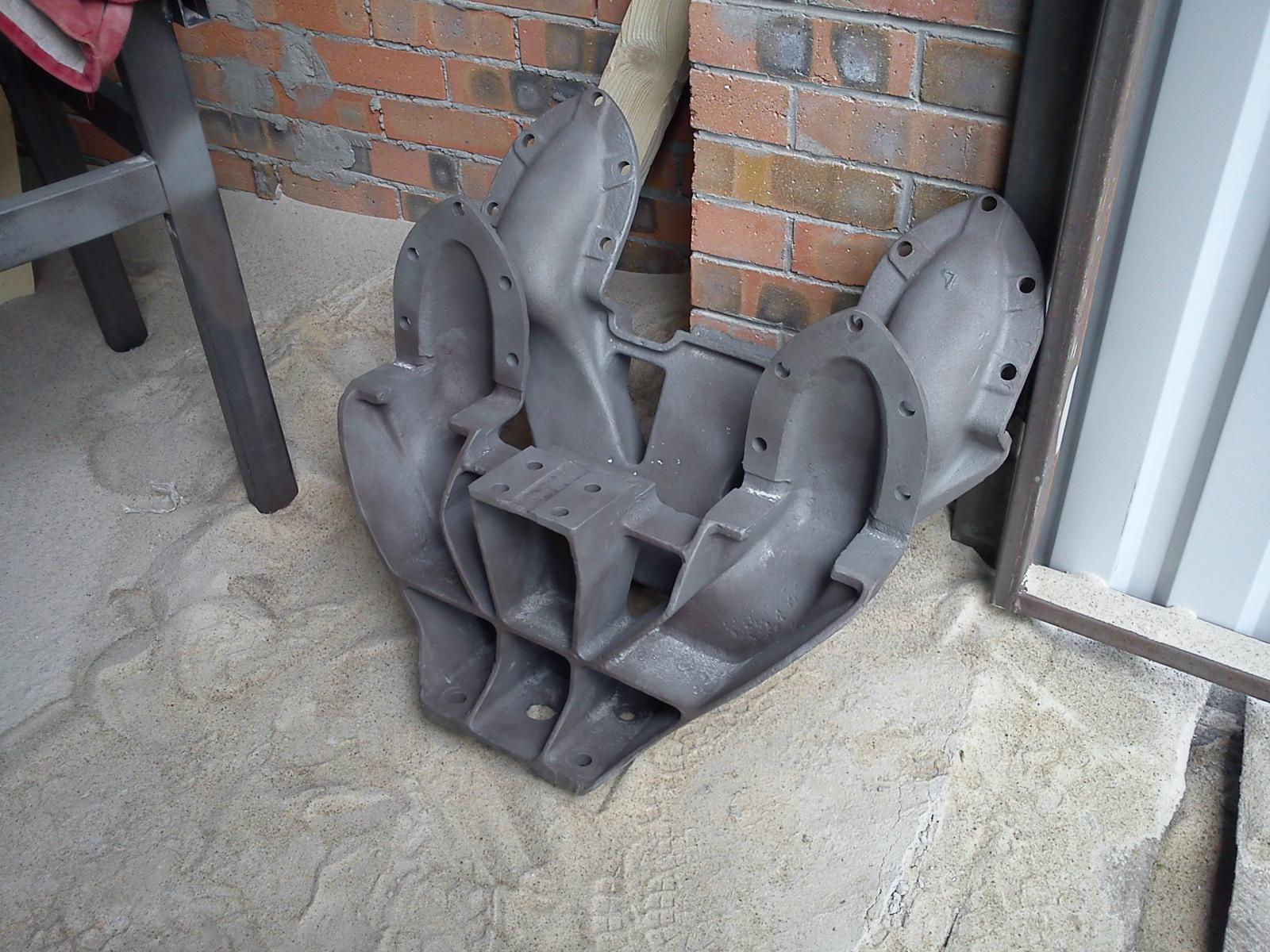

Hi Pawel,
You are doing a great job. I am a model builder too, and I also like to see accuracy under the cab n hood. I like to see correct chassis under the model. I have an Italeri Superliner but have'nt built it yet. I will be making proper Mack X-members and front chassis section based on Australian trucks.
Did you know that Australian built Superliner and Cruiseliner were built on the R model chassis. Mack also used the R model chassis for the CH and the Titan. The 1st CH's were CHR's Also around 1971 Mack Trucks Australia (MTA) started using the R model chassis for the F model, they were designated FR700.
Regarding the rear end in your model, I think it is a 1/25th scale 58-65,000lb representative. With the detail work you've done on the front carrier I think it is a pretty good 1/24th scale 44,000lb rear.
Jeff

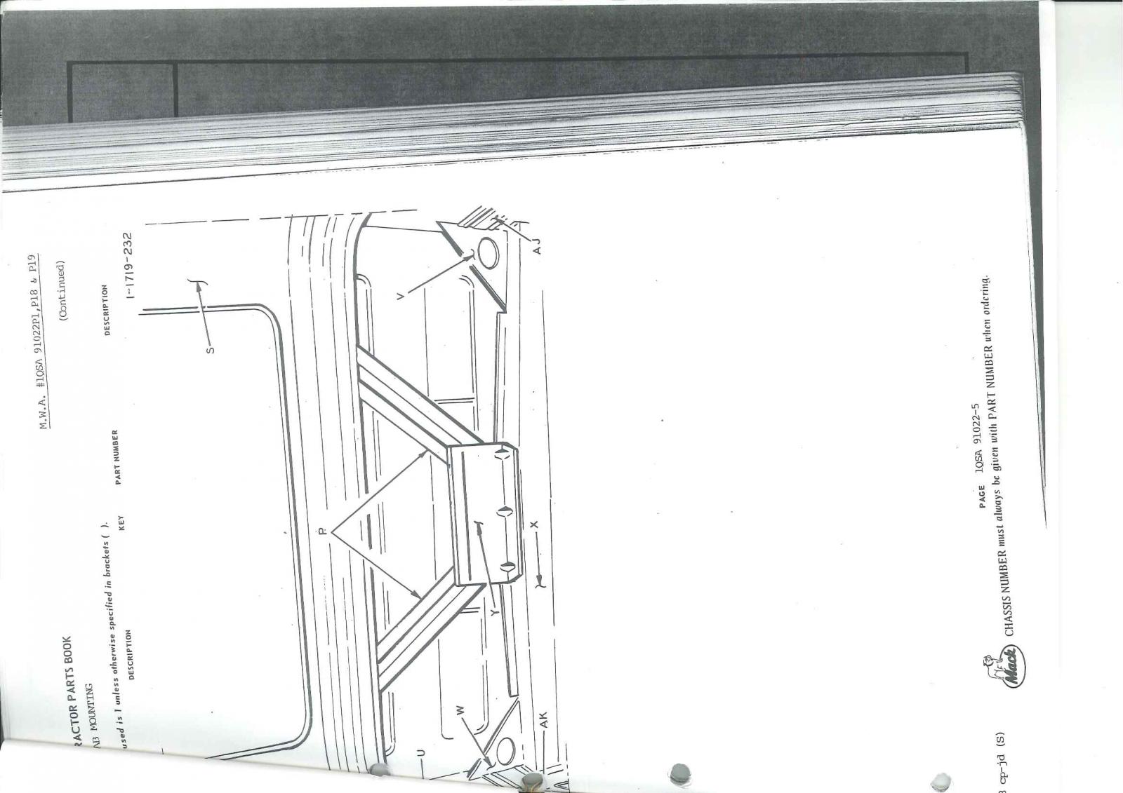

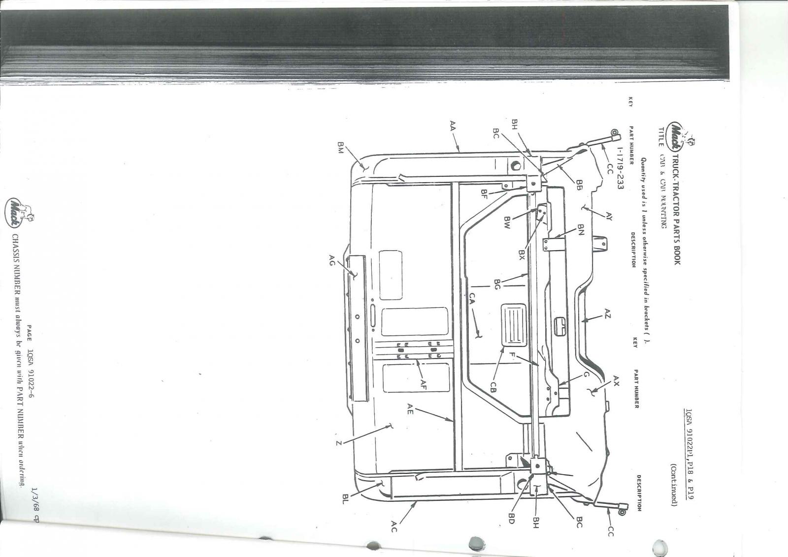

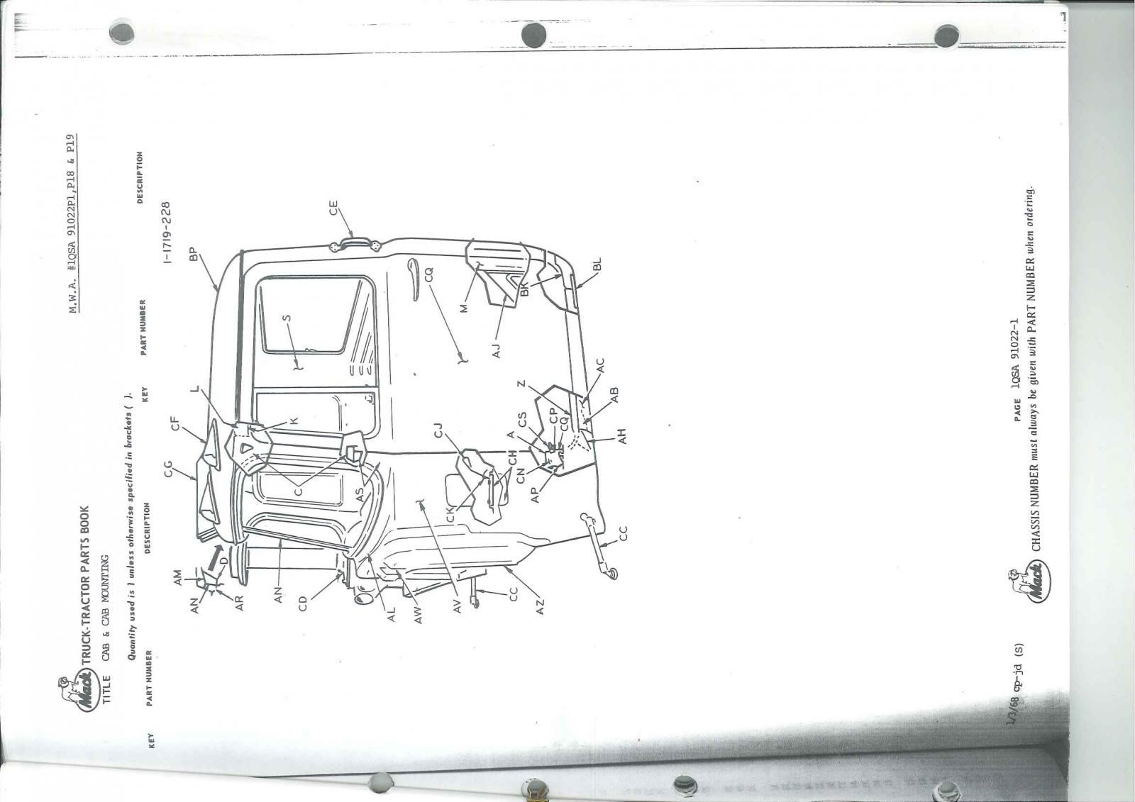

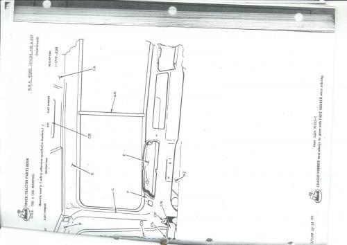

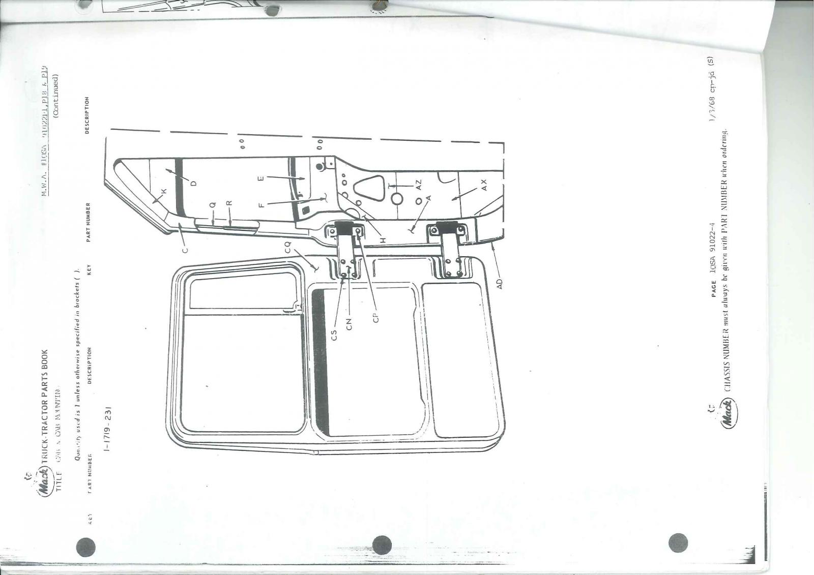

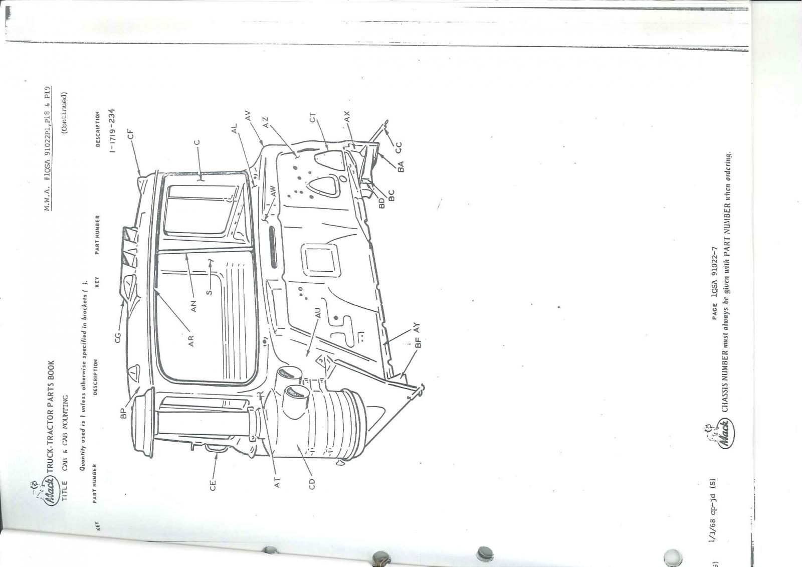

Hi Pawel,

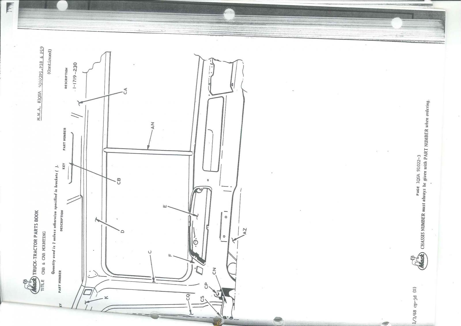

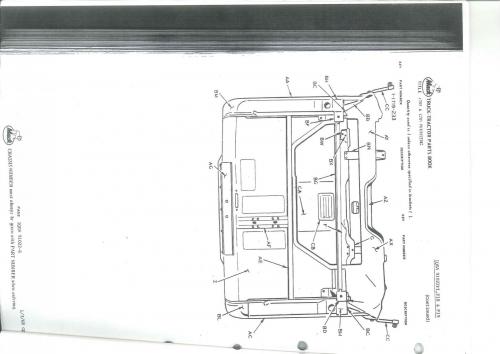

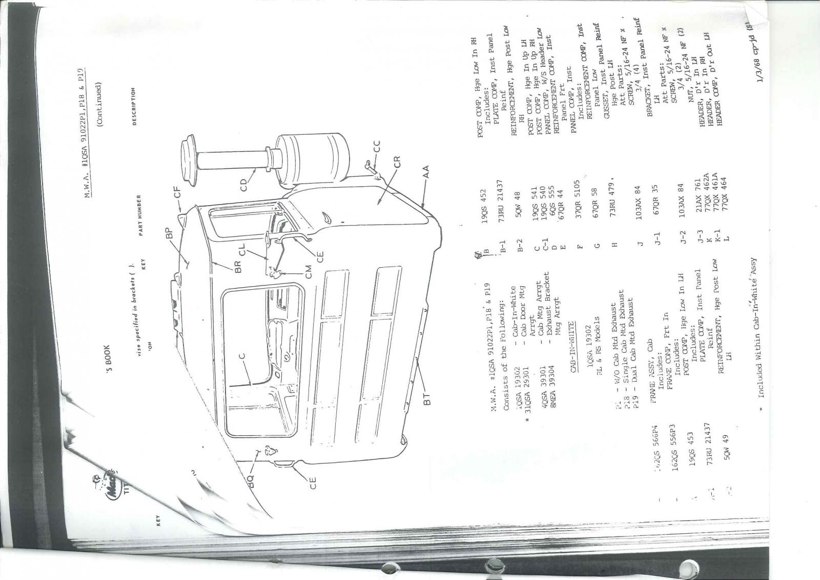

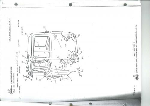

Frame looks absolutely superb. Like Jeff, I'm a stickler for getting things right as far as possible so I like to see the correct frame under a truck. I've seen pictures of a US spec Superliner with that heavy duty trunnion on it and the 80 brochure lists severe service options for the Superliner so I'm sure you can get away with it.

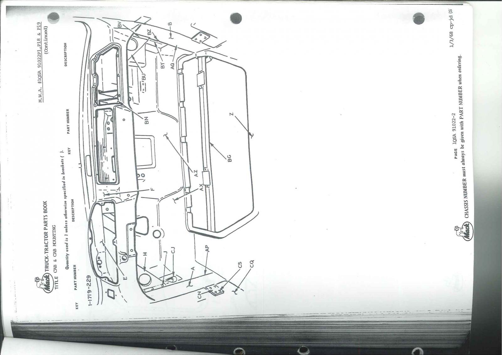

Regarding the parts book cab scans I mentioned in Vinny's cab off thread, I'll get around to it sometime over the next few days. The R cab is from an early RS700L parts book but I just realized that I also have some pages from an RW book though it's the 2nd gen. post 85 model. I'll scan some of that as well.
Alastair
Jeff, Alastair - thanks for your comments and for your kind words.
Jeff - I always wondered about the Aussie Macks, especially the Superliners - I've seen on the photos their frame is neither Superliner I nor Superliner II. Now you tell me it's an R-Model - thanks for the clarification.
Alastair - I look forward to seeing those pics, you can never get too much reference.
I see guys, we think alike. I mean I can't really understand modellers that put a lot of work in their truck models and the fact that they all have Freightliner chassis (like most of the Italeri models) doesn't bother them. Like one company that builds an F-Model cab and it says on thei web page "fits a generic Italeri US frame" - it's a joke. Likewise, the Italeri Superliner cab is also a cruel joke, unless you narrow it, that is. Be careful with that Italeri kit, it's full of errors and traps - I hope you can find some of them looking at this thread. Good luck with your projects and have a nice day
Paweł
