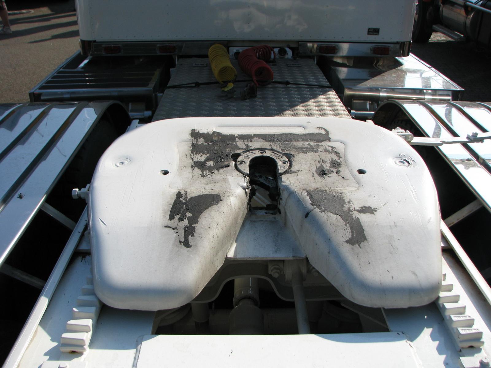

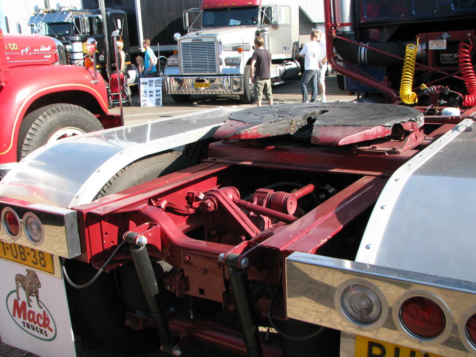

Well Pavel, I'm usually critical to models but starting to enjoy your work.
Too much grease of course although I like this fifth wheel. The springs are a bit bigger than they must be but it looks good at all.
To grease or not to grease ???
I'm thinking to make absolutely clean fifth wheel on my real truck.
As for a model, I prefer little dirty.
I thought to use epoxy with a black paint but haven't realized.
Here is a couple of images.

Vladislav, thanks a lot!
Yeah, most truck models are almost toys, I try to make mine a little more real. I wonder what do you mean by "absolutely clean fifth wheel" - will you be able to pull a trailer with it then? I used artist's oil paint for grease, works pretty good.
