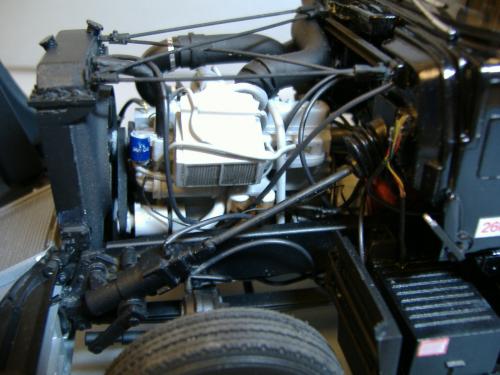

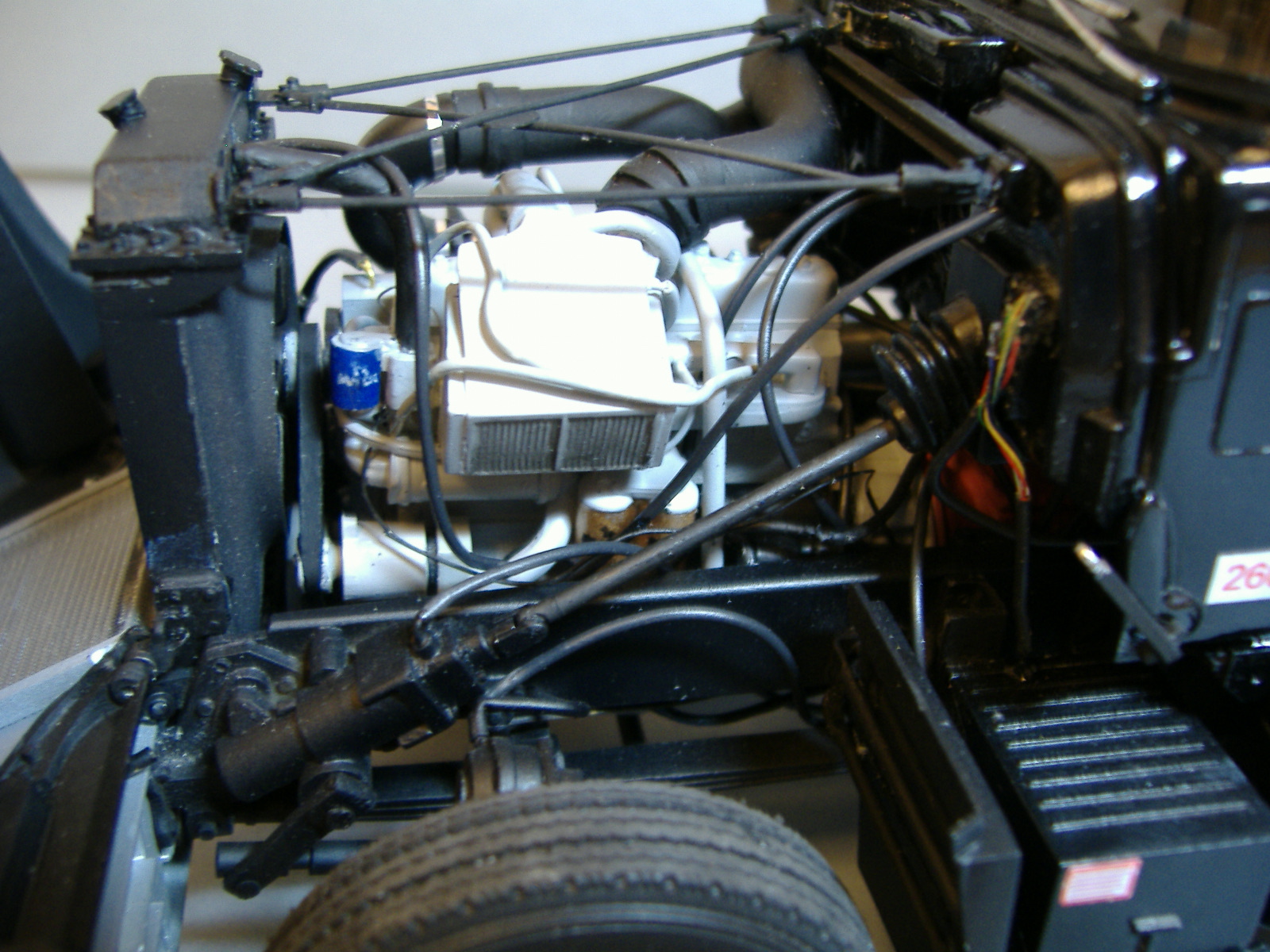

gearhead204 - thanks for your comment! I agree with you - those air brakes are no longer healthy... But then look at my baby - does that bulkhead look right without all that spaghetti? I say no. Would like to put at least SOMETHING there, but I know it won't look right before I understand the machine and what is going on there.

Question, why is the steering box mounted on the axle? I saw it in the first photo in your last post. Thanks Paul

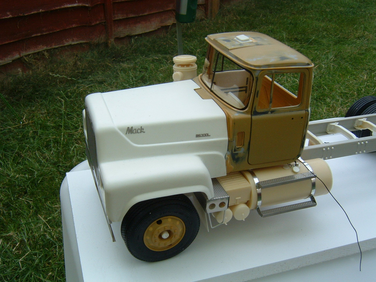

I've currently got 2 models on the go, an RS700L based on the Italeri kit you used and a valueliner based on the AMT R model kit.

Alastair - Thanks a lot for your kind words! That Italeri kit isn't going to help you a lot, unfortunately, it's a real pain... As for the plumbing - I'm with you here. Without it the truck just looks bare and incomplete. Are we talking frame, or also under the hood? The rear frame is relatively easy, under the hood you have a real jungle there, not only the brake system, but also the fuel lines, water lines, air conditioning, power steering and the wiring harness to top it off... Needs a lot of research. As for the brake system, I'll try to help you. But first, try to download the Bendix air brake catalog - it has lots of good info and also the drawings of all the valves, even with dimensions. Please get back to me after you take a look at that catalog, I'll try to tell you what I used.

Alastair - those models looks really good! That RS700L is going to be a smash! I'm glad I could help you with that bendix catalog. Thare's also a site called heavytruckparts.com - where you can buy used truck parts and thay have a lot of photos. Take a good look at Mack rear axle cutoffs - they are cut together with the ari lines and the photos show pretty well which line goes where, especially when you notice that almost all twin screw Macks are hooked up in a very similar way - R's, DM's, MR's.
The piping under the cab is more complicated. Like I still don't know where the quick release valve for the front axle sits in most Macks. The location I've shown in my model is copied from Neil's truck (thanks again, Neil!).
Anyhow, if you have specific questions, please post them, I'll try to answer if I can, and if I can't, well maybe our forum friends can. Thay helped me a lot many times already - thanks a lot for that!
