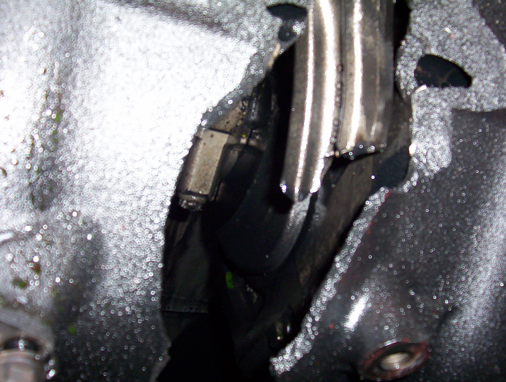

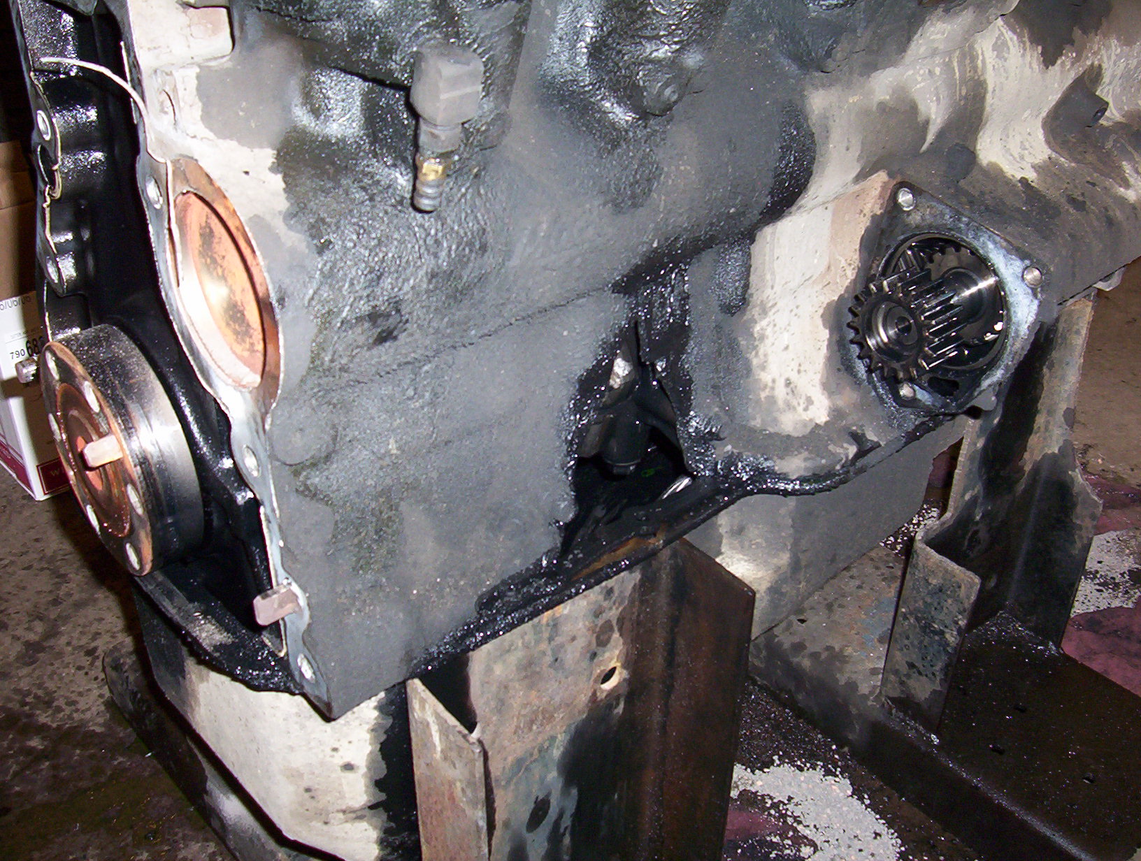

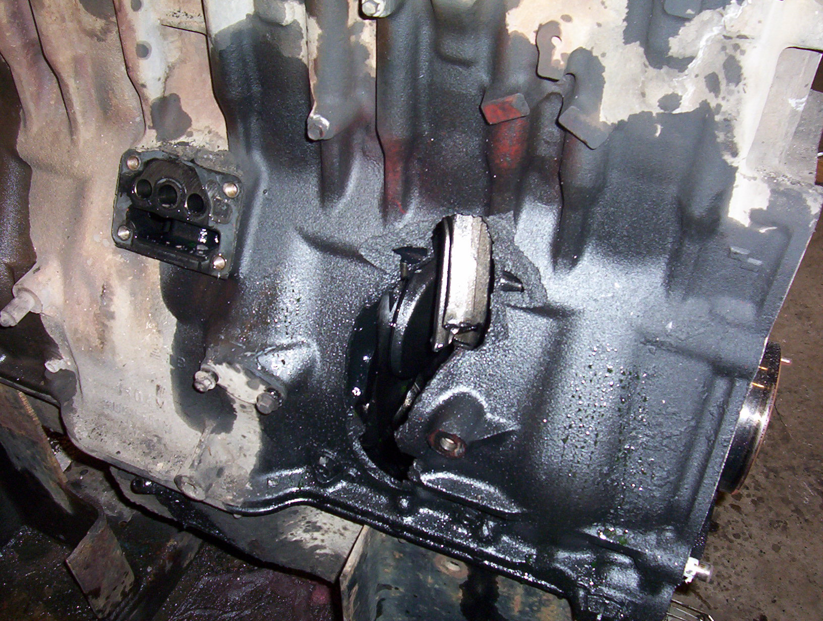

2005 Granite...looks like it dropped a valve and hell broke loose! The rod punched a hole through both sides of the block!
Good news is...the owner still has warranty coverage!

Not sure yet...we haven't even taken the valve covers off. Customer needs the truck fast so the main priority is getting the remaned basic engine put together and dropped in. We'll disect the core later.

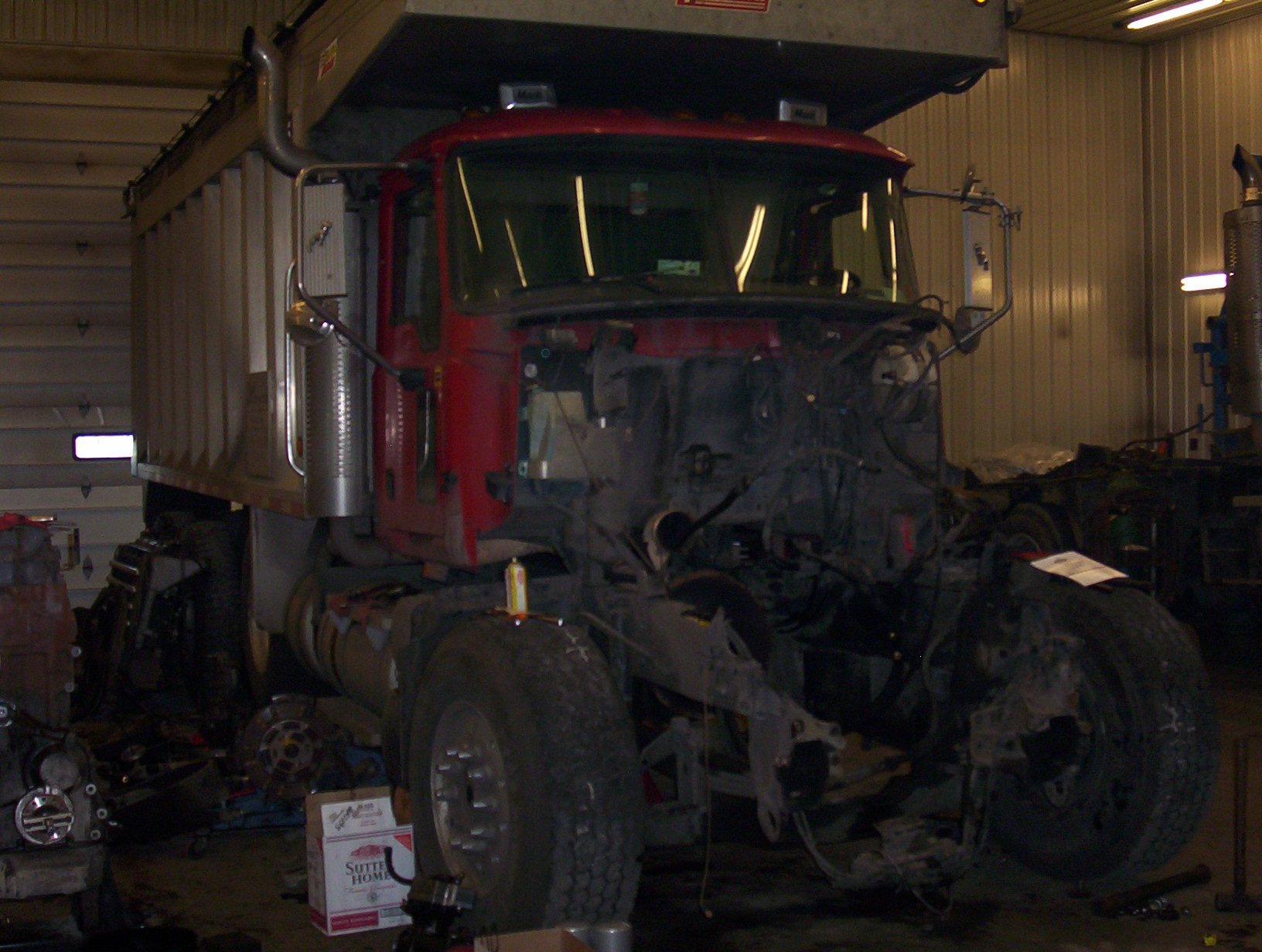

We had a '93 CH 613 with a 400 do that back in '98. It was coming of the highway into town on a downhill off-ramp. So I'm thinking it was an engine overspeed caused by an early downshift. We hooked on to it right away & got it to the yard before the air pressure ran down. Then used another truck's wet kick to dump the end-dump, dropped the trailer, and pulled it out of the way.
Had to get a used donor motor out of Texas. The independant mechanic we had do the work said that it was the cleanest engine swap he'd ever done. He was used to working on WAY older stuff...mostly Jimmy diesels - in farm trucks. he was plenty familiar with Mack's, as he had worked for years for an oilfeild trucking company, but this was his first experience with an electronis engine....piece of cake, he said. Took him 3 days...but he was all by himself, I figure, he did damn good. He swapped out the turbo and feul pump, cause we knoew what we had there.
