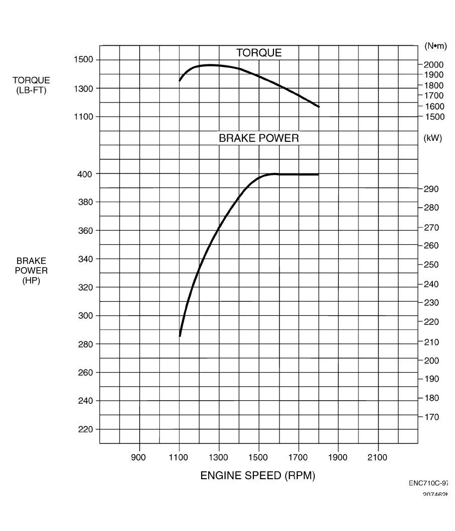

why the mack e-tech(v-mac3) has 1850 rpm normal full power governor with that engine ,after 1850 rpm the ecu decel fuel power to 2100 rpm,(lose around 70% power)
do you know if are possible get full power has 2100 rpm!!!

We have tried to get the rpm up over 1950 while the truck is moving but was never able to. On most ETECH engines the HP curve starts to drop very fast after 1850 rpm. We tried changing tire size and transmission top gear ratio to try to fool the ECM into thinking we were in a lower gear. The ETECH engine will usually go to 2100 in every gear but the last one where 1900-1950 rpm is the max. The only ETECH I have seen that would almost hit 2000 in the last gear was a 1999 CL with a 460XT program in it. If you do get it to that rpm i dont think there will be any HP or torque there to do anything with.

but the cummins and CAT and other compagny keep full HP around 2100 rpm!!but the E-7 e-tech get full hp 1850 rpm and 1900 rpm + the HP drop around 70% , impossible get full tholle (2100 rpm) dowm hill.....
it very negatiF point for mack e-tech.....all idea are welcome...

Cat, cummins and other engines usually have alot more cubic inches/liters (and weight) than Mack's Etech engines so it could be easier for them to build HP at a higher rpm's. As far as turning up the RPM's or adjusting the power curve, it's impossible from what I'v seen. Unless you know a program writer that cam make a complete new engine data file. We use the older Mack service software on the ETECHs and ASETs. We also have VCADS but have found the older Mack service software is much faster and easier to use. Not much difference in what parameters can be changed using VCADS or the Mack service software on the ETECH's. Alot of fleets turn the rpms down to 1900 because anything above that your just wasting fuel.
