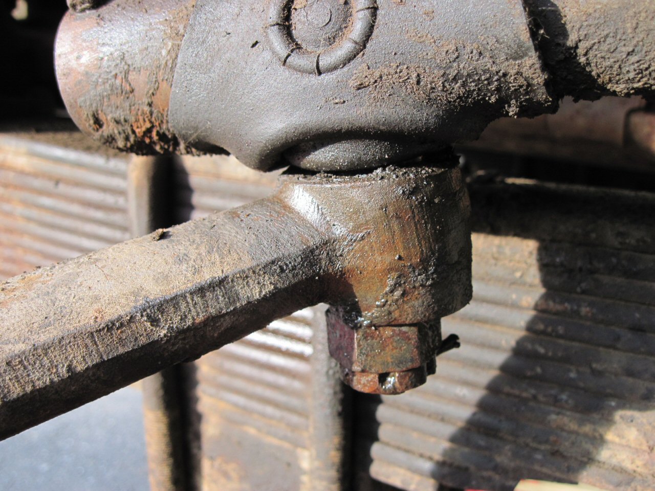

Got close! Didn't work THAT hard at it today, but I am within a cotter key of getting one side off...king pin came loose easily, thought backing plate would be a pain but it wasn't....this cotter pin may be a different story...the round end of the pin and the slot in the nut are one with rust, I cant get anything in there to grab it...been spraying with pentrant and tapping lightly...will come up with a new plan tomorrow...

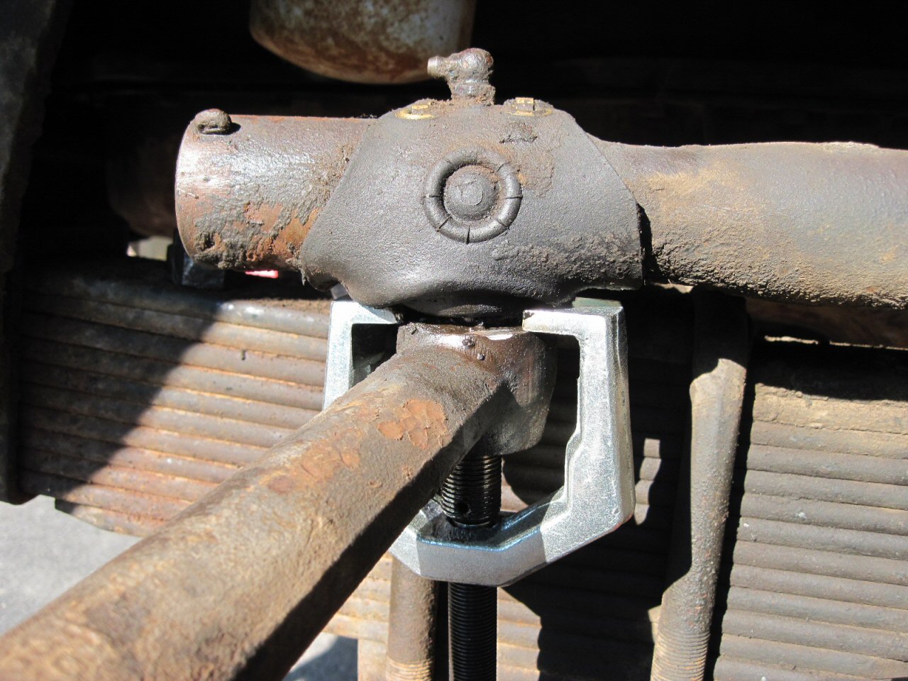

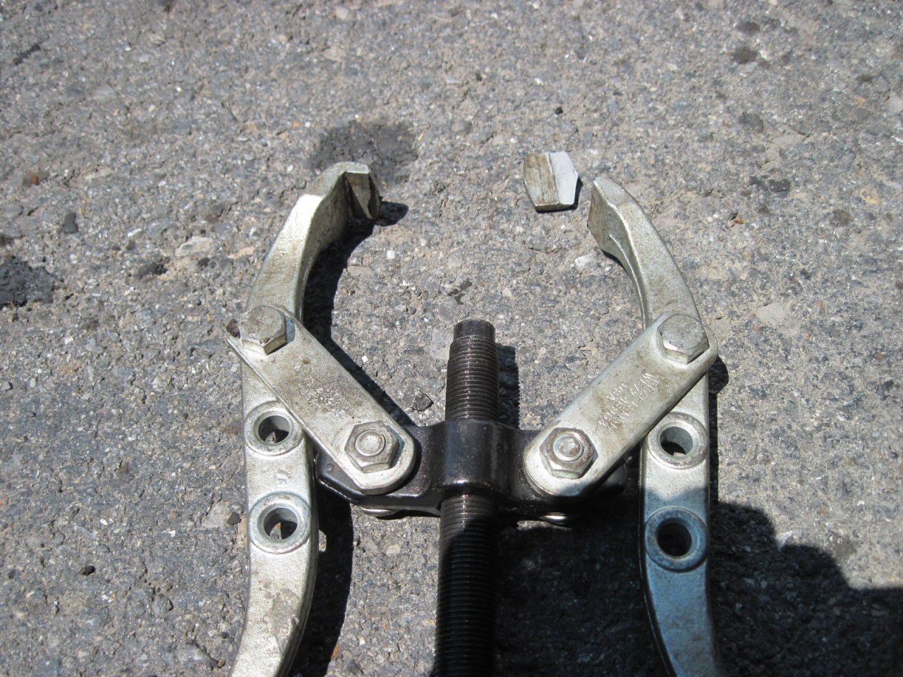

probably my fault becaue it is not the right tool for the job...got the cotter pin out in several peices...thought I was making progress! Busted my puller tryuing to get the joint separated...spindle not off yet...

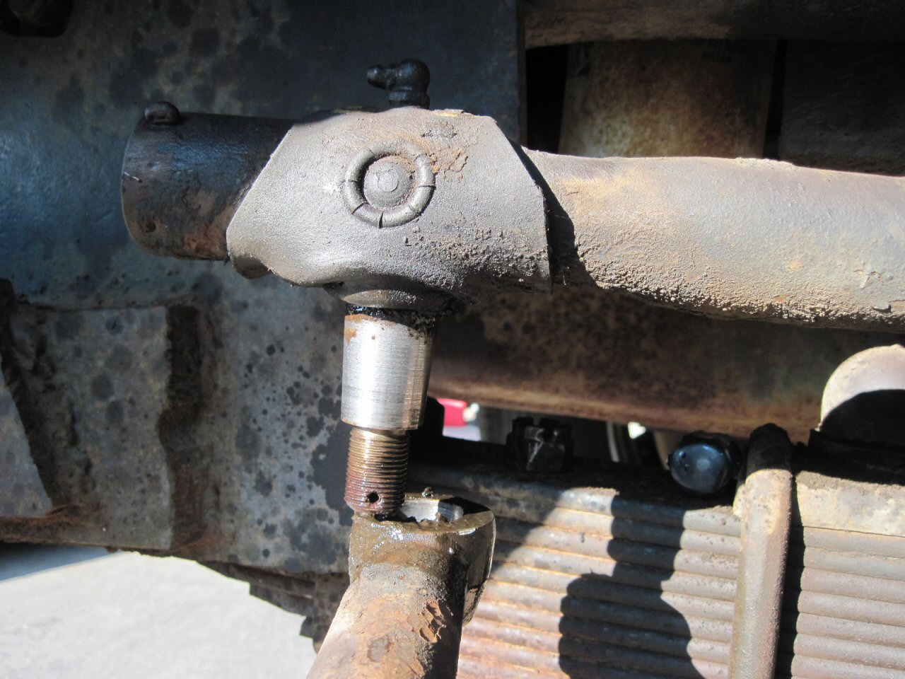

Bought a new puller, cheapo (all I could get today and worth a try), thought I would break it...and viola! Success! Now on the next issue, the top of the spindle has the needle bearings, I dont think my Kaiser Qwick kit is going to work! Anyhow, finishing up for today...it is our wedding anniversary, gotta take "momma" out to dinner...
