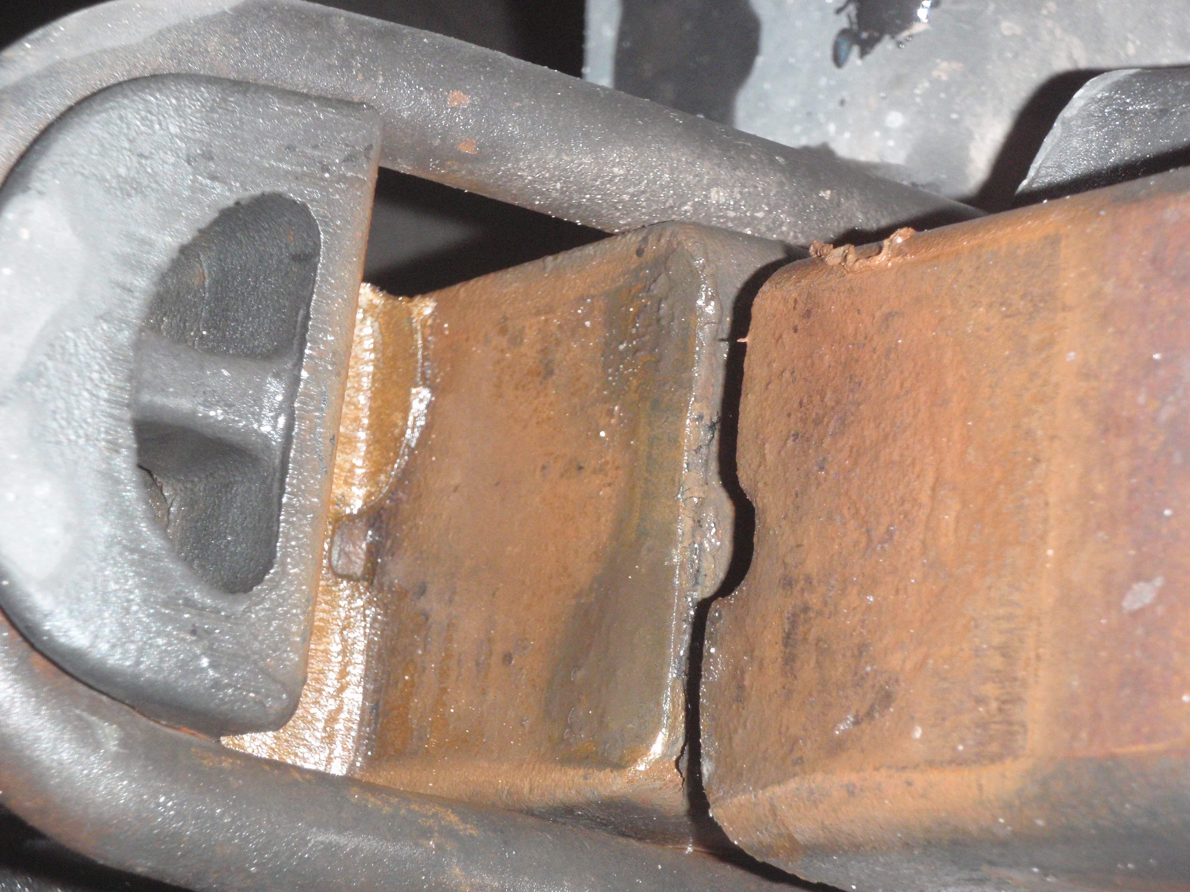

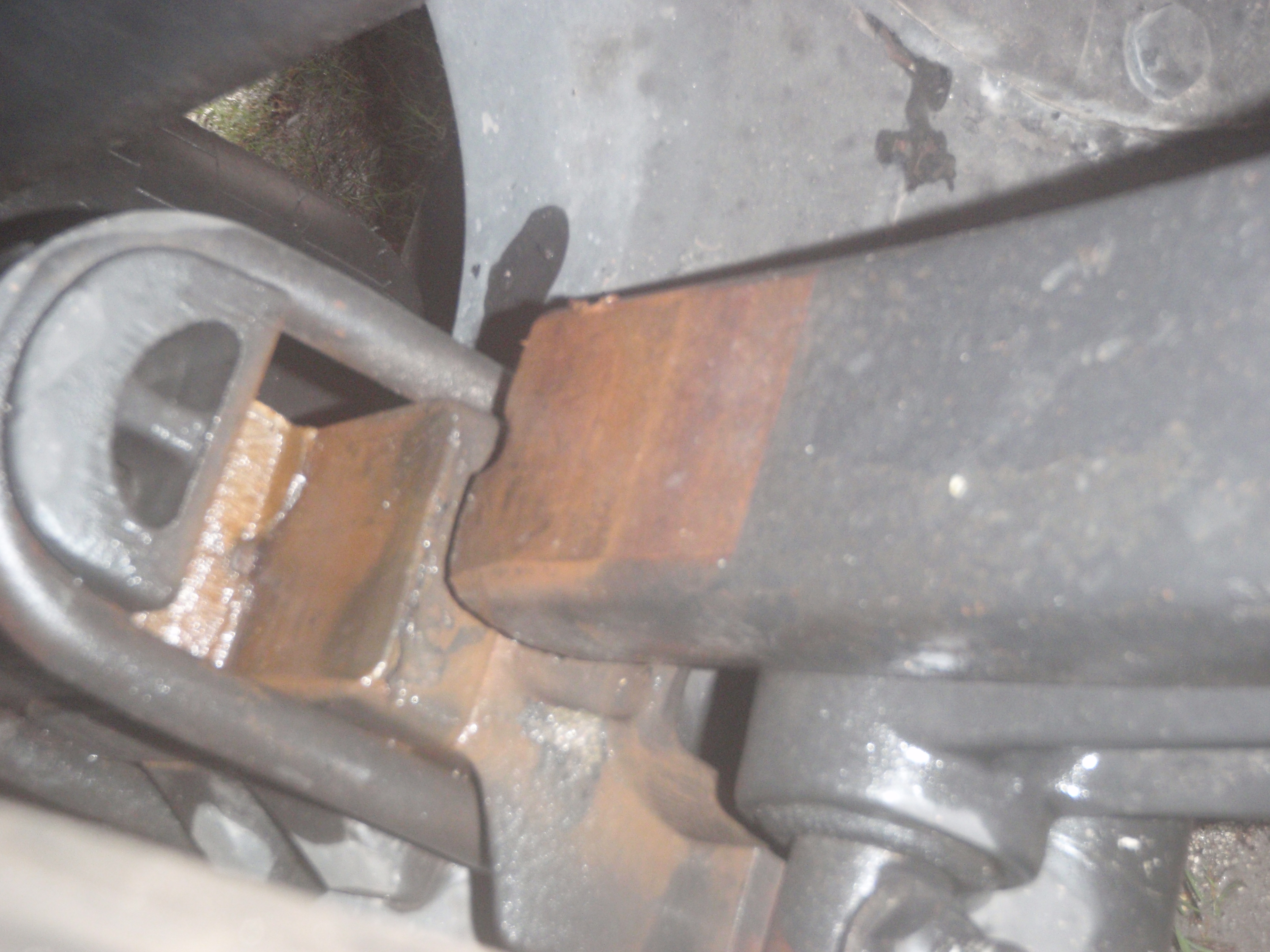

Noticed that I was slightly spinning the D side when making a left turn. Had a little weight on board, maybe not centered.
Was happening even empty. Appered the body was leaning some. Watch air pressure on turns and bumps, maybe a broken air spring.
Got to a place to pull off and walk around. look what I found

Ouch! IS that sheared right off? All you need is one little crack.
yep. 1st pic, that should be all the way back, under the u-bolt piece.
Think its called a Z bar or something like that
