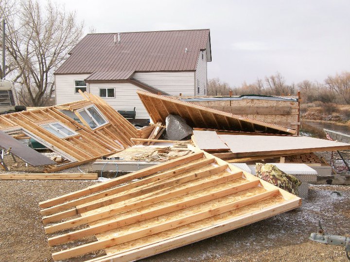

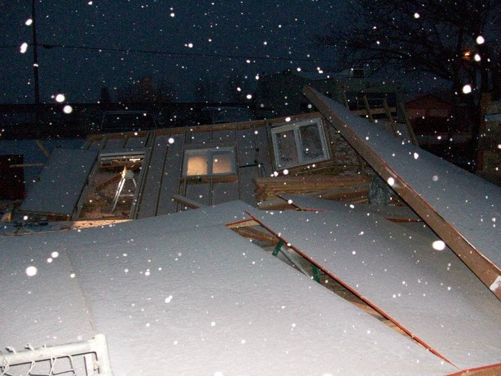

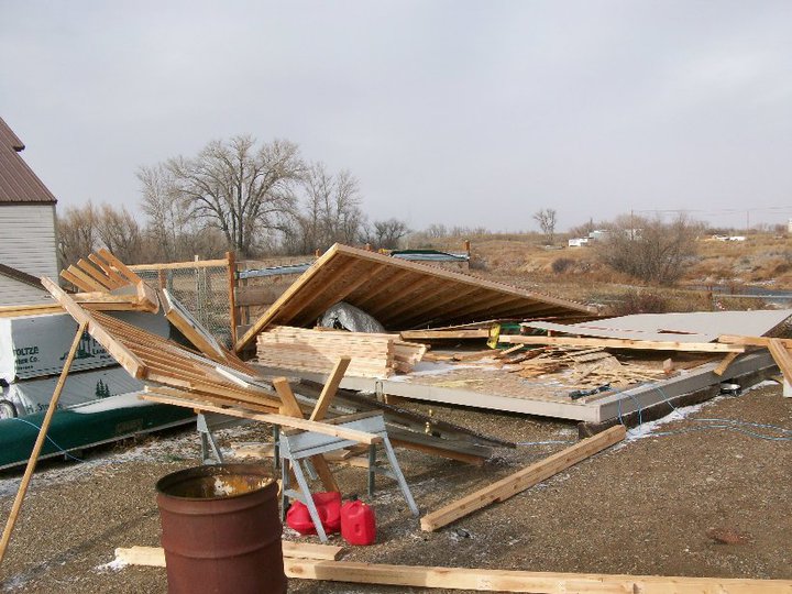

Just about have all of my trusses built for my little shed. Will have them finished after lunch. Then I can try to put the shed again, last year all the shed walls were up sheeted and braced when a huge windstorm hit and leveled it. Hope it goes better this year.

Don't feel too bad...there is a building up in Sesser that was being constructed by "professionals"....had it beautifully framed...trusses for the roof in place....
Storm done blowed it down, too.
When I get ready to build any outbuildings 'round here, I'm building 'em as pole barns. Sink them poles in the ground and build around 'em. Just seems sturdier than the house of cards some of these buildings seem to be.

It would never pass but the use of "hurricane clips" in the trusses and plates, with screws instead of nails in the home's structural members would help tremendously for moderate storms to control, or lessen damage.
A discount or break in the cost for homeowners insurance premiums would contribute to their usage.

I hate when that happens.
Hurricane straps work quite well. Just be sure you tie down the walls.

Yeah he sure huffed and puffed a lot that day :pat: , then shortly after that a nasty snow storm from Canada blew in and put about a foot of snow on everything to top everything off. According to the adjuster weather stations surrounding our area recorded 75+mph gusts that day. I guess I needed the practice.
