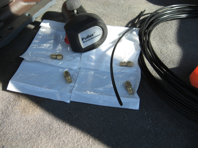

Tonight I was building up my new transmission to slip back into the winch truck this weekend. I noticed when attempting to run the air plumbing the air line fittings on the new trans are 5/32nds, where the former was 1/8th. I have a new NOS 4900 shift knob I plan to use and it is threaded for the 1/8 plastic lines. I can remove the brass fittings from the former transmission and swap them without problem as the threads are the same, (1/8th-27npt), or adapt the shift knob for larger lines.
Do I need the higher airflow to facilitate the range and splitter functions faster than the 1/8th plastic line can supply? If not why was the change made? I'm making the broad assumption the change was to hasten the time for mechanical operation of the aforementioned items.

Well I decided to purchase new fittings for the 4900 series shift knob in the 5/32nds size to fit the existing fittings on the trans. Bought 50 ft. of the air line so that ought to cover it with a little left over.

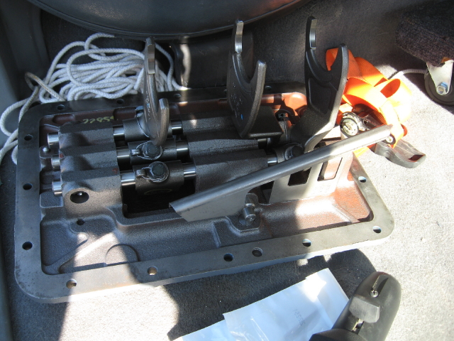

The left over top shift cover for the RTO series of trans will be kept as it is all new including forks, rails, and all hardware. I'll use it in another trans.
