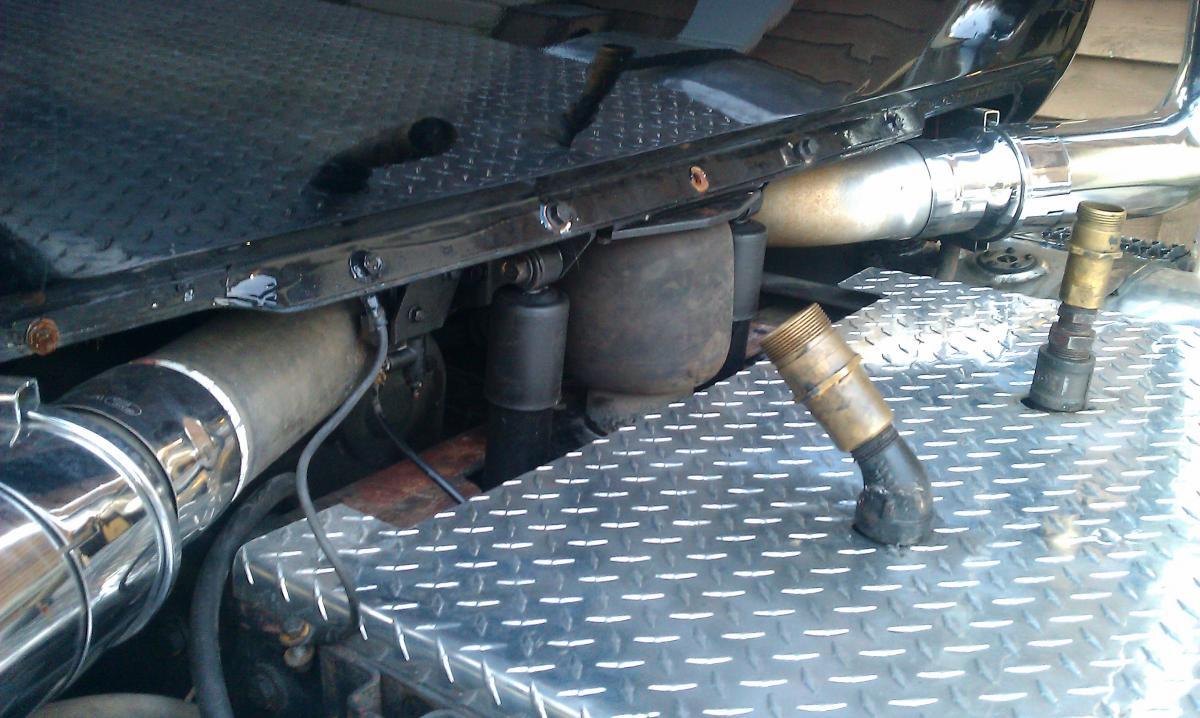

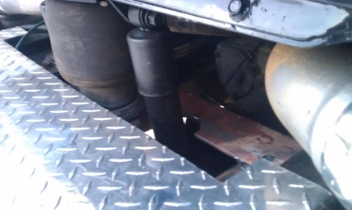

I installed the superliner air ride cab setup today. I used the old frame perches that held the stock arch bar. Made a beam to hold the back of the lower air bag plate. Then bolted a L brace to the frame crossmember to capture the other end of the plate. The upper part of the air bag bracket simply bolts to the bottom of the cab.ran new air lines and set the leveling valve to my liking....8 hrs later and she is a much smoother ride. No more bucking or violent shaking when you go over a bridge. Bobtailing is not a nightmare anymore. The old cab brace was cracked in 3 spots. 4of the 8 bolts snapped off with little force when trying to remove them 2 of the 8 were already sheared off . The frame crossmember in that location was also cracked near the frame bolts...that's how nice she rode LOL..... I just need to fab up to radiator stays and remove the x brace..

wow,nice neat job,,what did you do for front of cab?know what you mean about youth,,was driving all beaters,in my twenties,and thirties...too old now,,our work trucks have air suspention,,thier ok,,but think the air cab is better.bob :loldude:

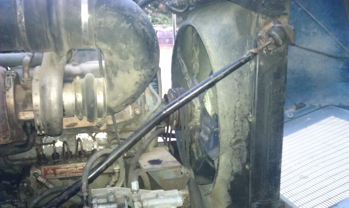

I took a set a radiator support rods off a valueliner that is heading for scrap. The rods bolt to the frame rail and capture the radiator sides using a L bracket that is welded to the radiator cage. All I had to do cut and weld L brackets to the radiator cage and drill holes in then so the support rods could run through them. Then I removed the factory X brace that held the radiator to the firewall. Last to do is install the hood rollers to the firewall so the hood and cowl don't rub..I took the truck out last night with the stock X brace and she rode good but you could still hear and feel vibrations. Tonight I removed the X brace and Omg did she quiet down. All in all this was an easy install just a lot of test fitting under the truck..
