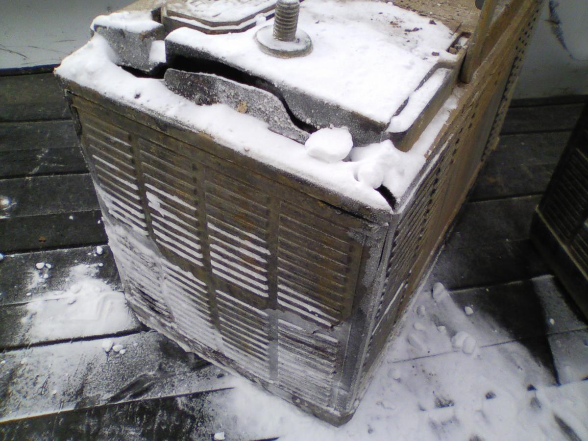

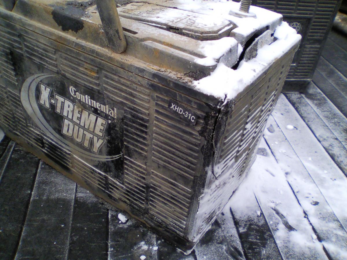

So I stopped for fuel this morning, shut the truck off, and filled up just as I do once or twice every day I run the truck. After paying for the fuel, I turn the key to fire it back up and as soon as the starter engages, there was a loud explosion. It sounded like someone shot off a 10 gauge shotgun right under the cab.
I released the key and removed it from the ignition before climbing out to investigate what went wrong.
The liquid pouring out of my battery box was a pretty good clue what had happened.
I got lucky...nothing MAJOR....only one battery self-destructed in a most spectacular fashion.
So, I disconnected the one that blew up and ran the rest of the day on the remaining 2 batteries.

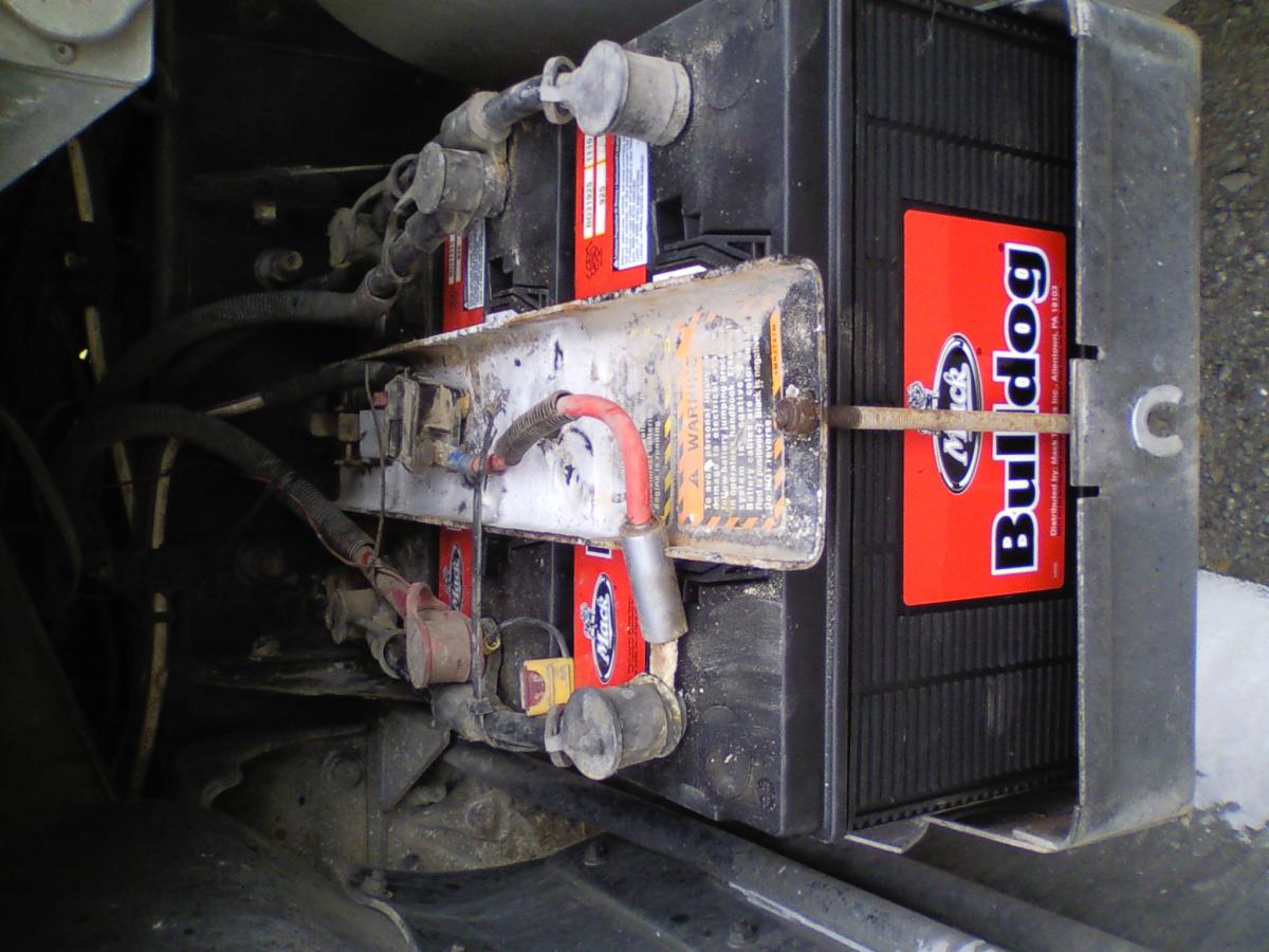

Just got done swapping out all 3 for some brand new Mack batteries. The ones that were in there were bought 3/28/2010....Continental "X-Treme Duty" (XHD-31C)
The white powder in the pics is baking soda...wanted to neutralize the acid. Spread quite a bit of it in the battery box, too. ;)

I wasn't sure WHAT had happened...first thought was the engine seized up right as the fuel ignited and blew the side out of the block or something like that. I sure was glad to see it was JUST a battery. I probably could have got by with just replacing the one that exploded...but after this happened, I don't trust the other two (same brand, bought the same day, from the same store) and just wanted them out of the truck.
Great thing about where I live is the local Mack dealer has to drive past my house any time they go to one of their other locations....so my new batteries were waiting for me at home when I got there. Not sure if they made a special trip or if they made the drop en route to somewhere else....all I know is they take good care of me. I mean heck, if I had to get home and then run to town to pick 'em up, I would have been cutting it REAL close to closing time...and by the time I got back home to swap 'em out, it'd be dark.

If you ever read instructions that accompany booster cables they always state to connect the cables to the depleted source first, and the boosting source second. This is due to sudden inrush of current and rapid heating of the cell plates within the depleted batteries upon connection. The battery that exploded had a partial internal short causing the same thing with catastophic results.
Lucky the battery box was covered.
