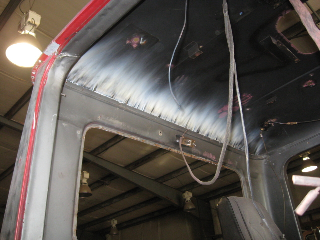

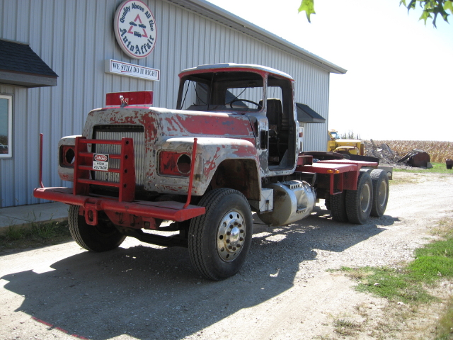

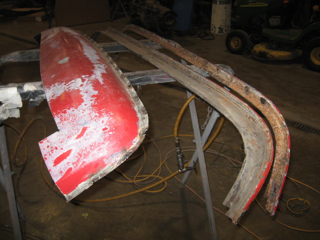

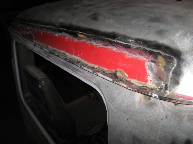

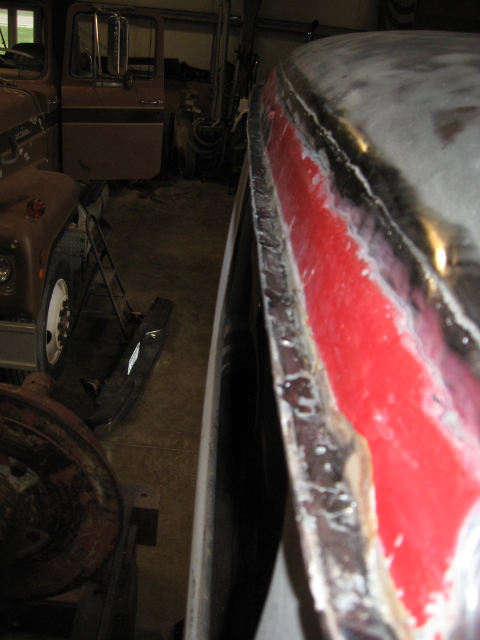

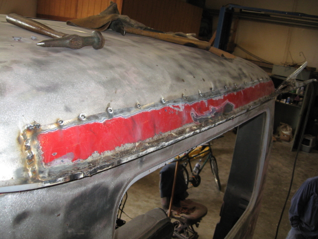

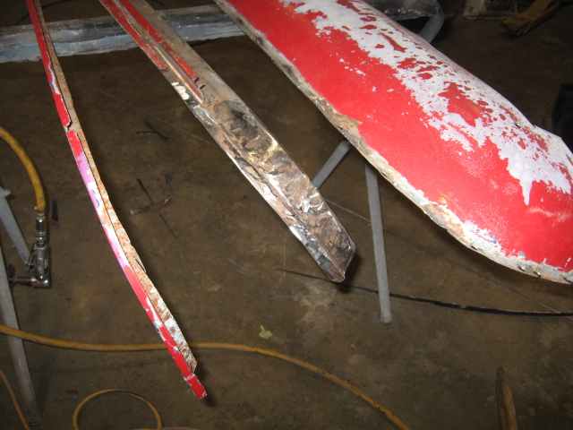

Dragged this old girl out of her sleeping stall. Figured we'd get a little done of the roof since it was so nice today. post-78-0-63147800-1316321053_thumb.jpg

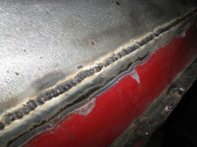

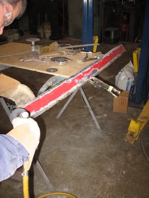

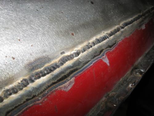

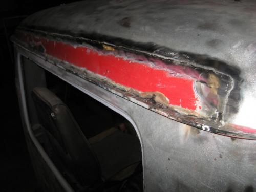

Stitched in about 18 inches of rain gutter, and a four foot section of a donor roof skin from a spare cab that is junk. The welding of galvanized steel it terrible smelling.
post-78-0-75318700-1316320910_thumb.jpgpost-78-0-43877400-1316320996_thumb.jpgpost-78-0-01185800-1316321126_thumb.jpgpost-78-0-61645900-1316321198_thumb.jpgpost-78-0-57241300-1316321251_thumb.jpgpost-78-0-15173700-1316321512_thumb.jpgpost-78-0-59658700-1316322888_thumb.jpgpost-78-0-25075900-1316322897_thumb.jpg

Hey Rob,while on the subject of welding,i was wondering if you have ever used "kleekos" i am going to replace the rockers/cab corners on my pickup this winter,and they seem like a good idea,but i have never used them and just wondered if worth the trouble,thoughts?................Mark
I've used them a lot with aluminum and sheet steel that will be retained with rivets if relatively flat in contour. Cleco fasteners don't have enough spring tension in them to really "pull down" a panel with a high crown. When patching such as this, I usually use #8 Tek screws and weld up the holes afterward.
Rob
Rob
That was pretty much what i was thinking,as little welding as i do anymore just an un-needed expense. I just really thought might be usefull to free up an extra hand,but when replacing rockers i guess the old "tried and true" method works best for me (tack/vise-grips)............Mark
