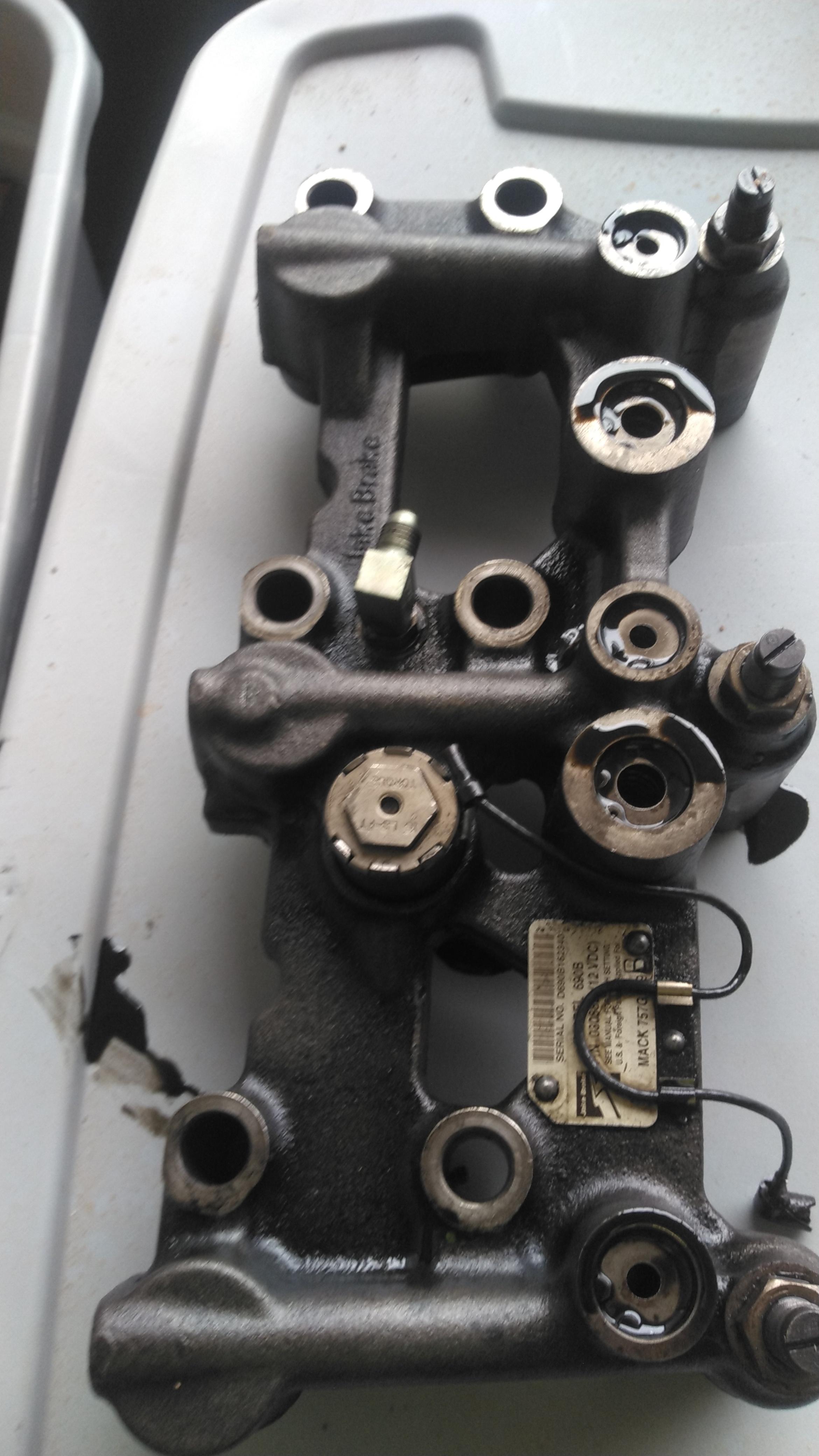

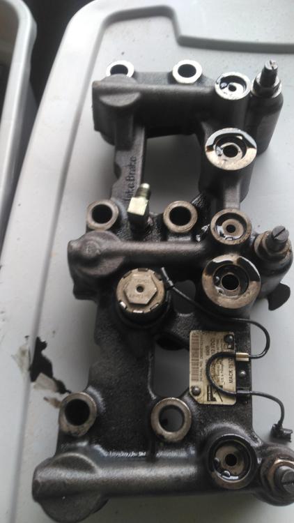

i wish i could see it...  my other question, was about small braided oil lines going through the spacer to the top of the engine brake housing.  any way....  oil will squirt from the top of the celenoids,, if it is coming out anywhere else, that will cause poor performance. if you have a leak, get the oring packs and replace them.  jojo
ok.  the update was not done..  if oil is squirting out around the bottom of the celenoid, it sounds like they are loose and or the orings failed..  jojo
grab a 3/4" wrench and remove one of the celenoids.. there should be a green oring around it and a smaller white one, in the base, both are square cut o-rings..  replace those and test it again..  jojo

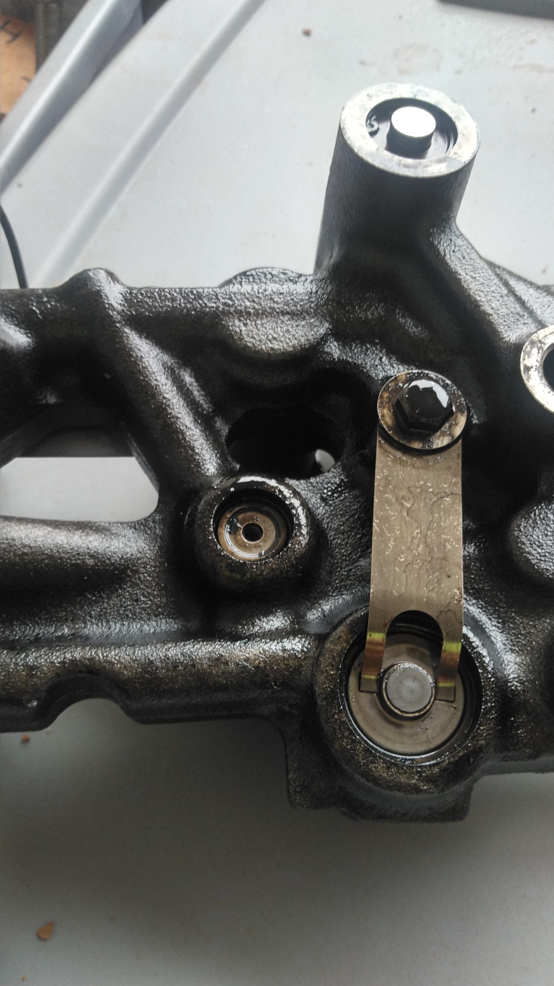

ok.. i understand better..  that is normal.  when looking at the tops of the celenoids, do you see the little round pin sticking up out of the hole, ever so slightly? both should look that way.  if not, the celenoid is weak. also when you jump power to them they should click pretty firmly,,  you can come of the alternator with a wire and 2 alligator clips to make a tester..  in one of the pictures, there is a 90 degree fitting in the jake head,, that is part of the performance update that is NOT done to yours..  jojo
