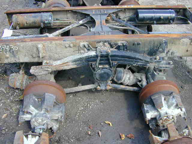

M-ride is Volvos T-ride suspension, they just changed the first letter in the name to try to fool us. Its similar to camelback in the sense that its a center point parabolic spring suspension, though its a 6 rod setup. It is a 2 stage type so the springs have rubber cushions on them to make the ride smoother when unloaded. Its similar to the tuf-track from Freightliner. The only thing I don't know yet is if its available with Mack axles or just Rockwell/Dana-Spicer axles.
Here is a pic, you can see the cushion between the springs and the axle:

I also wonder how it compares in the suspension weight itself. If it is lighter AND cheaper it could spell trouble for camelback. Plus the smoother ride provided by the rubber cushions could entice buyers too.

thanks for the pic thad, i thought it might be that T ride junk. boy does that suspension look expensive to rebuild with all those torque rods. I dont think yyou will ever see the elimination of camelback and i dont think any one whos going to buy a mack is going to buy that junk but then again I see some macks specked on hendrikson walking beam (one of the worst in my opinion). Its just anouther option in the catalog i guess
We have two volvos at work with that style suspension and both trucks have come in with broken springs. The one is only a year old and has already broken a spring on one side and the other truck broke all 3 on one side. I do have to say they are nice and easy to change. The 3 springs are somewhere in the neighboorhood of 500 bucks if i can remeber right, when an 11 stack camelback is like 440 dollars in my area so the price isnt far off.

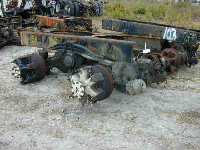

This is a CAMELBACK Suspension set-up that its on a 2009 MACK GRANITE Truck that our local MACK TRUCKS INC Dealer (M.A Caribbean) put on display at our 2008 DIESEL NATIONALS.
