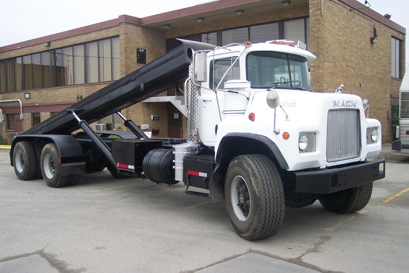

Here is a picture of the old beast. It actually had the cab replaced from a mid 80's truck. Cement truck, so no rust. Trouble is the guys that swapped the cab were hacks and the wiring was a mess. I have most of it fixed now. I just have to tie up anything loose and weld two cracks in the rear cross members. Not big cracks, but it needs to be done properly.
Now if I could just get the reverse lights working...
BTW it is a 1976
