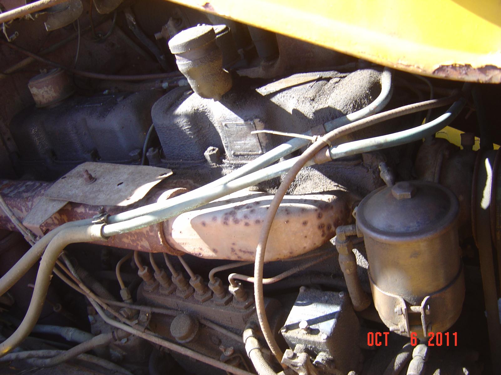

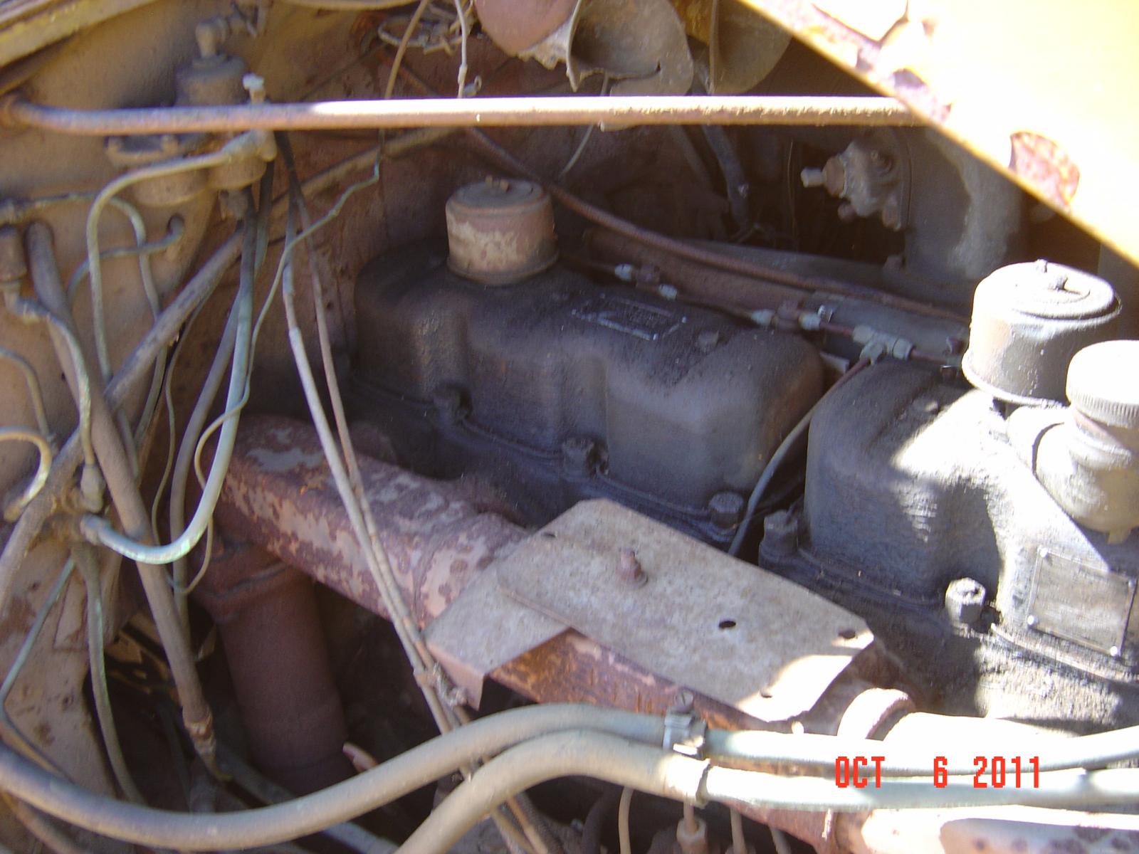

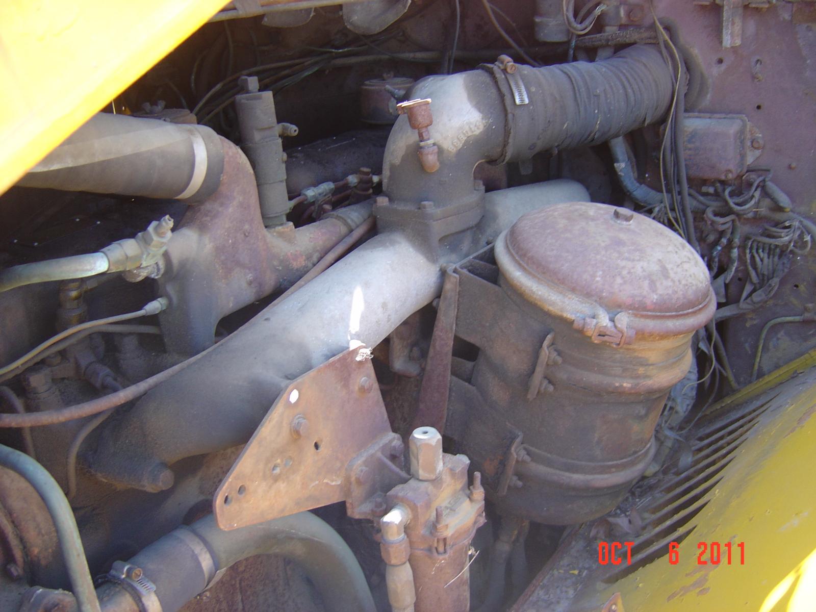

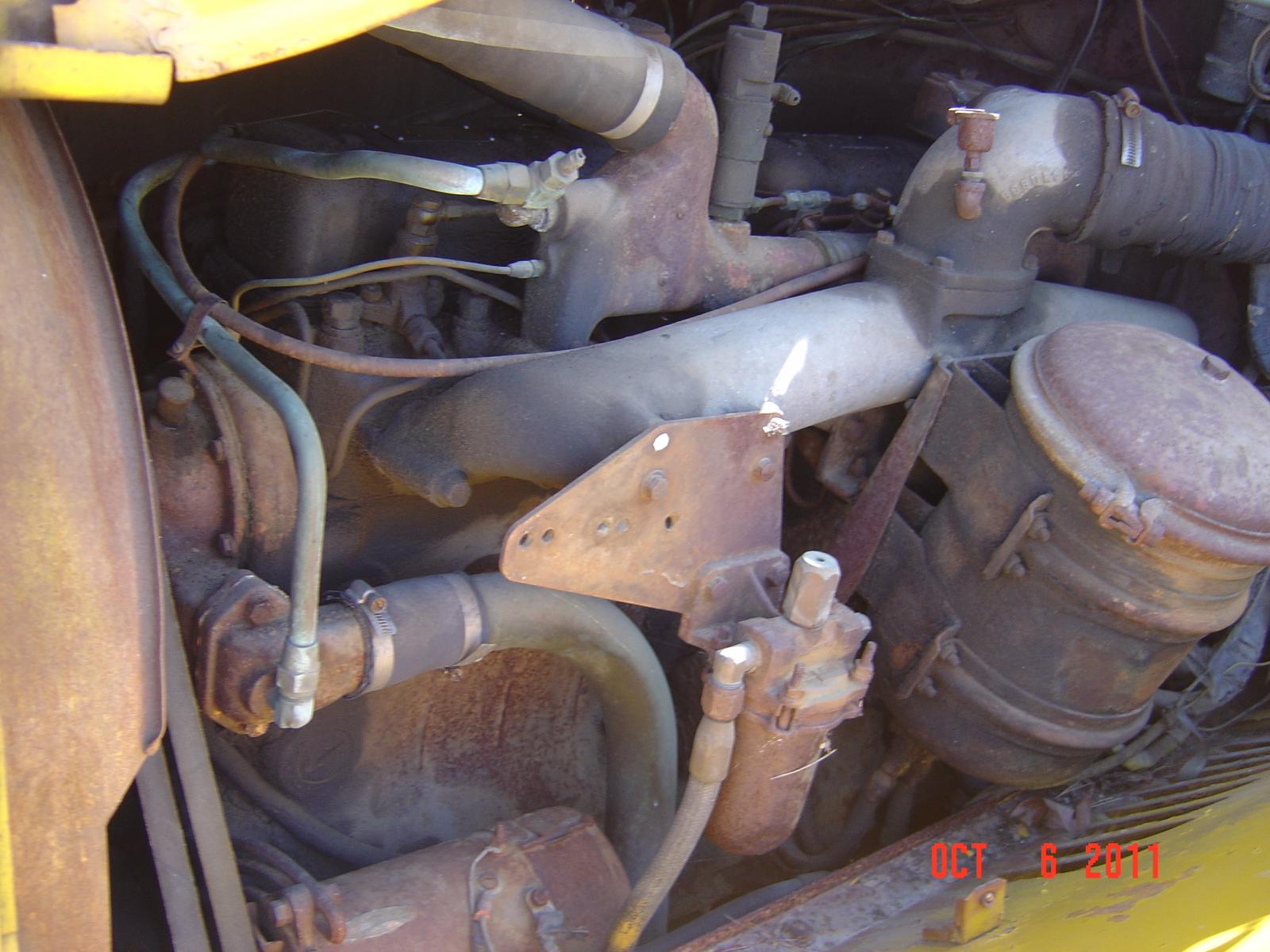

I got the 51 LJT home this weekend and checked the engine serial number. It should be a Lanova but the serial number is END 673 164 93. Shouldn't a Lanova be an END 672? I bought the truck from the second owners son who swears the motor is original. I found some records in the truck showing the heads where swapped in 63 or 64 with 90k miles so I dought the motor was changed before it came to the previous owner. Any help would be appreciated.
That appears to be as you suspect an END-673 Mack diesel engine. First natural aspirated one I've seen with a Woodward hydraulic governor however.
I've seen a few END-672 engines and they look pretty much the same to me as an END-673.
All the Lanova engines I've seen are an END-510.

Thanks. Where the 672's marked as 672 or 673? The motor does say Thermodyne on the valve cover.
The END-672 engines were stamped just like the END-673 series. From what I've seen in the exact place of the timing covers housing.
Lanova's were the first mack engines from the 30's. There was a 510 and 672 motor. I don't know anything about the 510 but the 672 had indirect injection rated at 150HP. When they upgraded the motor in 53 it got direct injection and became known as END-673. probably a few other small differences also.
On the END-510 engine the injectors were side mounted like a 220 Cummins. They injected fuel into a precombustion chamber that was the patented "Lanova" design. I have heard the END-672 engine was similar but as I've said it looked very similar to an END-673 to me. Can't say I paid too much attention as to injector placement, but it's been several years since I've even seen one.
A friend has an END-510 in an A-51 chassis and it really does not look like an END-672, or END-673.
