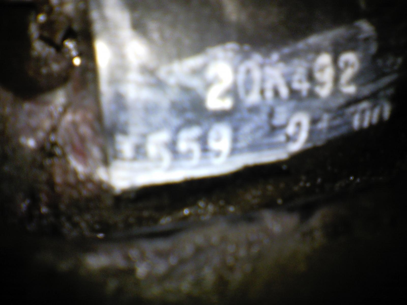

Pulling into a fuel stop & heard a loud "pop". After that, the steering wheel was 90 degrees off-center. Looked things over...tugged on every steering component and looked at the suspension...everything appeared to be OK....made a few phone calls and decided I'd just ease on up the road, deliver my load, and get it to a Mack dealer ASAP.
Well, ASAP was this morning after picking up my next load. At first, they thought it was the front left spring bushing, but when they pulled it apart to change it, the spring eye was broken off.
So, the 2QK492's are being replaced with 2QK494's. I figure if I'm buying new springs, I'm going to upgrade. $140 buys me an extra 3800# spring capacity on the steers. Either way, they had to be ordered...so no difference in down time. Hopefully now I'll quit bottoming them out...only clean spots on the truck are where the bump-stops contact the underside of the frame rails. Everyone seems to think it's going to be TOO much spring...especially for a day cab...but my old '86 Ranger had 4000# of spring on the ass end and 1250# coilovers in addition to the progressive rate coil springs up front.

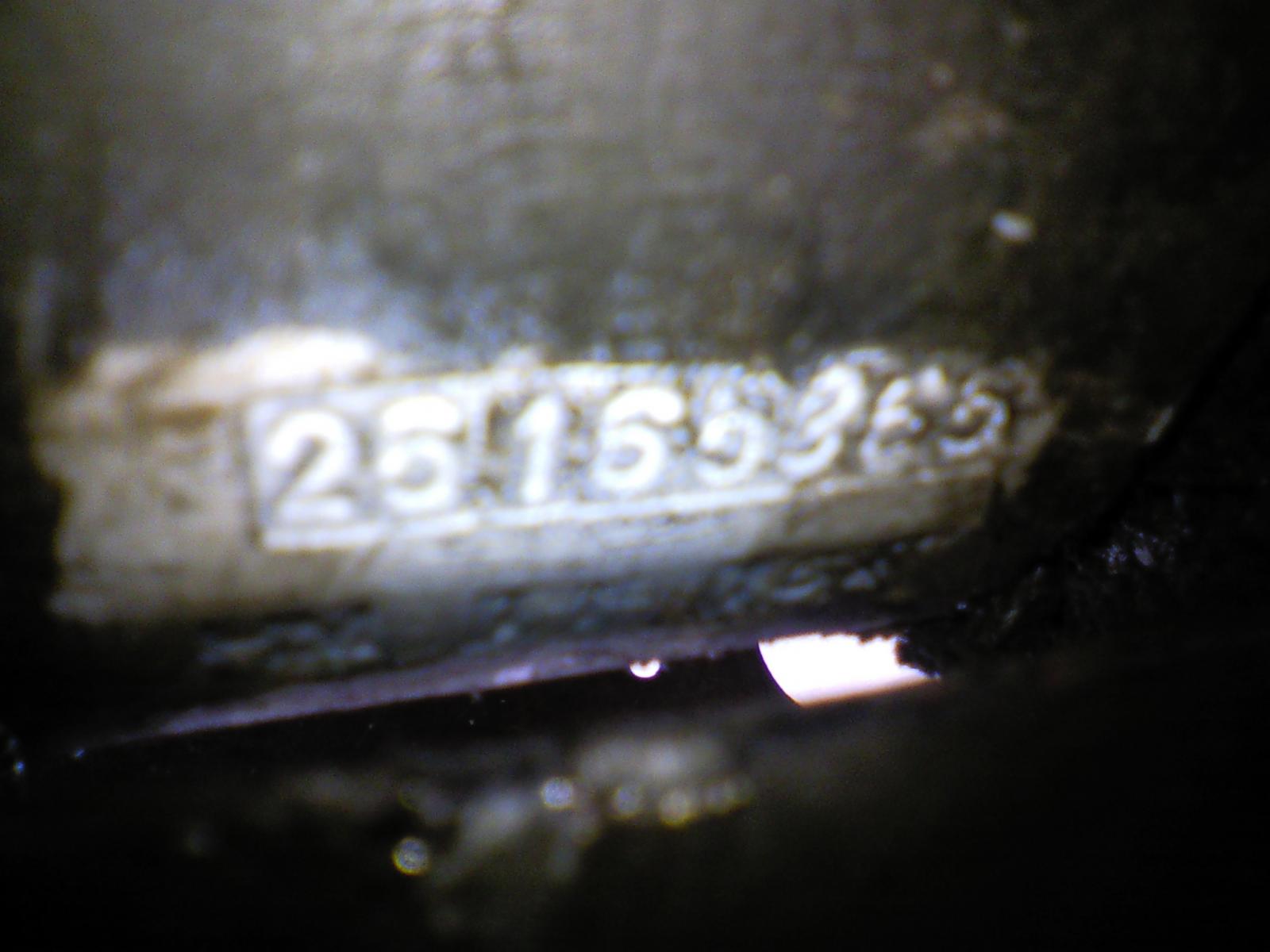

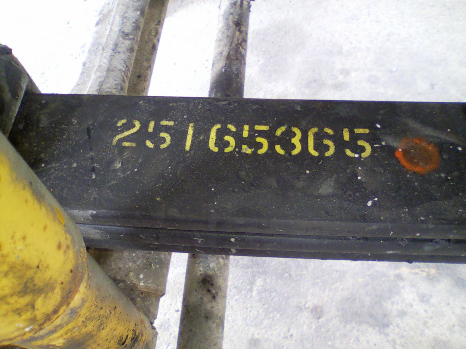

OK...so the new springs aren't the ones I thought they were going to be. New part number maybe?
2QK492 was the old spring that broke.
New one looks like 25165365, which isn't the 2QK494 that I was expecting...

The new part number could be a VOLVO thing. Slowly all the part numbers are switching over.

Yep, that's a world ID number.
As long as it is still the 8100# spring (16,200# pair) that I thought I was buying, I'm happy.
It definitely rides better....big dips don't bottom out the suspension anymore. I feel much better riding around at 75% of the suspension's rated capacity than at nearly 100%. Wouldn't mind upgrading the axle, too.....but haven't broke it....yet.... :whistling:
