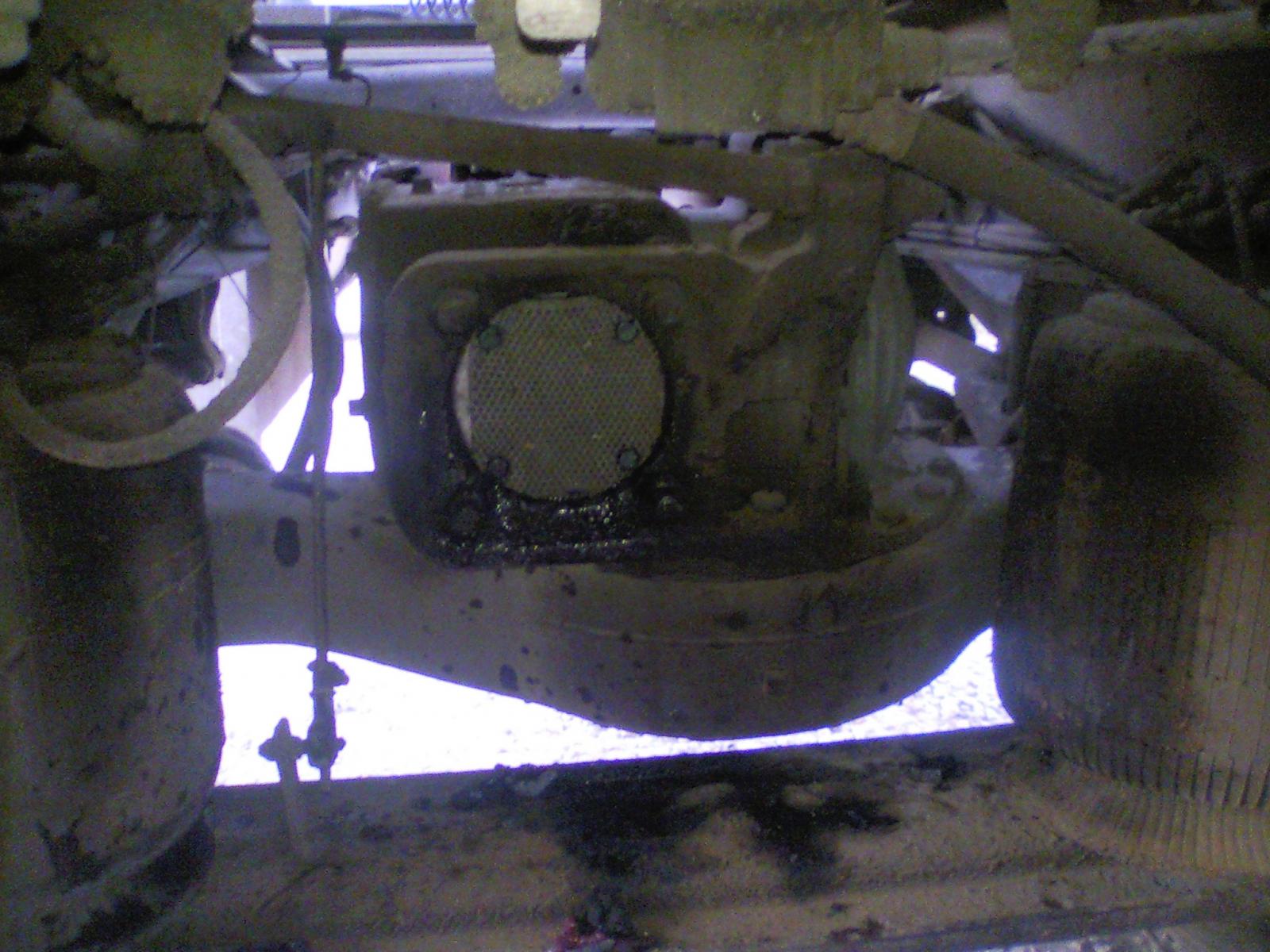

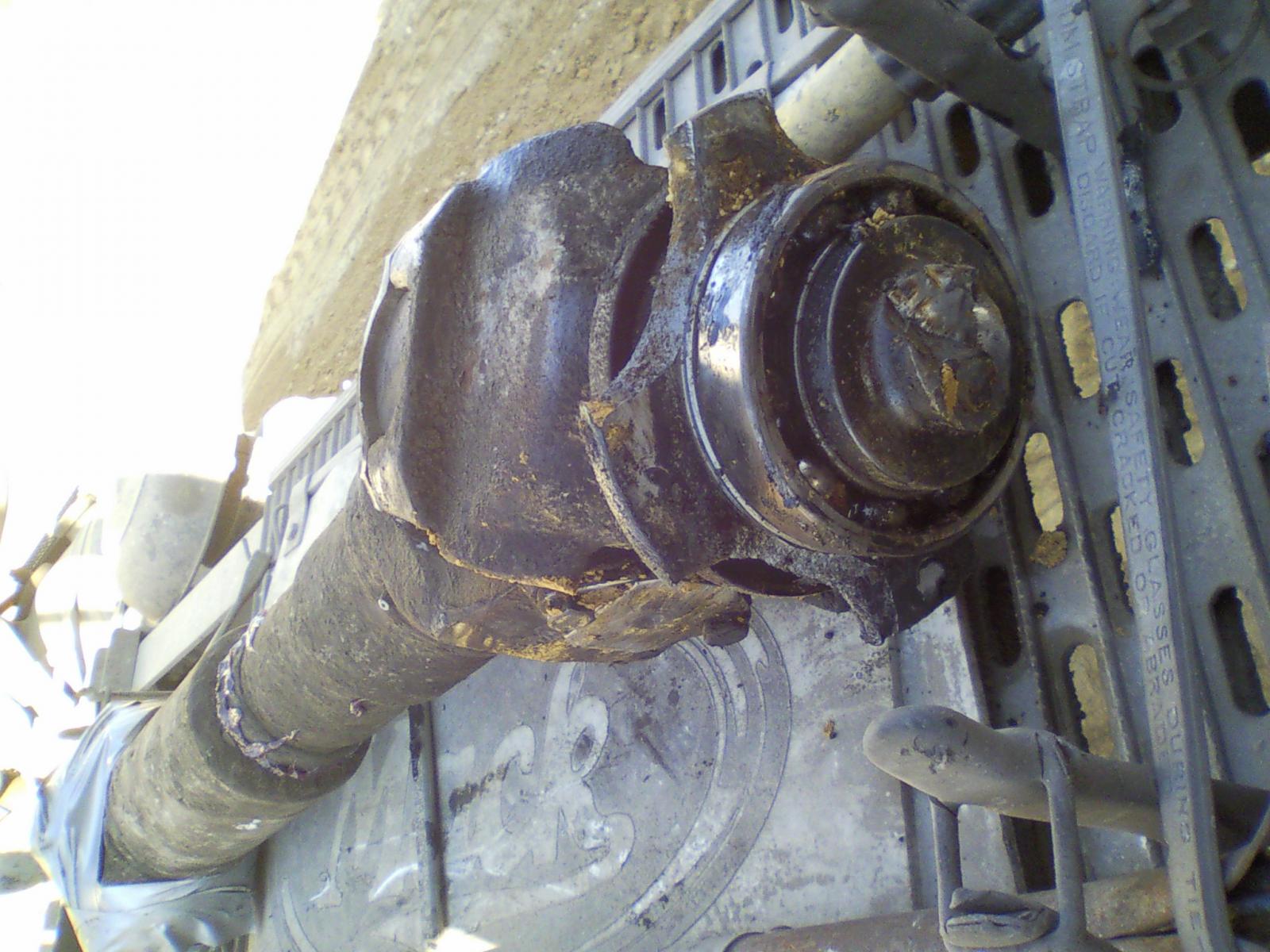

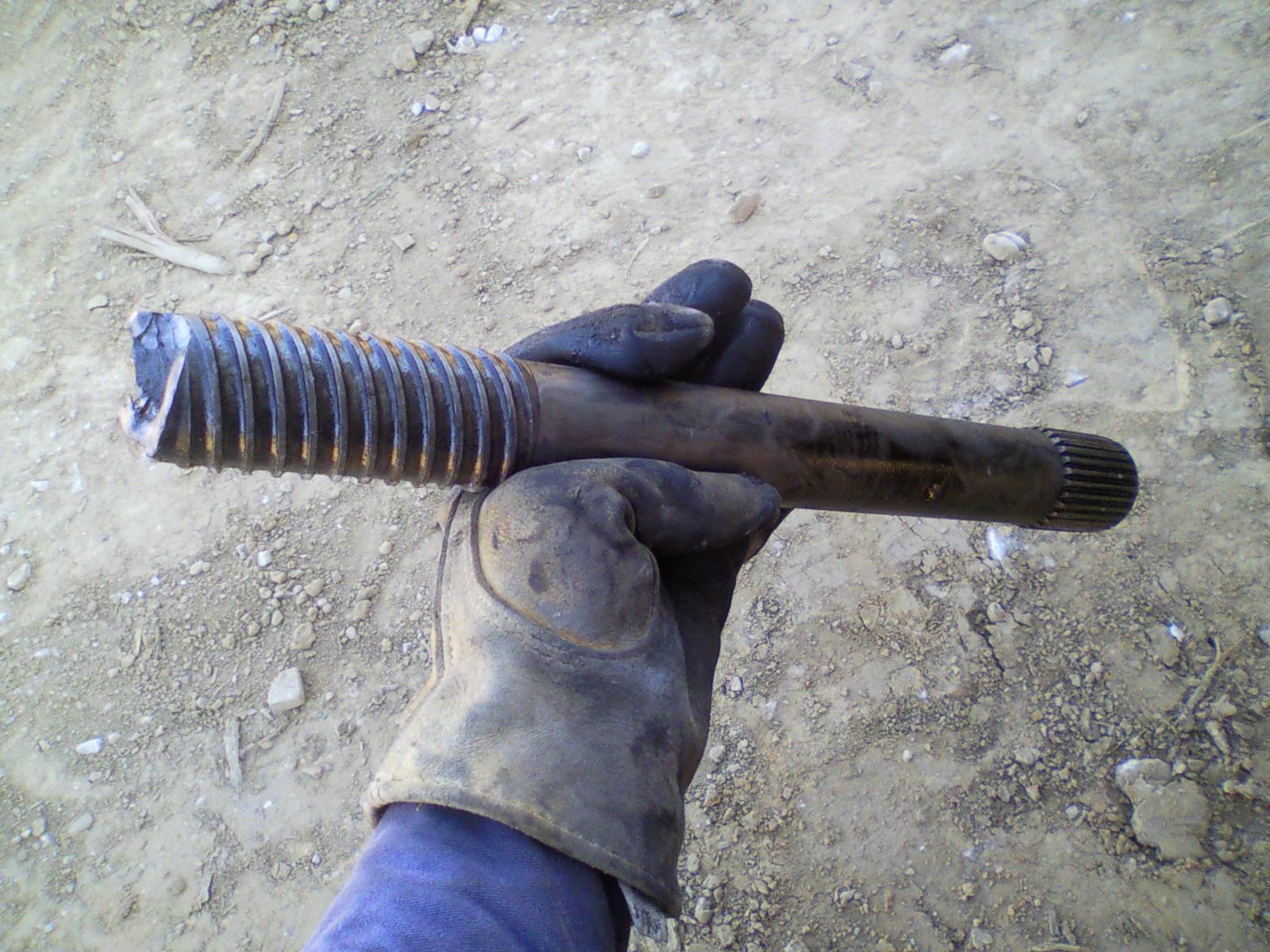

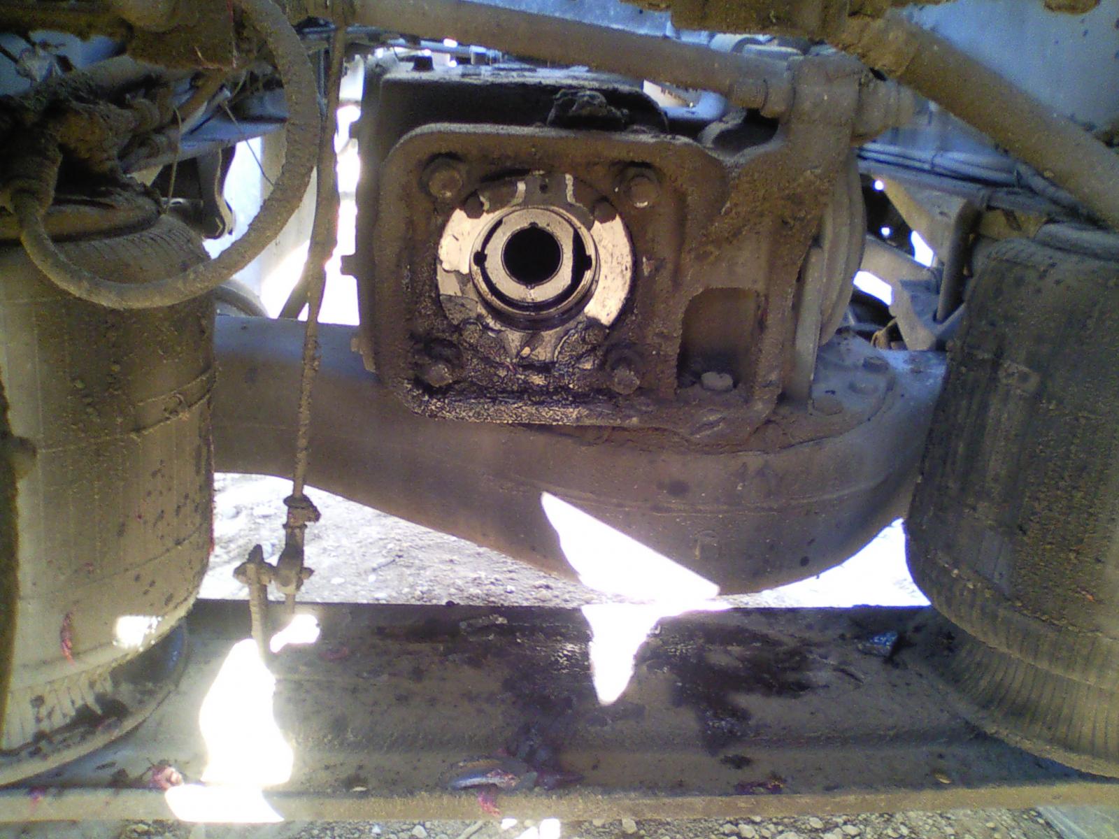

The broken piece is the output shaft on that front drive axle...that's the short shaft between the 2 drive axles on my catwalk. :unsure:
OUCH.
....said it when it happened....and I'll probably say it again when I get the repair bill. :o
Bet that went BANG!
Funny thing is, I had just pulled another O/O out....got his petercar stuck trying to turn around at the site I was SUPPOSED to unload at....then they decided they needed me up at this other site. Don't know why I didn't put the chain away....just put it on the floor between the seats instead of stowing it away in the side box where it belongs. When I broke? The chain was handy....but they needed a road grader to pull me up to where I was going to be unloading after I had removed the short shaft...wasn't another truck capable of pulling a broken Mack. Even then, when the grader would start spinning it's wheels, I'd lock in and slip it in low to help out...didn't want the CHAIN (3/8" G70) to break, too. Once unloaded, I stuffed a rag in the hole and locked in the power divider to get back out to the paved road....then since oil was obviously splashing out, I made a cover out of a piece of mud flap, but when I checked the oil level, I couldn't even touch the oil with my finger....bone friggin dry. Lost all the oil on my way back out to the paved road, had no clue how far it was to the nearest place to buy some gear oil, and wasn't about to burn up a $3000 carrier to save a couple hundred dollar tow....

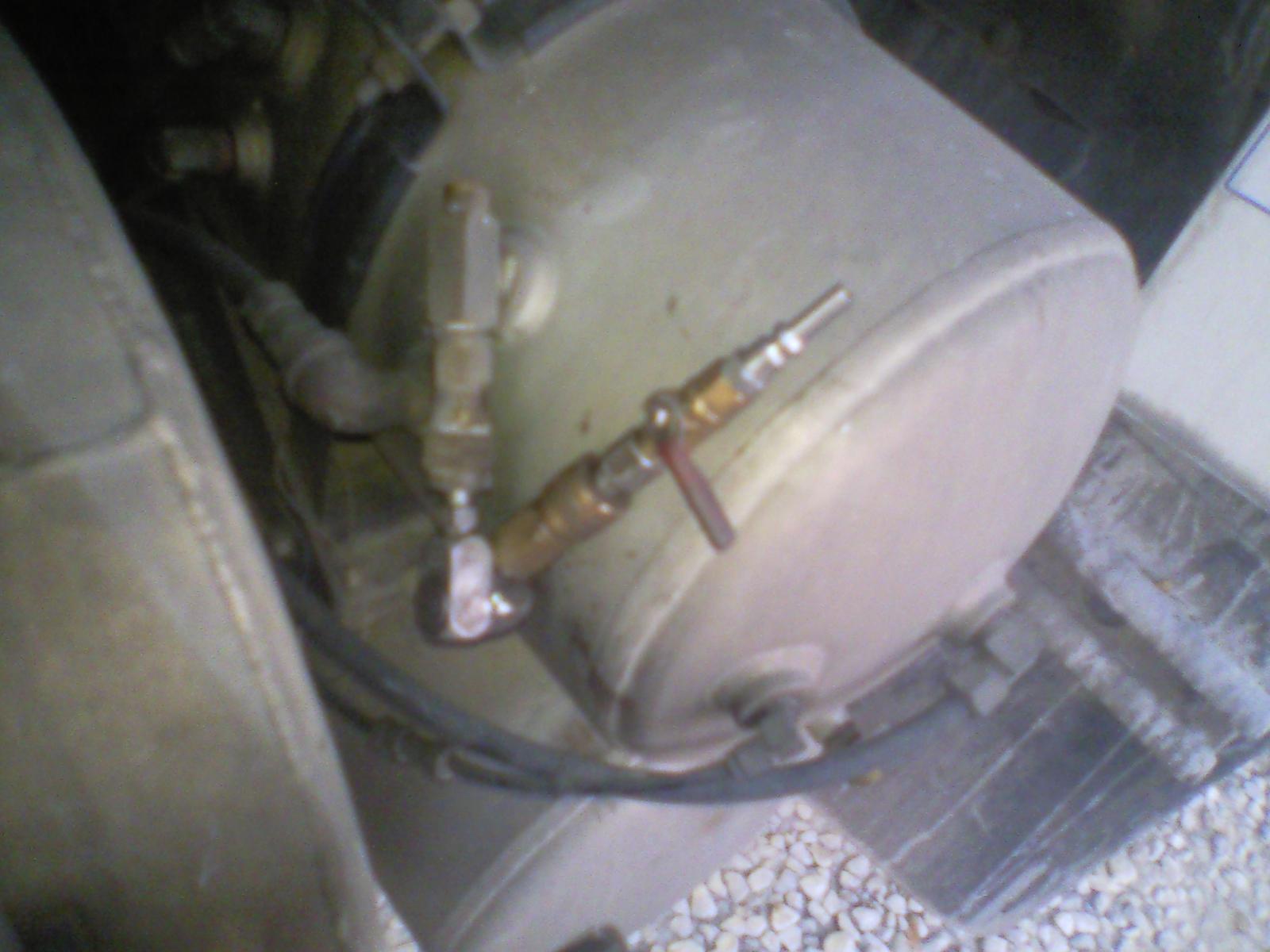

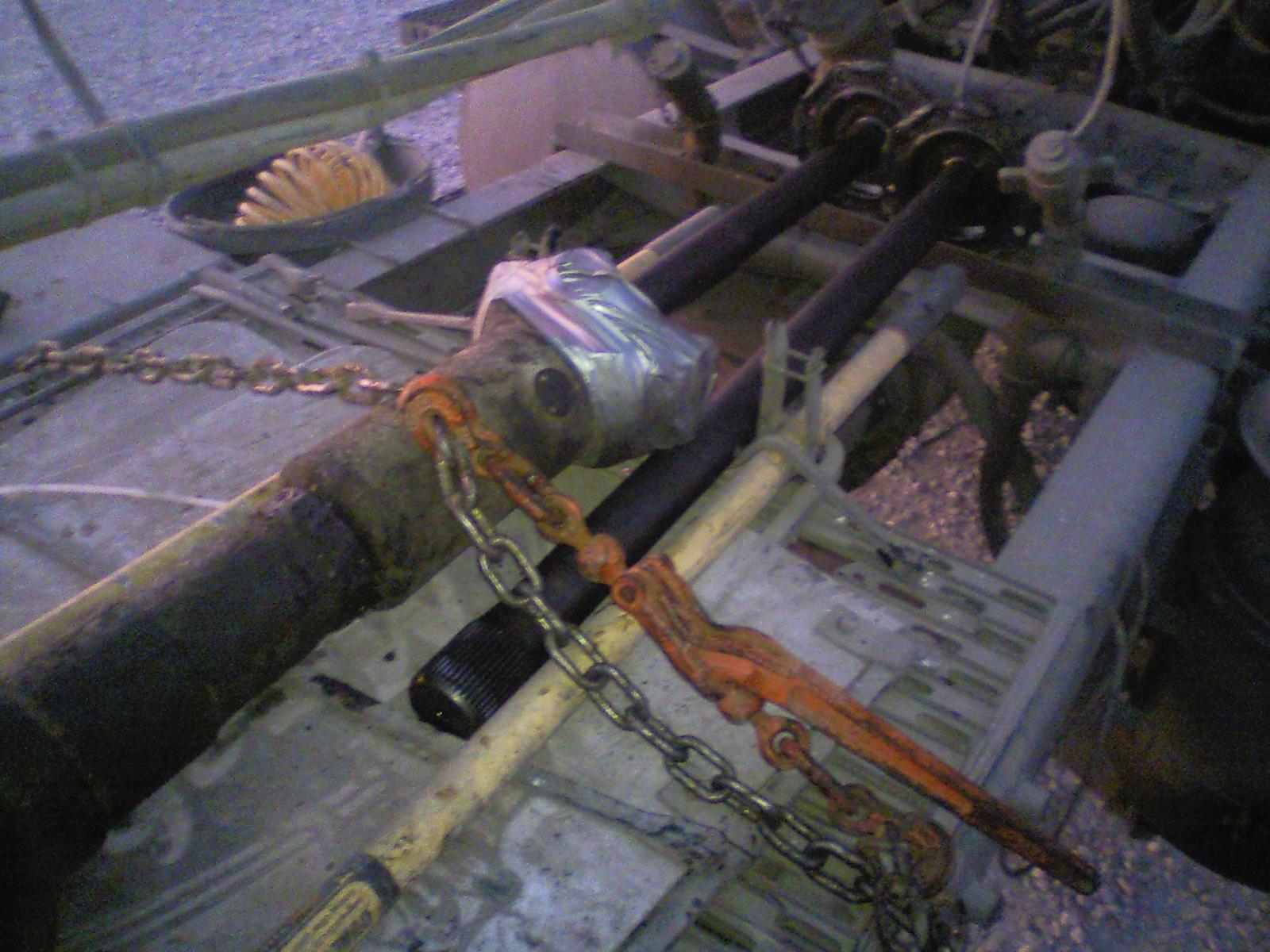

...So, I called for a hook. Then I made sure the truck was positioned nice & straight, where it would be easy to hook to, and easy to pull out with once it was on the hook, and then proceeded to prep the truck tow while I waited. Since the short shaft was already out, and I didn't want the carrier turning on the front axle (no oil) I pulled the axle shafts on the front drive axle & secured everything on the catwalk with a 1/4" chain & binder and a few 120 lb rated zip ties. Disconnected the blue line and electrical cord to the trailer and secured them out of the way, and then plugged in the air line valve and adapter (the place I called uses Lincoln type air fittings...I just use the standard ones) into my air tank by the time the wrecker showed up so that all I had to do was bolt on the axle hub covers he brought while he plugged his red line into my air tank, blue line & electrical to the trailer, and chained up the front axle. Probably the easiest tow he'd ever done...all the dirty work was done by the time he showed up.
I think I need to make some hub covers, though...the ones he had that fit were plastic, and the one leaked pretty bad. Good thing the differential had plenty of oil even if the carrier didn't.
