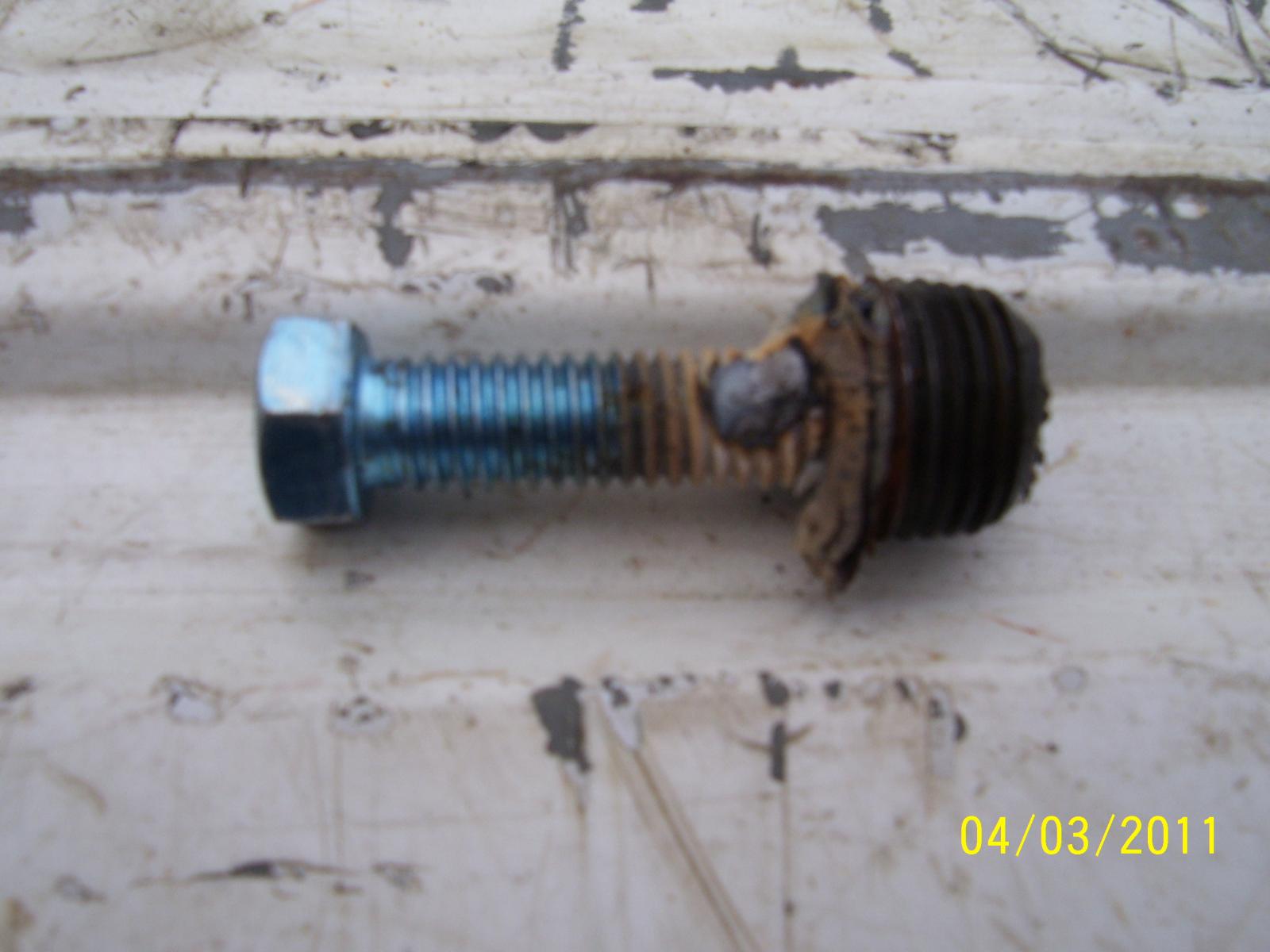

Come to think of it, I did weld a bolt onto a plug after stripping the dang hole out trying to remove it from the F250's rear axle....resealed the rear diff cover and then couldn't get the stupid plug out to add the gear oil! :blush: I was about to drill & use an easy out, but was reluctant because I had JUST resealed the cover...and would have to remove it to ensure there weren't any metal shavings inside. That's when I saw my welder sitting in the corner of the garage.
I prefer the plugs with the external square that you can put a wrench on rather than these stupid ones that have the internal square drive....
post-1673-0-73922000-1320515995_thumb.jp
