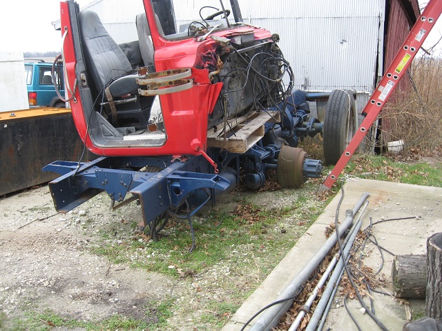

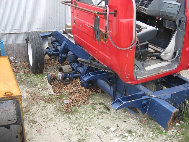

Well today was not a good day with the "Trusty, yet Crusty" old Dodge making the "ultimate sacrifice" keeping me safe and protecting my honor.
I spent most of the weekend trenching and laying new water line for a dear friend and when I was returning the trencher this morning, a C7500 series Chevy roadside service truck hit the Dodge backing up not seeing me setting behind. This truck was heavy including the Autocrane and full complement of service gear contained within. I was not hurt but the Dodge was hit squarely in the left front wheel collapsing the suspension, bending the frame and wheel etc. The front end was shoved over nearly 3.5 feet on the pavement. Comes out the driver never even checked his mirrors before backing up at a rapid pace.
I'm quite certain given the age, condition, and mileage the outcome is not going to be good. Many years I have placed my "trust in the crust" bringing old trucks home and I will certainly miss this ole girl.
Gotta meet with their insurance adjuster tomorrow morning so this should be entertaining......

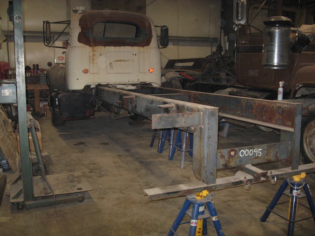

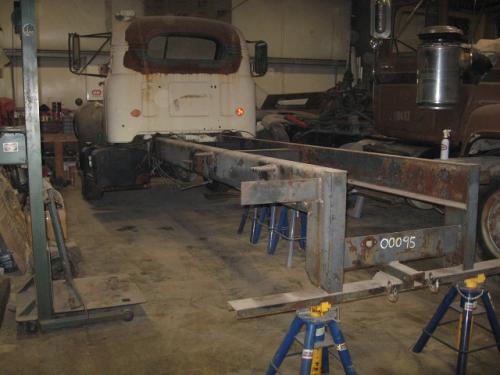

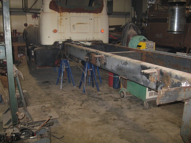

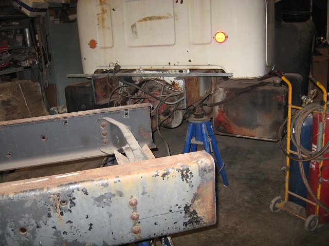

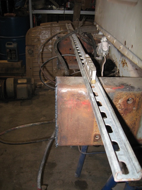

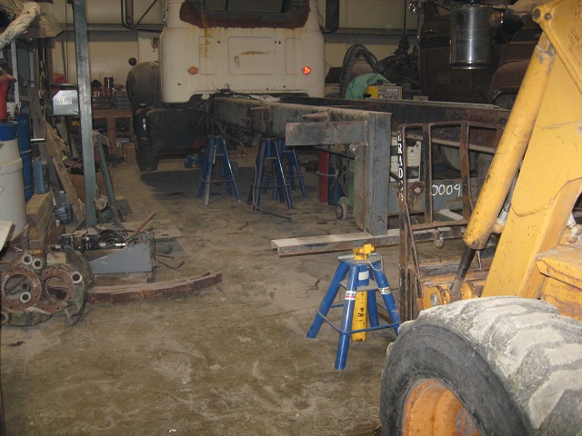

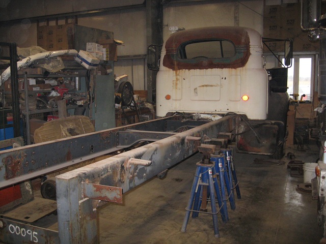

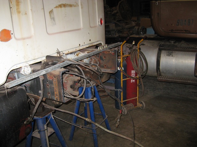

Well, dragged the ole B61 out of the corner after unburying it to park in this spot. The photos show the truck staged, then on stands and leveled ready to be cut in half. Also have attached a shot of the air ride that will be grafted onto the frame stubs. This cutoff has burnt out front differential and I'm only using the rear. I have new bags, bushing kit, drums, and adjustment shims for setting the driveline angle once she is put together. As mentioned earlier I dropped the driveline off at the shop and just need to tell them what length I need. This should be a slip fit over the existing stub(s) and I'll allow about a 12" overlap of the frames which will be welded solid on the inside and outer surfaces. I'm thinking this should go pretty smooth.
I'll probably drive this one around for a while on the original engine which runs well. It will have 3.70 gears, brand new 10.00RX22 radial tires, and a double over triplex trans. It may not even want to pull itself but I'd like to get a few miles on it before changing to something with more power. This truck hasn't been driven since 1992 when the original "Unishift" transmission exploded itself which is how I purchased it in 1994. It hasn't been outside the building since early 2005.

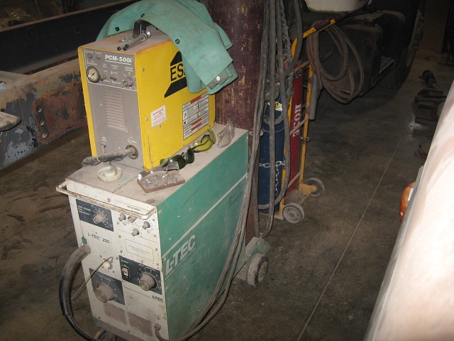

I Like you L-Tec machine! I have a giant Linde 400 amp ACDC unit in Houston, just needs a circuit board (runs wide open)!
I was really partial to Linde, L-Tec, Esab, (same company) until the representing dealer which was locally owned sold out to corporate structure. No more personal service as the old time employees were forced out and the prices immediately went up, and discounts went down.
I purchased that welder new in 89, the plasma in 96. Both have been 100% trouble free and have many hours upon them. I'm looking at a new tig machine but will probably go with Miller, or Lincoln. I tend to like Lincoln cause when you call them direct, they talk to you in a "No Shit" type conversation. Most of the technical support I've dealt with at Lincoln actually know their products.
