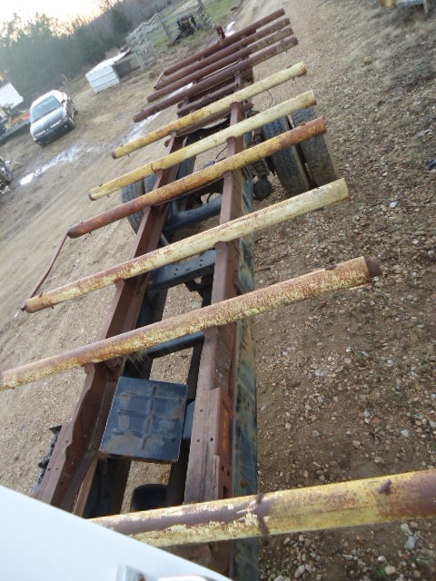

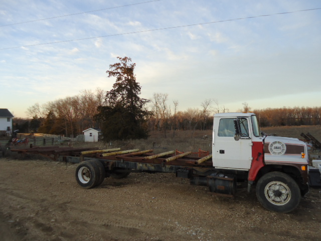

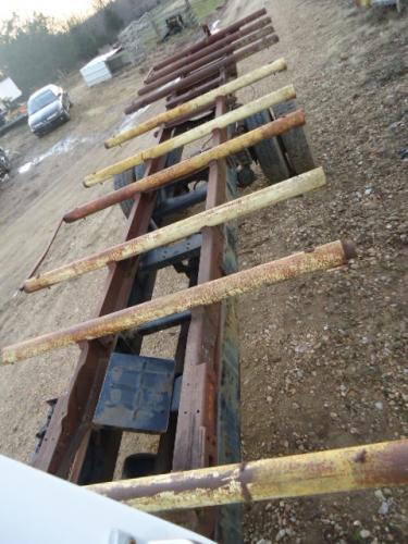

We put together a hay haulin' truck for moving hay around here. I made it out of a mix of goodies from some scrap Ford trucks.
The truck was a wrecked 1997 8000 Ford. The front axle, front clip, and other front goodies are off a 70's Ford 900 and a 95 Ford 8000. The engine is a 8.3 cummins that I had stored in case I ever needed it for my crane truck. I thought I might as well use it and keep it limbered up.
The bed is 30 feet long and we have been hauling 18 big bales on it that are around 1700 pounds each (I know, I can do the math, yes-sir-ree we are overloaded on the rear axle).
Now that we like it so well, I am thinking of making one that is longer as I have been putting up some hay further away from home. I want to stick with a straight truck as the fields we go into in the summer are way off road and my sons drive it so I don't want to use trailers that somehow they figure out how to jacknife in the middle of a flat field sometimes.
My question is: What is the longest I can legally make a straight truck? I plan to use a tandem axle R model Mack tractor stretched out for the next one.
