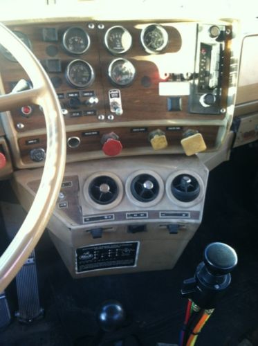

Anybody got one of these heater covers?
I'd like to make a mould to reproduce these. I'll either purchase one, or just borrow it if available.

I have one. NOS (Really is NOS)
Is this one for air conditioning? Mind if I borrow it? I'd spray it with a release, front and back, and make a two piece mould to cast others. I've not been able to locate one for months.

My guess is 12sp with low on the second stick.
That is correct. The "selectair" knob in this truck is a replacement from PAI.

I'll pull it out this week when I get back.
I've got a broken one already out of a truck,would that work for a mold?I'm positive there are no pieces missing..
As long as there are no pieces missing it would be easy. Two of my trucks use this same cover and they are missing large pieces. The originals became very brittle with age. I can prolly repair mine, but it's not difficult to make the mould boxes, and then new ones once the setup is perfected.
If you don't mind get them over to me as the originals won't be damaged. Hopefully many can benefit in the end.

The new one I have is sitting on a shelf in a srorage trailer.
That would be great. I don't need the bezels, switches, lables or anything, just the bare plastic part. If there are any side panels available that would be good to include also as I'm missing one side but cannot remember which.
I've done this type of thing in the past but with smaller parts. The originals were injection moulded where I will resin cast replacements.
